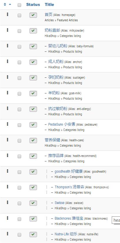

After I updated my hikashop business, problems began to appear, I fixed some but have more.
1.The main menus have no products linked unless you change link type to from category listing to product listing. It was fine before updating.

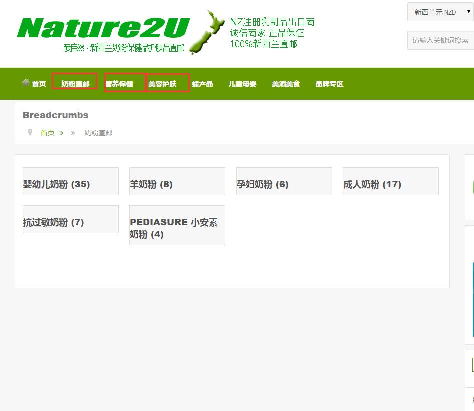

1. The menu you clicked was changed to product listing so it displayed fine, but if you try other menus, you will find the problems, ex the attachment.
2.The problem doesn't produce at the moment, it need some luck. I meet sometimes, when you click search, it comes to the category listing page.

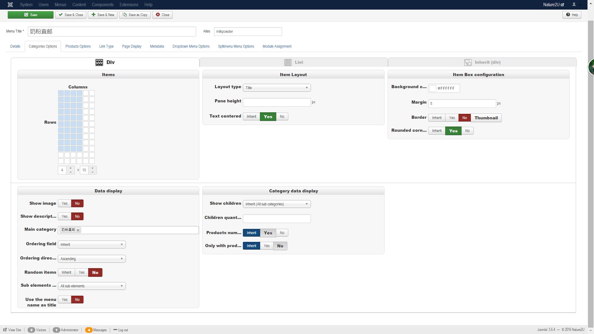

Then, please provide screenshots of the settings of the menu item
Part of the message is hidden for the guests. Please log in or register to see it.
Something must be wrong with them.

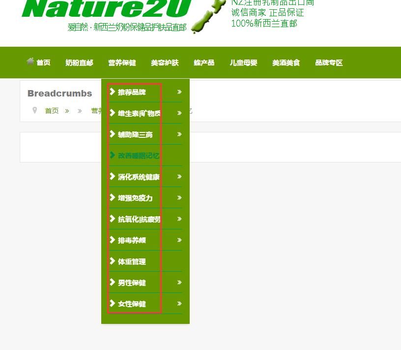

Hi, the menu you clicked is wired. Most of the menus don't work, the main menu and most sub menus don't show products. You will find the problem if you do another click.

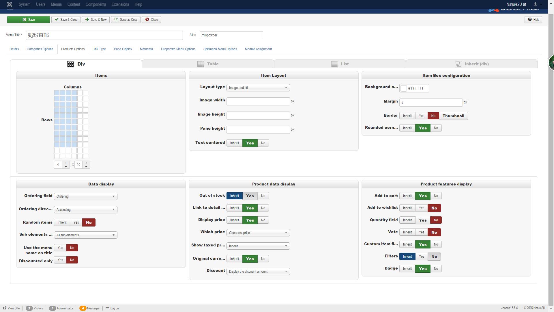

9 years 10 months ago #254494

The way you configured the menu item, (with the sub element filter set to "all sub elements" instead of "direct sub elements", you should even see the products below the categories listing on that link.
So I can only think that there is a problem with your template.
Please try to switch to the default template of Joomla temporarily. If it works, it means that the problem is with the template and you could try renaming the file templates/YOUR_TEMPLATE/html/com_hikashop/category/listing.php via FTP.
