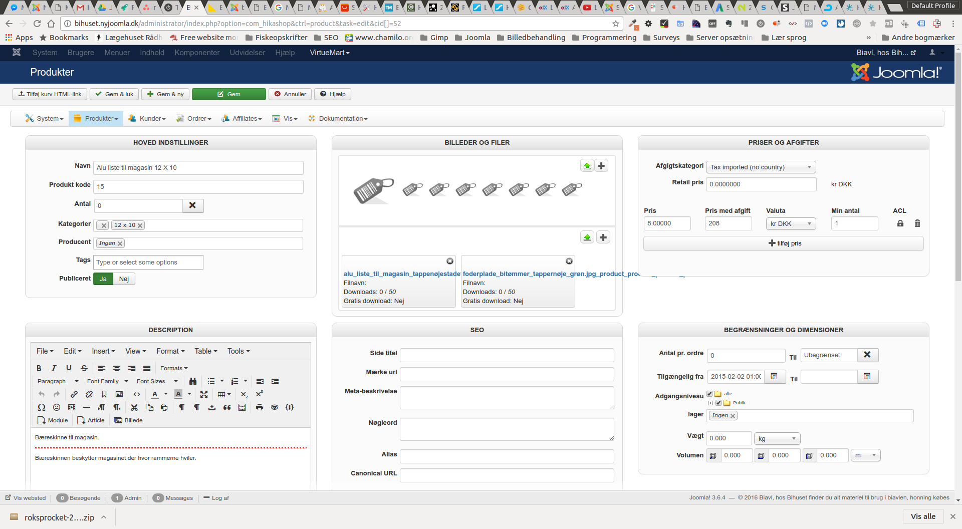

Hello
I am working on a website where i want all content from VirtueMart to Hikashop
But when i use the option to get images with the products, i fails.
What do i do wrong?

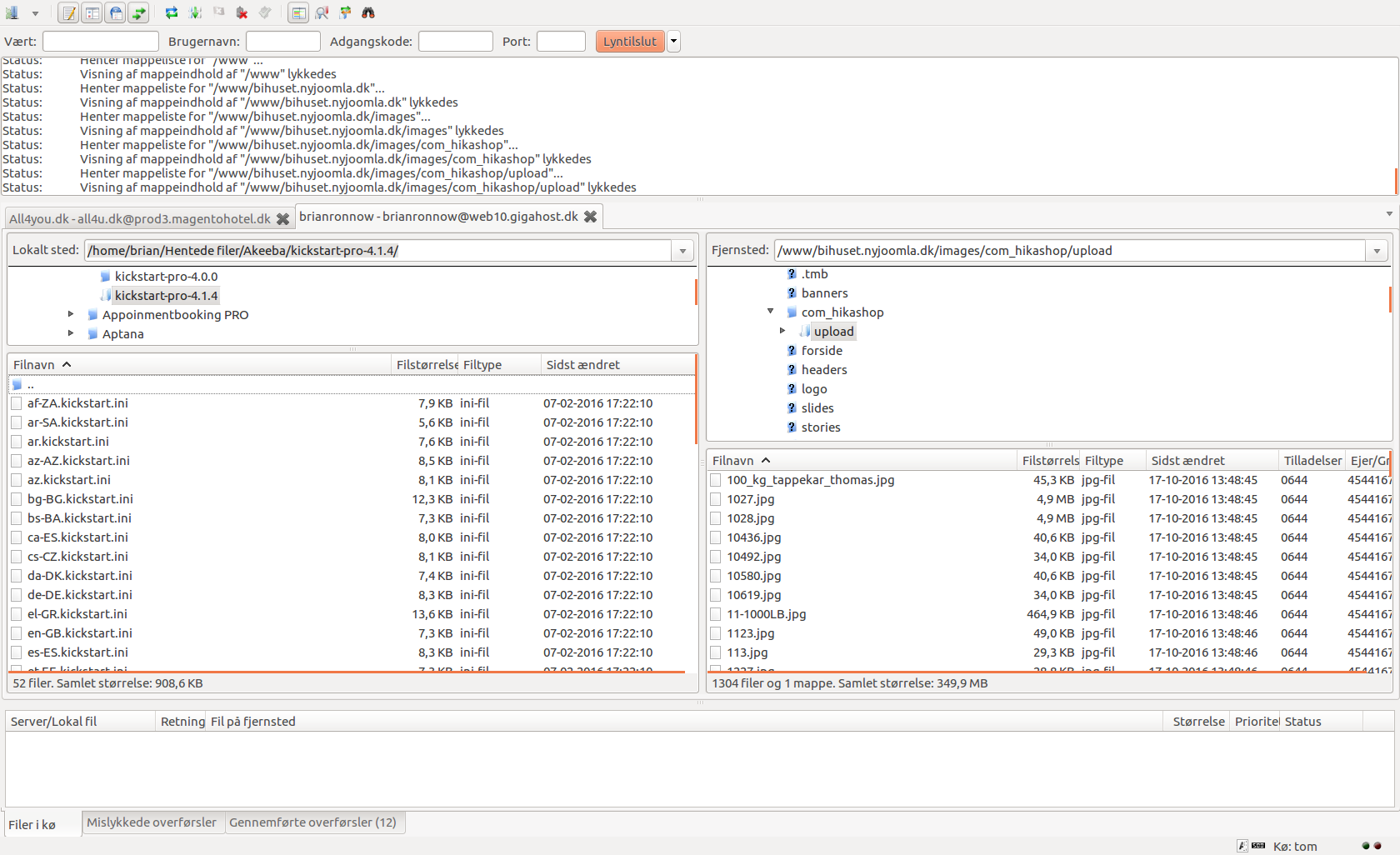

The images are in the folder ?

Yes it is the same size in the images that is in the VirtueMart image folder as in com_hikashop/upload folder.

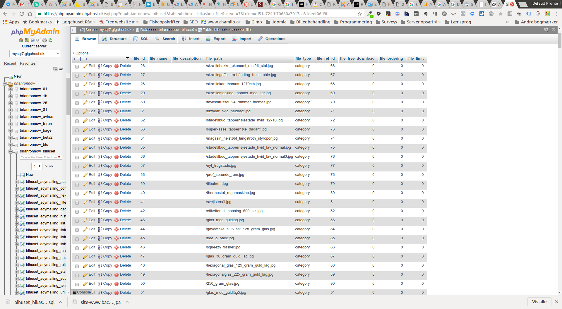

Its how it look likes in the database.

These are images of the categories as you can see in the "file_type" column. Do you also have them for the products ? And are they correct ? Can you verify with one or two that their file_path correspond to the file name of the file in the HikaShop upload folder and make sure that the folder you're looking at correspond to the folder path you set in the "upload folder" setting of the HikaShop configuration and that this folder and its sub folders are writable for the user of your apache.
One of these points must be wrong.
