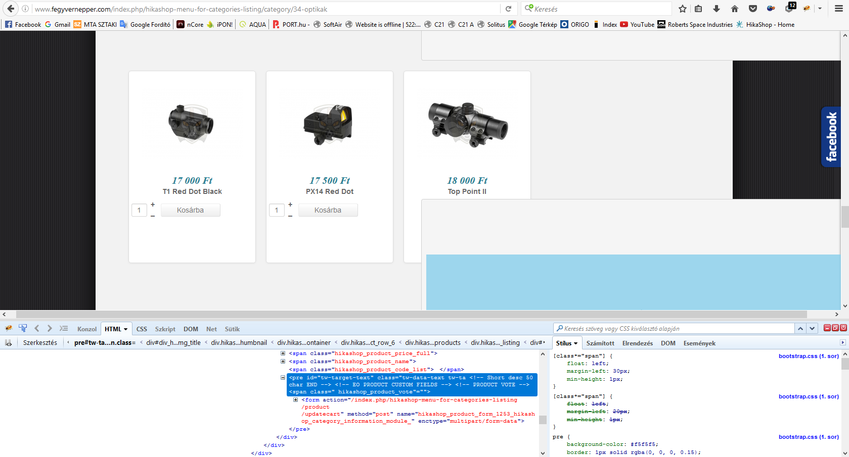

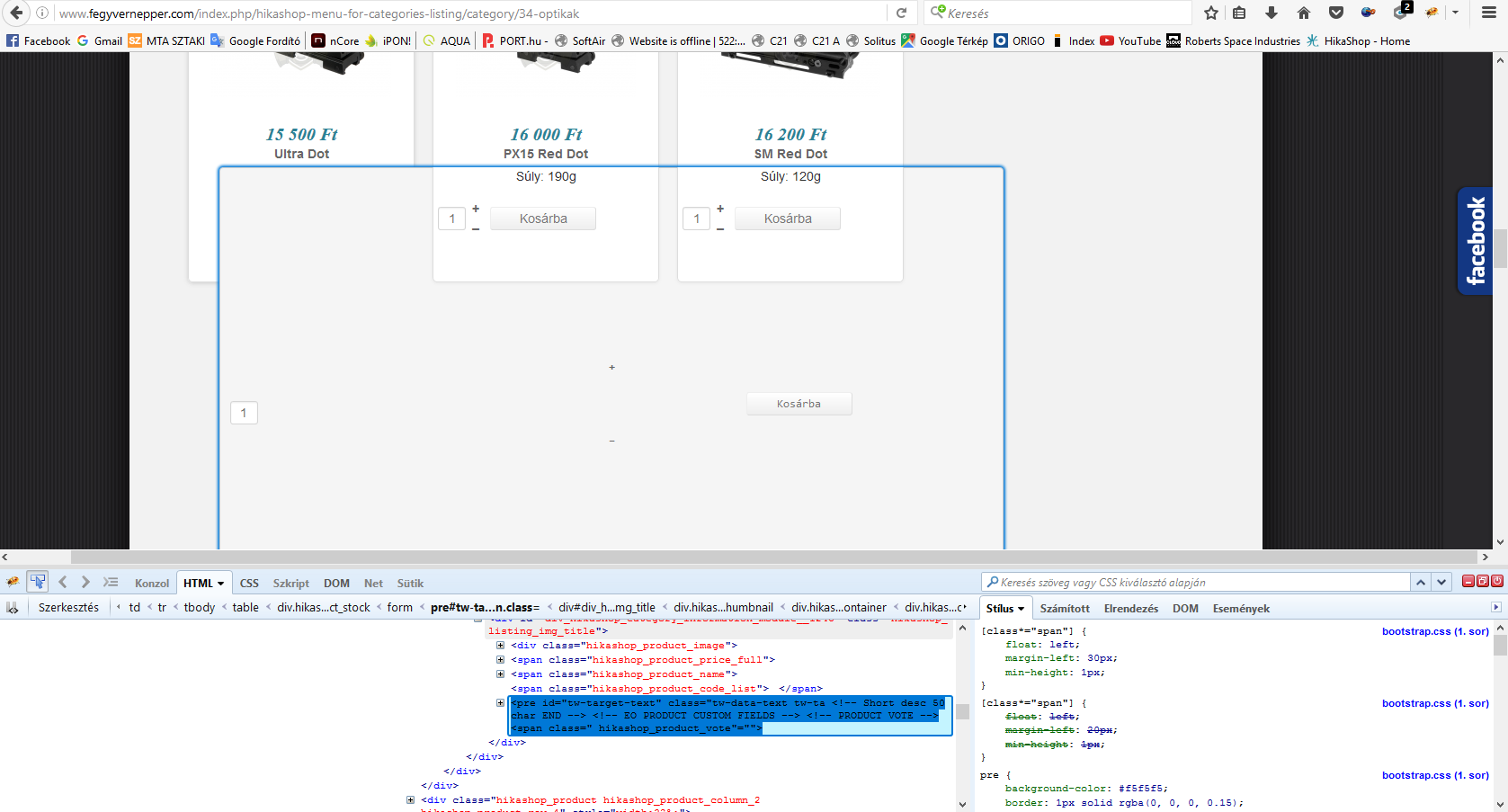

Today I upload many product in a category, and on the frontend I saw the picture what I attached and I don't know what I made wrong.
The bootstrap.css belongs to the Joomla template, but before this I never saw this problem and never happaned this.

9 years 10 months ago #254874
I found the problem. The problem was the 50 char description, I disabled it.
