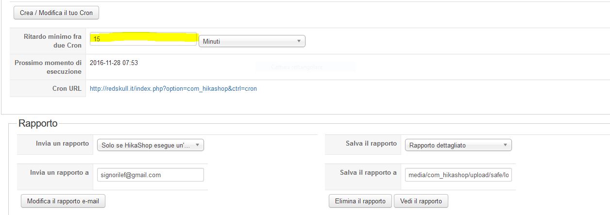

  • Posts: 281
9 years 9 months ago #256223
Hello
I think there is still something wrong, couse I changed the setting how you sayd (every minute) but every day there is a late that encrase about 15 minutes and sometimes more.
what wrong??
I wonder if it is possible makes start the cron when a user visit the web site??
What can i check ??
Frank
  • Posts: 86106
  • Thank you received: 14206
9 years 9 months ago #256229
You need to change both the frequency setting under the cron task tab of the HikaShop configuration (which limit the frequency the cron task system of HikaShop will run so that even if someone calls your cron task URL every second, it will only be triggered when necessary and won't crash your server), and the frequency of the cron task trigger in your hosting cpanel.
If we would make the cron start when a user visit the web site, then the cron tasks wouldn't be regular like you can have them with the current system.
  • Posts: 281
9 years 9 months ago #256258
Just to be sure, I have to change the setting in cron cofiguration of hikashop too, and change 15 with 1 in the screen shot below.
Correct?
FRank
Last edit: 9 years 7 months ago by francota.
  • Posts: 86106
9 years 9 months ago #256275
That's right.
