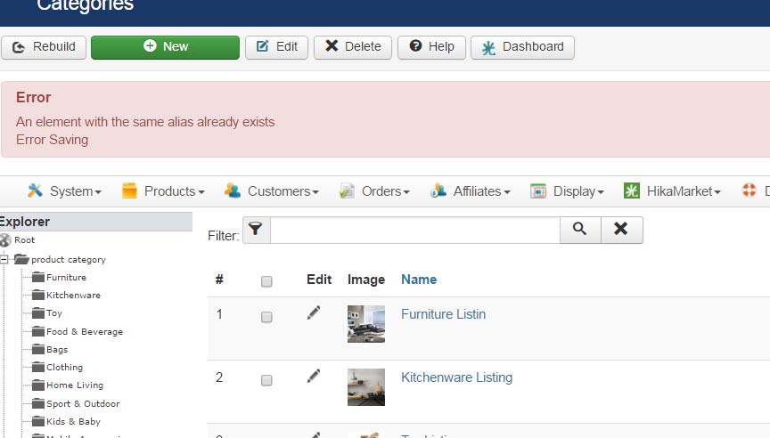

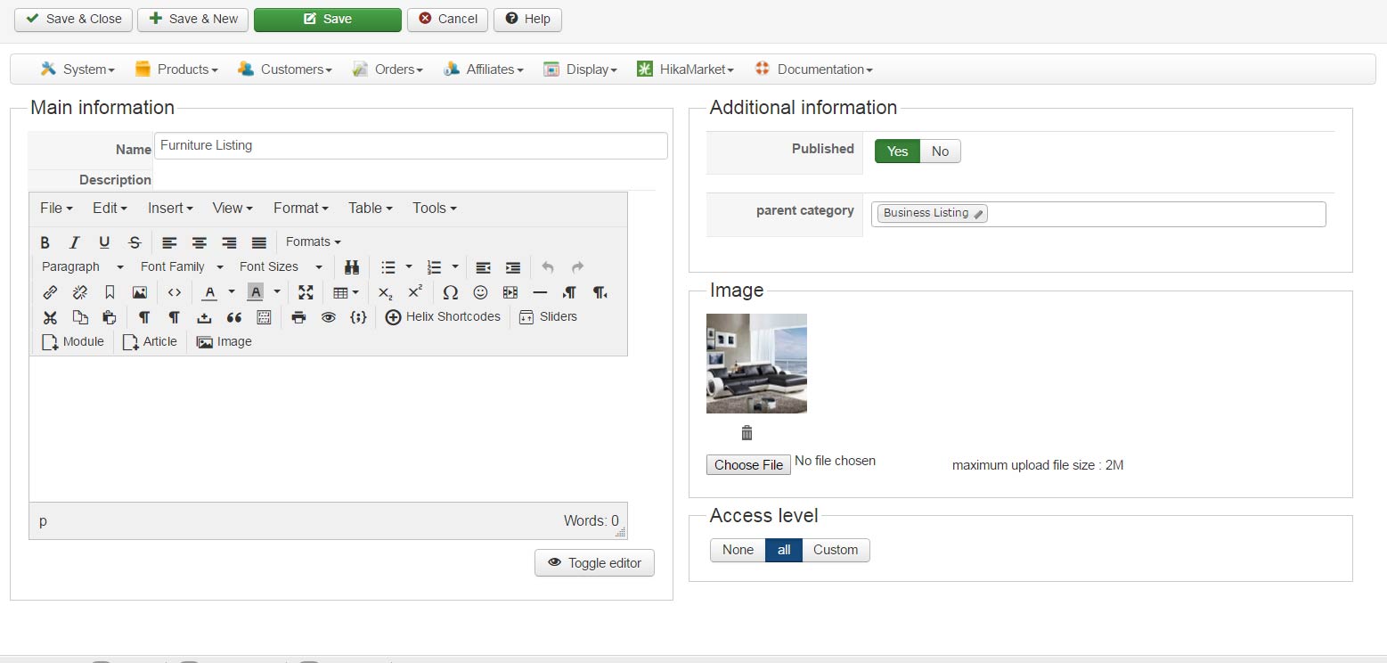

  • Posts: 79
9 years 7 months ago #259398
hi , thanks for the reply.
but as you can see in attached screenshot, there is no field for me to fill up alias when i create categories? but if i create a category with a category name that oledi exist, error message in the image shows up.
or there is something i missed up on alias part?
  • Posts: 86106
  • Thank you received: 14207
9 years 7 months ago #259423
Here is the default interface when you edit a category in HikaShop:
take.ms/tgpBB
You can see it on our demo website:
demo.hikashop.com/administrator/index.ph...tegory&task=edit&cid []=12
As you can see, there is an alias field in the interface.
So that means that the type of your category is neither a "brand" not a "product category" but a tax category or an order status, or an unknown category type. So you must have been messing with the categories at some point which lead to that problem.
Change the line:
if(!empty($element->category_alias)) {
to:
if(!empty($element->category_alias) && (empty($element->category_type) || in_array($element->category_type,array('product','manufacturer')))) {
in the file administrator/components/com_hikashop/classes/category.php so that the check is really only done when needed and that will prevent you from seeing the error.
However, the category type of your category will still be wrong so you might have issues in the frontend when using it.
I would recommend to go in your PHPMyAdmin and check that the category correctly has the value "product" in the column "category_type" in the table hikashop_category.
