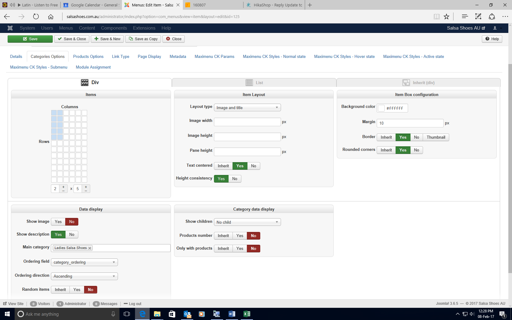

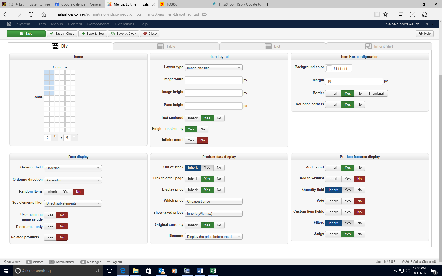

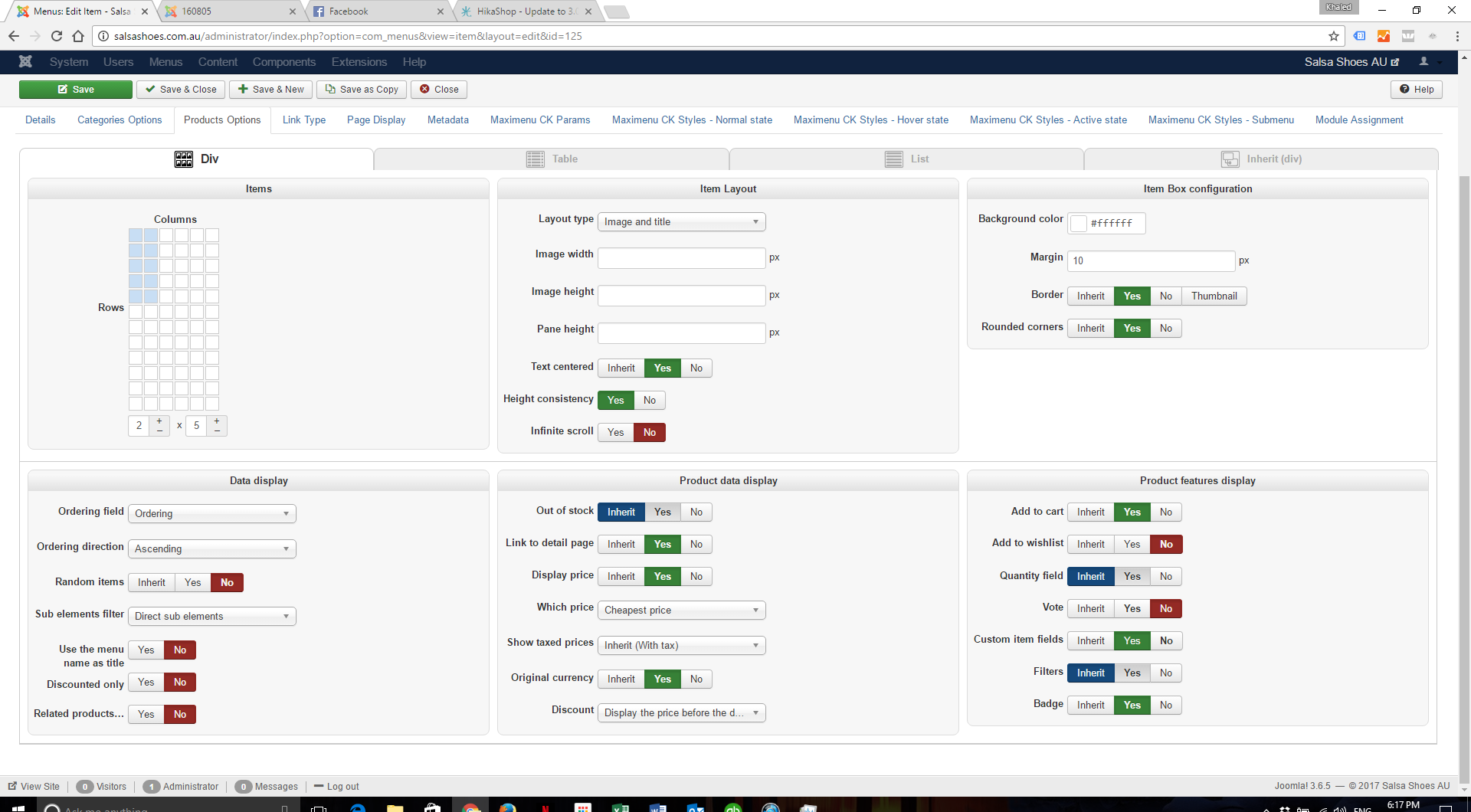

I have just installed the latest version of HikaShop Business. Also, took some snapsots for the following category:
www.salsashoes.com.au/ladies-shoes/salsa-latin.html
Please let me know if you require more info.
  • Posts: 26384
9 years 7 months ago #261745
Thanks for the details.
So your "shoes" are using "item custom fields" and these fields are not required (sizeladiesau, heelladieslatin)
And in your product listing, you configured the product listing to not display the "custom field fields".
Because these fields are not required, they are "optional" ; it means that HikaShop (and the customer) have the right to add the product with the default value of the fields.
You can either :
- Make the custom item field required.
- Display the item fields in the listing.
By making the field requires, you will get a "choose options" instead of a "add to cart" in your product listings.
Because a required field is not visible in the listing, the customer cannot add the product like that, he need to select a value and the default value is not authorized.
By displaying the custom item field in the listing, the customer would still have the "add to cart" but will be able to choose the value he wants directly.

  • Posts: 177
  • Thank you received: 4
9 years 7 months ago #261763
Thank you for your reply and suggestions. As shown in attachment I have changed the "Custom Item Field" to "Yes" however I am failing to understand where to change the second option you suggested: "Display the item fields in the listing". Could you please give a more detailed instruction?
9 years 7 months ago #261783
You'll be able to change the "Display the item fields in the listing" option of your custom field through its configuration page via "Hikashop->Display->Custom fields" by using the "Front-end Listing" option.
