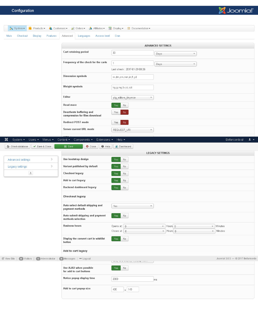

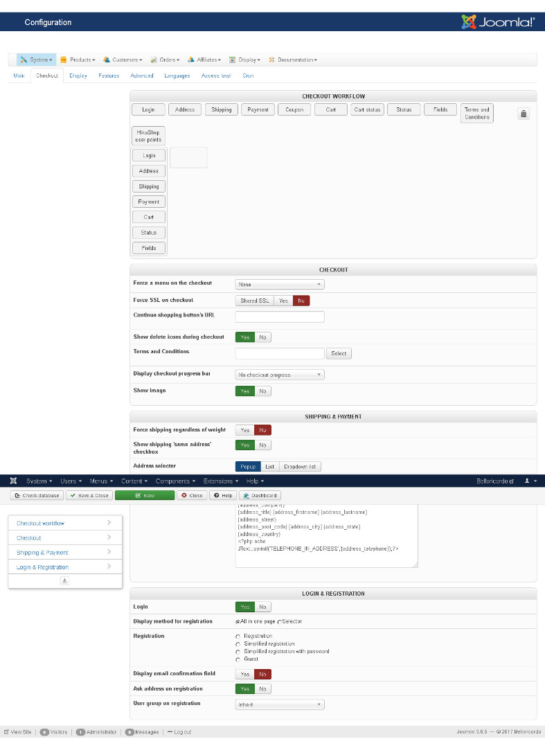

So please provide details about your current HikaShop configuration.
- Checkout > Login & registration
- Advanced > Legacy
  • Posts: 259
  • Thank you received: 22
9 years 7 months ago #260813
Hi Jerome, As requested, see attached
