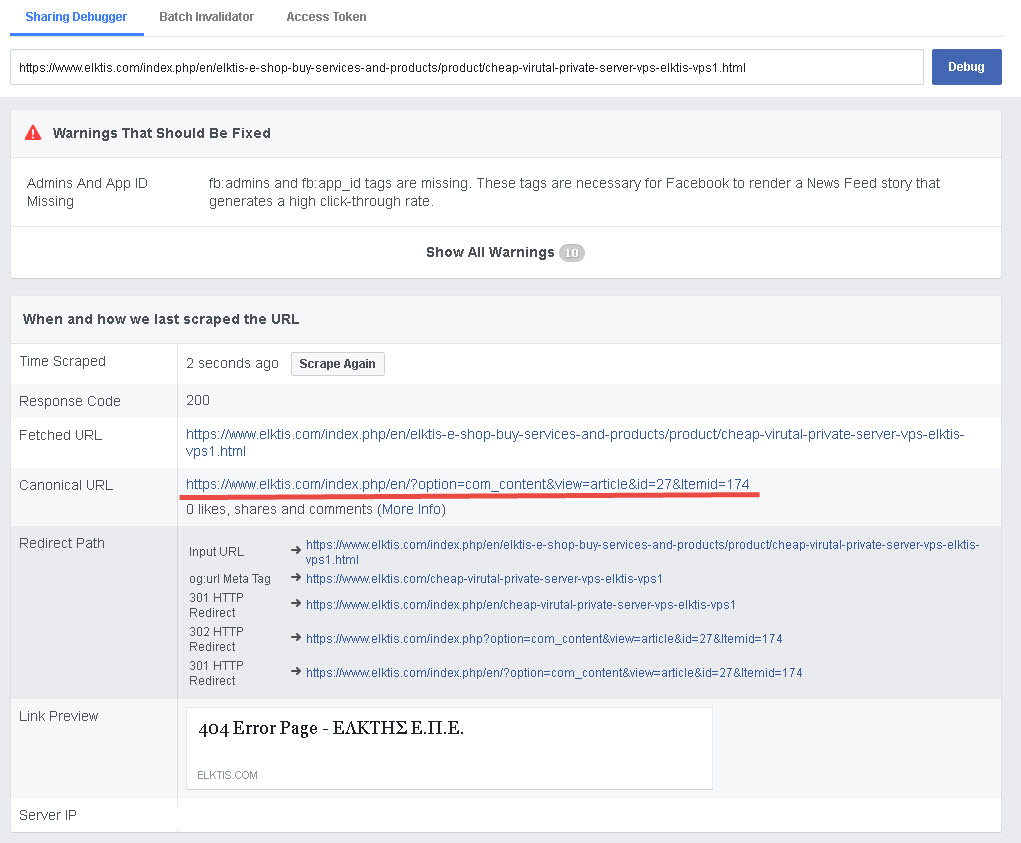

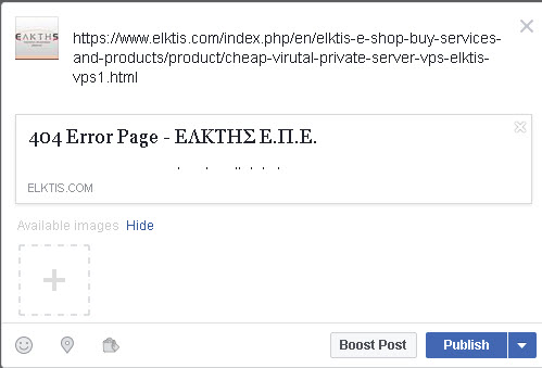

Yesterday, when i want to first post a product on facebook page, i saw a strange happened !
I saw that in facebook, no image or something that normally displays as you post a correct link normally, but facebook returns an 404 error.
As i hit the 404 error link i go correct to the page i post. No error. Error is only on the facebook link parser. I don't know why.
Check also this link:
www.elktis.com/index.php/en/elktis-e-sho...vps-elktis-vps1.html
this is a link of one product.
So in facebook, displays the problem 404 page.
and also in the scrapper i fount this.

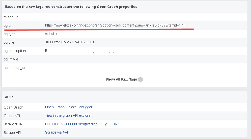

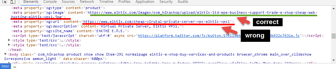

  • Posts: 14
9 years 7 months ago #260740
Also , as i check i see here the wrong line..
but i don't know how to correct it
all the facebook details are correct , except the og url.
  • Posts: 14
9 years 7 months ago #260786
FINALLY,
If you delete the "canonical URL" field, facebook scraper working correct .
THE MAIN PROBLEM IS THAT YOU CANNOT DELETE THE "CANONICAL URL" FIELD, ONLY TO EDIT !!!
THIS HAS TO DO ONLY WITH FALANG. FALANG SHOULD MAKE A CORRECTION UPDATE.
WE CAN DELETE IT ONLY THROUGH SQL.
SO PROBLEM SOLVED !
