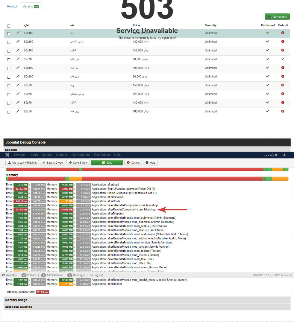

When i updating from 2.6.4 to 3 version when save the Variant getting the attached error.
503
Service Unavailable
The server is temporarily busy, try again later

  • Posts: 6
9 years 7 months ago #261371
error attached
  • Posts: 26384
9 years 7 months ago #261372
I am sorry but it does not indicate an error.
We just see that a page is processing by HikaShop but nothing is showing that there is an error or a problem.
So there is no related "error message" to that 503 page.
Please check your PHP error log.
