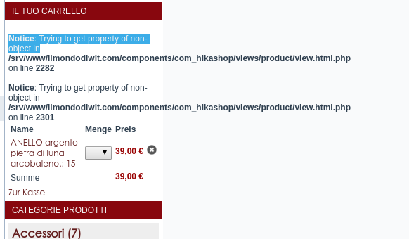

-- Error-message(debug-mod must be tuned on) -- : Notice: Trying to get property of non-object in
After updating to version 3.0.0 i get Notice: Trying to get property of non-object in in the cart module
please give advice
thanks in advance

Can you please provide the context when that message is displayed exactly ?
The warning indicates that there is no "hikashop_cart" module loaded by Joomla and the "module_id" parameter is not related to a valid module.
Afterwards, it is just a notice, so there is nothing problematic because such kind of PHP notice should not be displayed in a website in production.

9 years 6 months ago #262535
it appears when you add a product to the cart. You can try it by yourself www.ilmondodiwit.com/shop/gioielli.html

9 years 6 months ago #262536
Solved. It was due to multilanguage and the module was signed only for one language. i added the modules for other languages and now it works. Thanks
