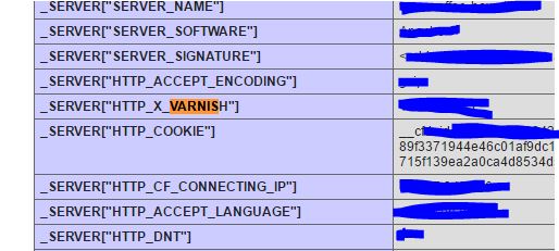

I'm not sure if we have varnish. See the attached screenshot. Any thoughts?

No, I always meant to say that having Varnish could be the problem.
Your screenshot www.hikashop.com/media/kunena/attachments/48086/varnish.JPG seems to indicate that you do have Varnish on your hosting.
Which is why I recommended to either deactivate it or install the integration with Joomla in order to prevent that problem.
