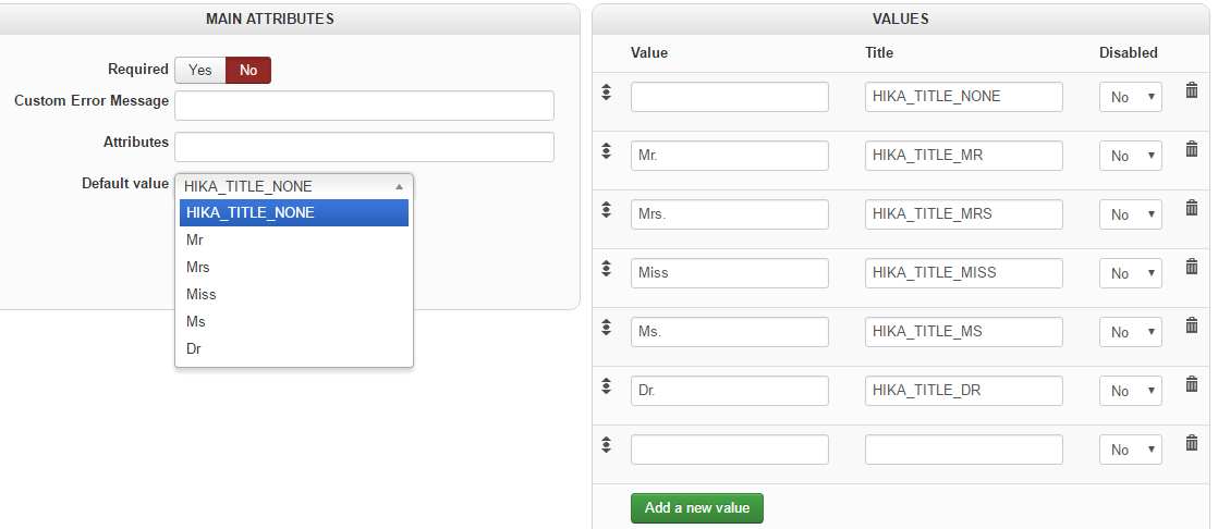

Please try to no use an empty value but the title HIKA_TITLE_NONE.

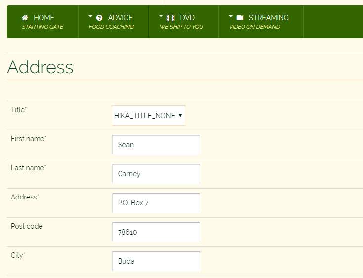

I had also tried that yesterday. What displays on the front end now is that title as the first option. I have attached an image.
Do you know if I need to edit a document somewhere to make HIKA_TITLE_NONE display a blank option?
Also, can you tell me why the system seems unable to display the proper Titles with the periods in them as we are accustomed to in the USA. Here is the formatting I am expecting:
Mr.
Mrs.
Miss
Ms.
Dr.
etc...
Here is what my backend configuration looks like now:

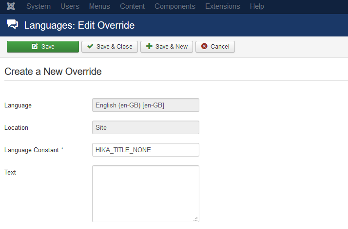

I think you should go to joomla language override and add translation there. Just keep it blank or enter whatever text you need and it should work.
Hope that helps.
  • Posts: 190
9 years 6 months ago #264683
That worked. I now have a blank option at the top of my list.
