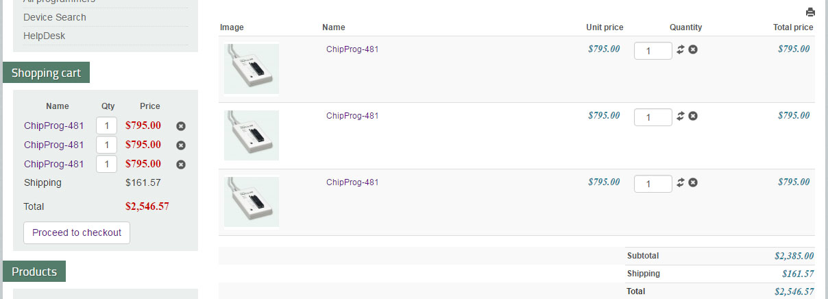

2) When adding the same product several times, they come into the shopping cart as separate products instead of product quantity being updated (it also worked in v2). It looks weird, see the pic 1.

2. & 3. We don't have that on our end. Is it for all the products ? Could you provide a link to a page where we can look at the issue ?
