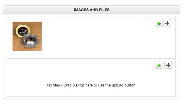

can't remove picture in backend product page
  • Posts: 122
9 years 4 months ago #267726
-- Joomla version -- : 3.6.5
-- PHP version -- : 7.1
-- Error-message(debug-mod must be tuned on) -- : no

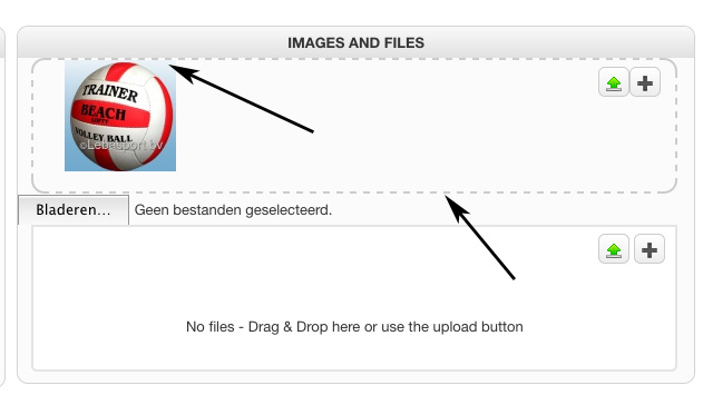

After a update on to v3.0.1_2017_04_18_18_18_29_44.zip The image div looks different with a stippled line around. Problem is that I can't remove the picture in the div.
see image of Hikashop v 3.01. before and update (every month) like is advised!
imag after update with piles.
best regards, Marius

Please re-download HikaShop 3.0.1 in order to have the full patch.
During a small period, an uncompleted patch was present in the packages.

Yes that works perfect!
thank you Jerome

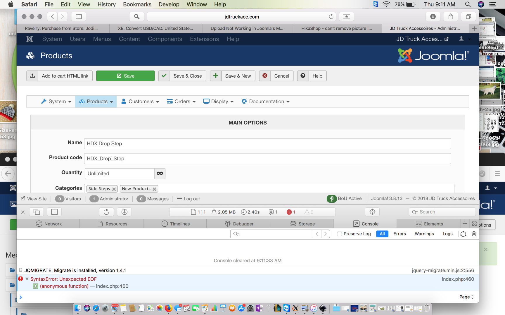

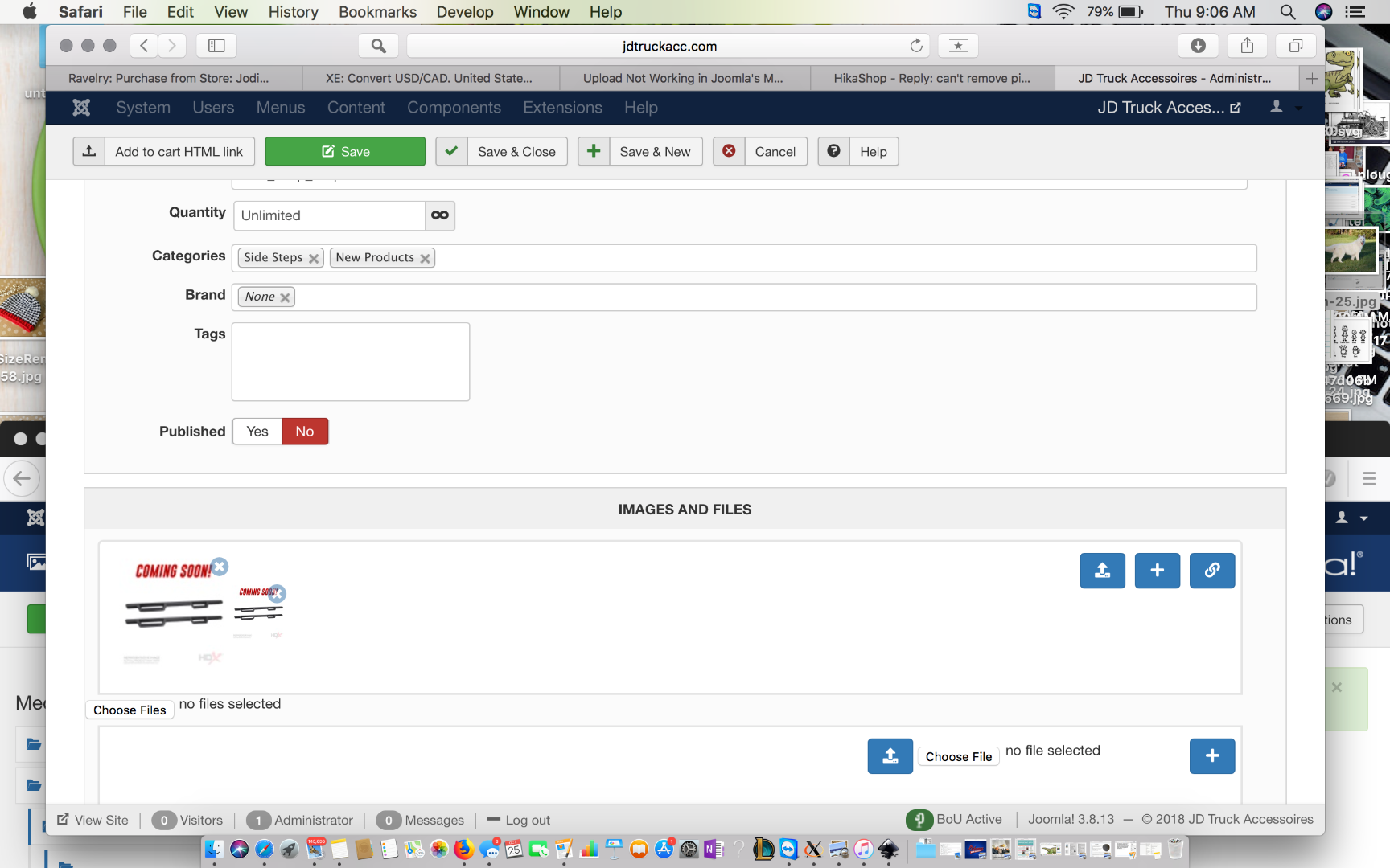

  • Posts: 16
7 years 10 months ago #299632
HikaShop Starter 4.0.0 [1810241141] and latest version of joomla
there is no response when I click on the x for the photos or any of the buttons to add new photos, I've checked for errors and found the one below
not sure what could be missing or if I have a setting wrong.
Thanks for any help you can give
Last edit: 7 years 10 months ago by sarahshaw. Reason: to add error

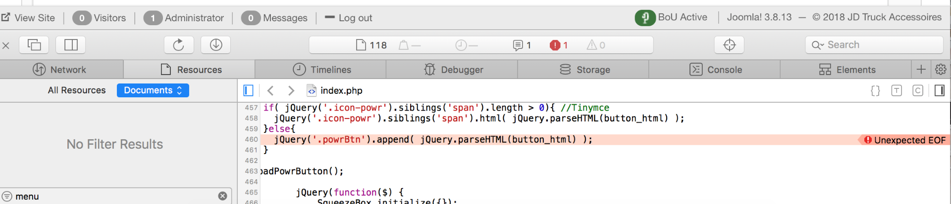

7 years 10 months ago #299634
Your issue is probably coming from your JavaScript error, so can you show us the code that you have through the "index.php" file near the line 460.
Kind regards,
Mohamed Thelji.

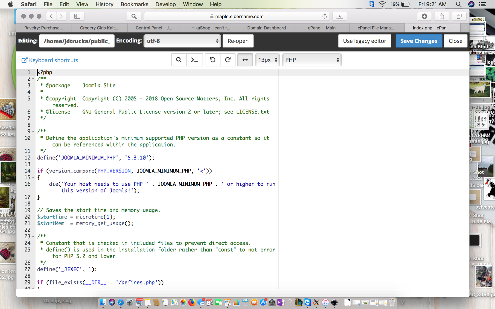

  • Posts: 16
7 years 10 months ago #299692

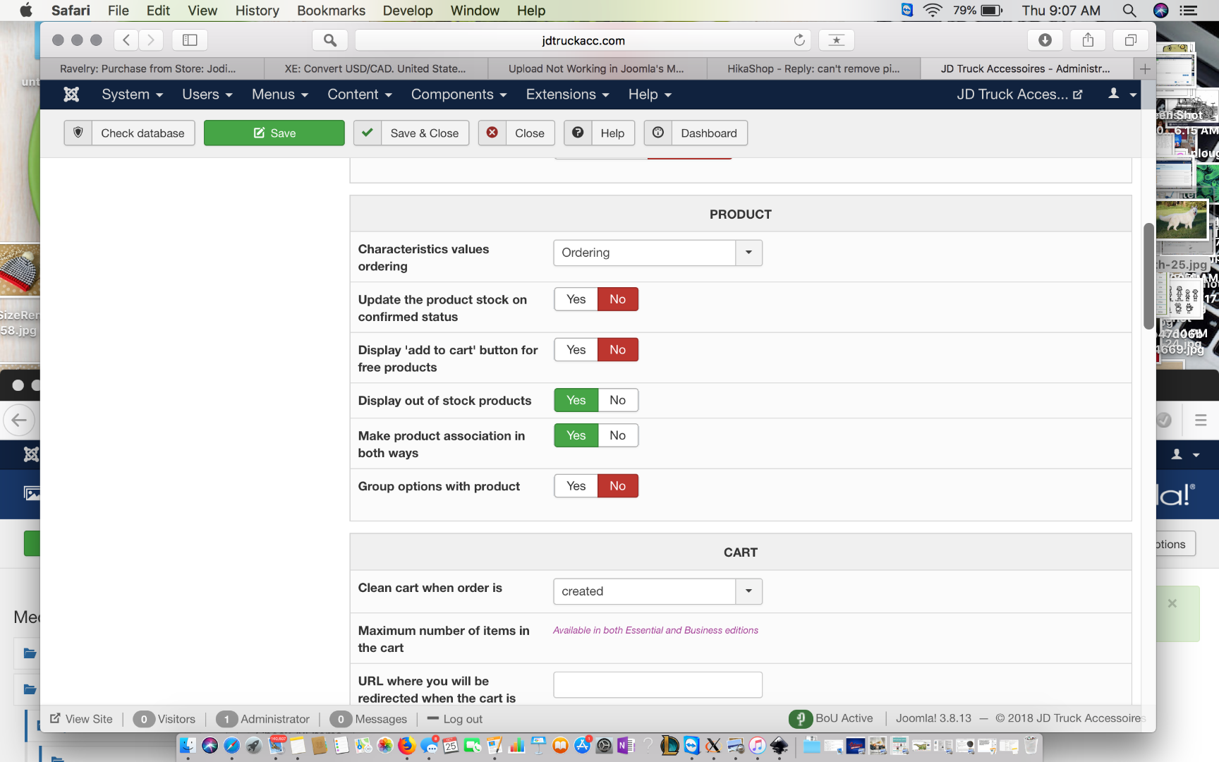

Thank you. I cannot locate line 460 in my index file here is a screen shot of my index file code
  • Posts: 86112
  • Thank you received: 14209
7 years 10 months ago #299694
No, you need to look at the HTML code of the page with your browser :
www.lifewire.com/view-html-source-in-safari-3469315
  • Posts: 16
7 years 10 months ago #300074
Thank you. Here is what I found.

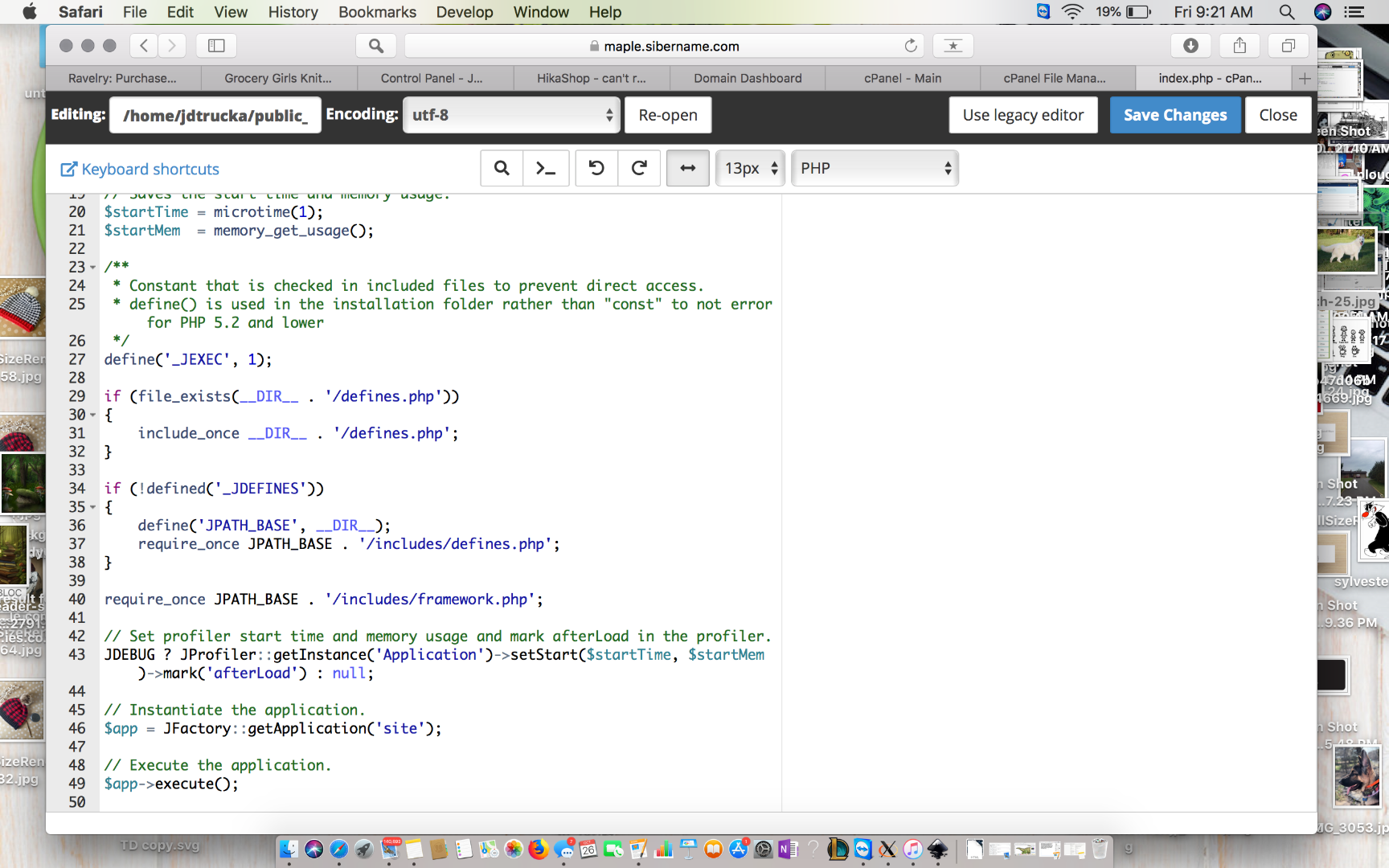

  • Posts: 86112
7 years 10 months ago #300079
Could you provide the full code of the index.php ? Because the error says that it was expecting the end of the javascript but there is new javascript after that line. So it indicates an error in the javascript before. Without the full code it's difficult to say which code in particular is the problem and thus provide a solution.
