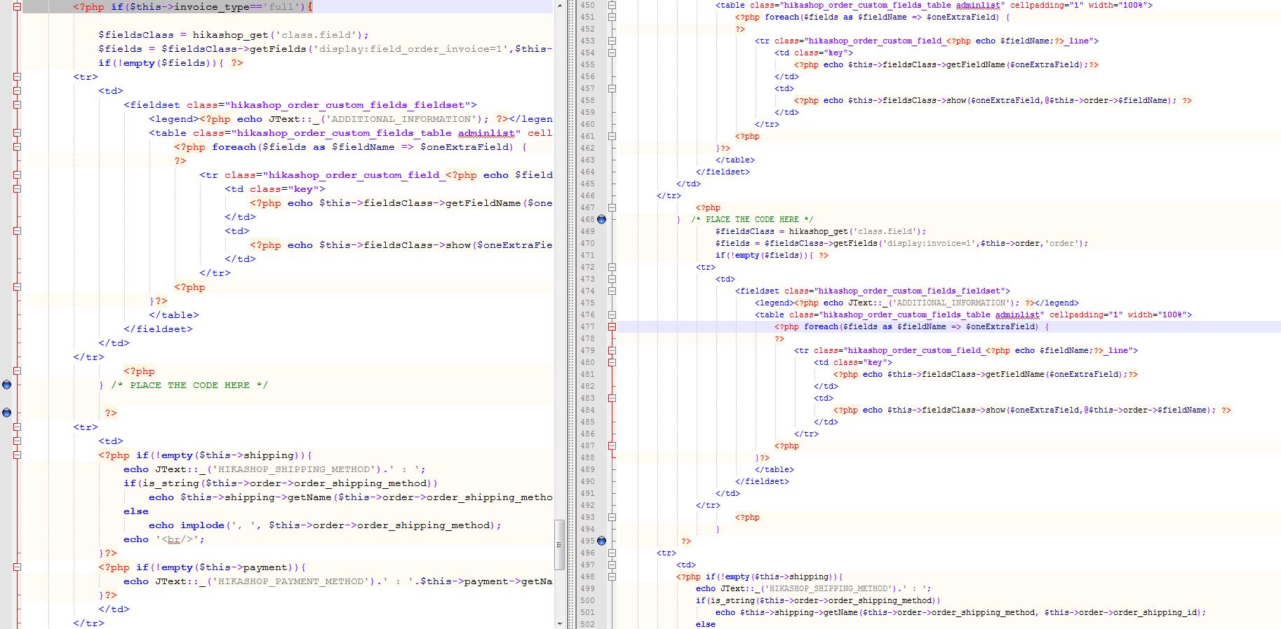

9 years 1 month ago #268428
I had the same problem I fixed this with te given code. maybe its a bug?
Well I placed the code in in the main if statement of : if($this->invoice_type=='full'){ ...... } after the first check: if(!empty($fields)){ ?>.... <?php> }
I added a screenshot for better view. It helped in my case.
Last edit: 9 years 1 month ago by OA.
