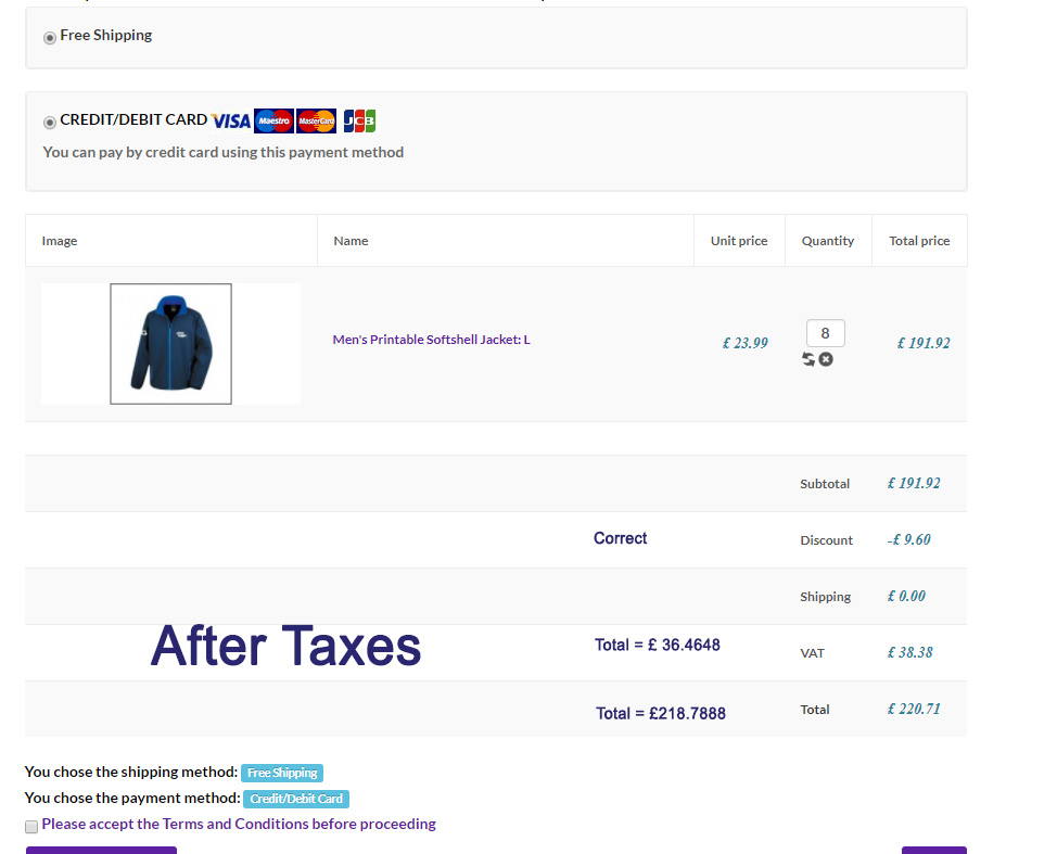

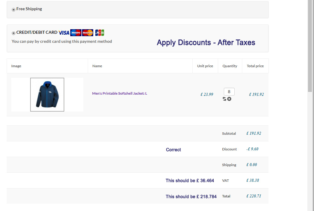

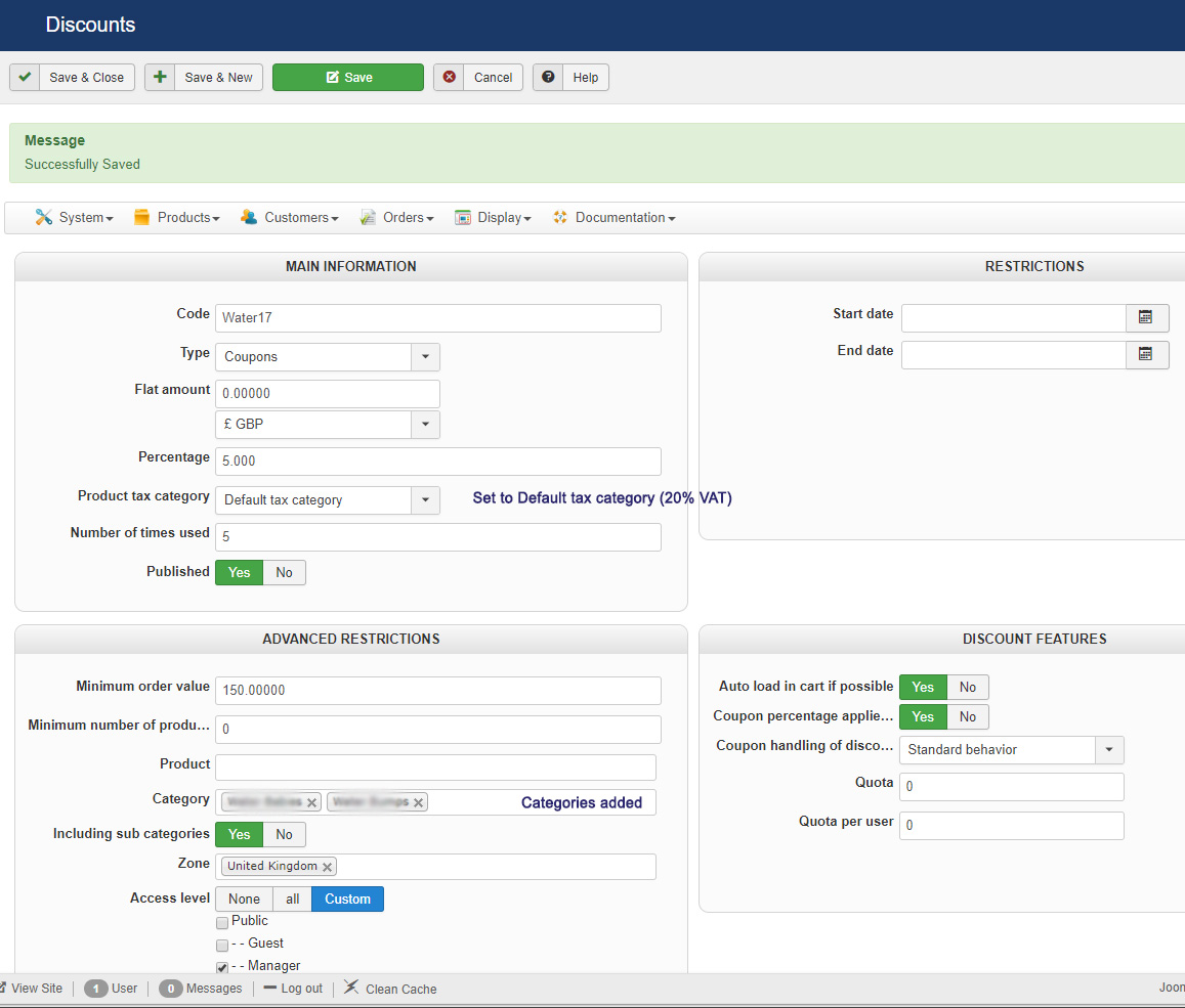

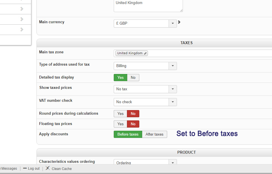

  • Posts: 41
8 years 10 months ago #274490
Jerome, it does appear that the linked thread is very similar in the configuration doesn't appear to work as expected.
I have taken screen shots of the items you have requested, additionally, I have taken a screen shot when I changed the setting "Product Tax Category" to "None" & set "Apply Discounts" to "After Tax" This setting seems counter intuitive to me although this does apply the correct discount to the cart.
Although this leaves the Tax being charged too high, and thus the total is now too high.

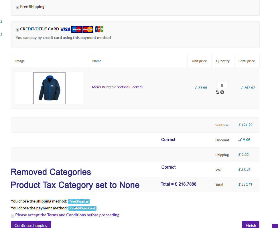

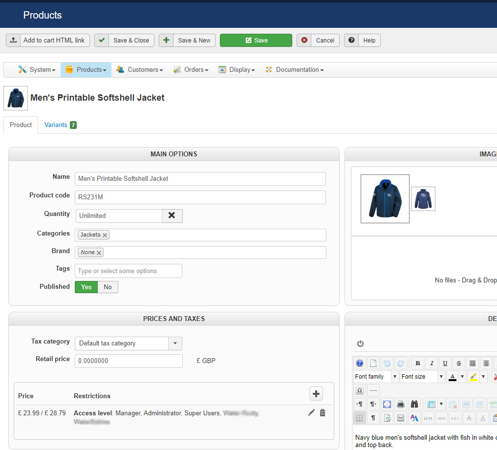

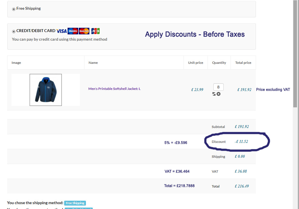

Below is the setup as I had it originally and the result that is shown in the cart. I have noted what the correct calculations should be.
The Tax zone is set to the United Kingdom, which for most items is set to 20%, there are 0% items that are available for sale which I haven't tested yet to see how it would be applied.

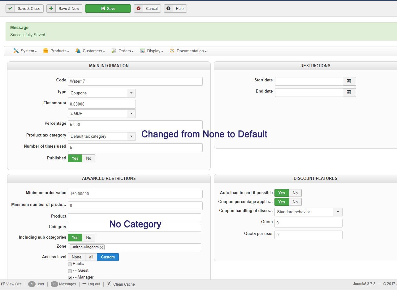

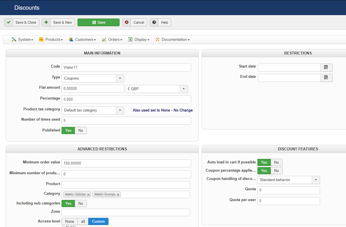

This is the setup of the Coupon I also changed the Product Tax Category to None which had no change until I changed the global "Apply Discounts - After Tax"

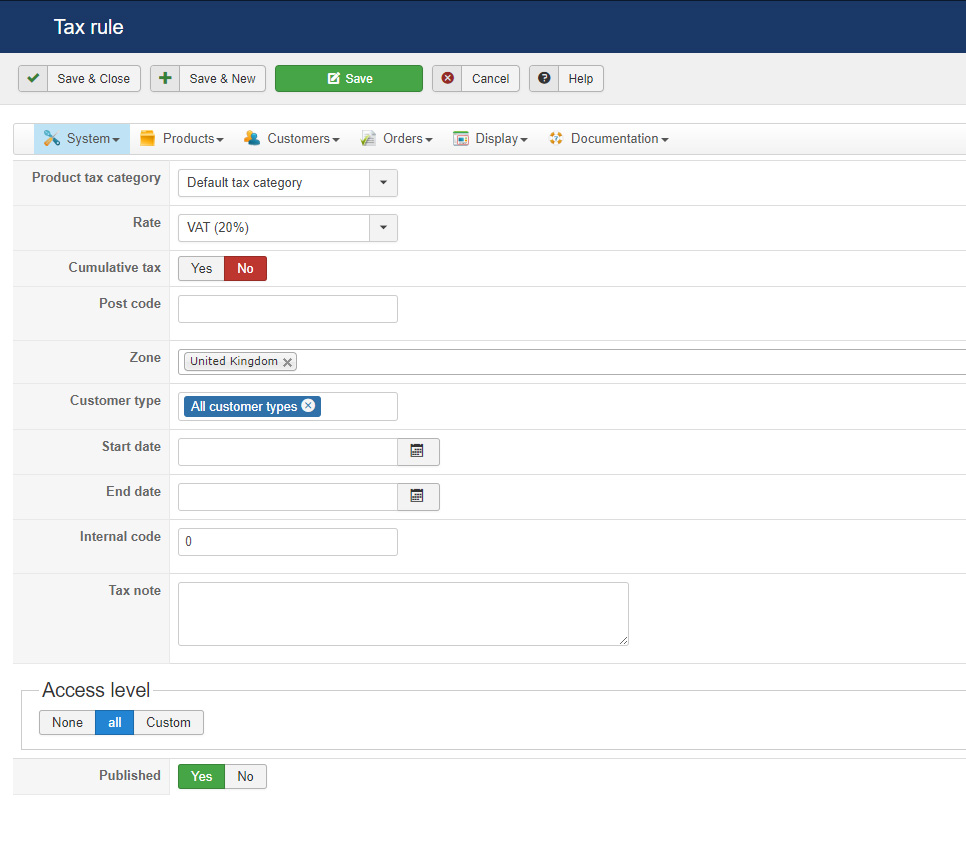

This is the default Tax Rule, as can be seen, the zone is set to the United Kingdom.
This is the setup for a product which is a sub-category to the one which is selected in the Apply Discount to setting.
Below is the result of changing the details as suggested in the other thread, I have added notes to the image.
If you would like any more details please let me know and I shall update this thread.
Dave

  • Posts: 41
8 years 10 months ago #274493
Panos,

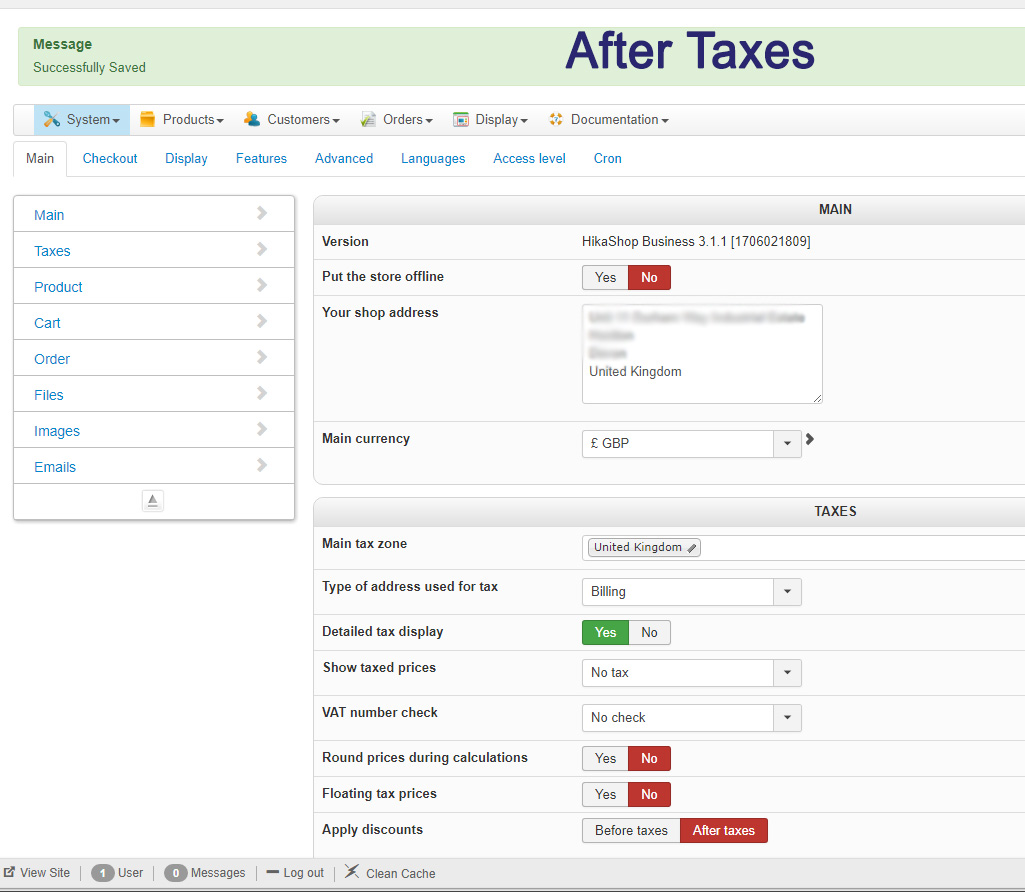

It's counter intuitive, but in the global settings change the Apply Discounts to After Tax, and in the coupon set the tax to "none" I am sure that those combinations shouldn't "almost" work. But as per my last screen shot the Coupon is applied correctly. However, the Tax (VAT) isn't then applied correctly.
Dave

  • Posts: 26355
  • Thank you received: 4068
8 years 10 months ago #274515
Hello
@Twincarb - thanks, I will reproduce your configuration in my side and perform some analysis.
I can see that you have some category restriction on your coupon and that your product is a variant. It could be a useful clue regarding the past patches in the discount system.
@panefs - Okay but I'm sorry right now it does not help.
I'm asking for elements to be able to work on in a controlled website environnement where I can edit easily and fast files to find the issue. Unfortunately you do not provide such information (I don't need sentences, I needed screenshot in order to get all settings even if these screenshot are from HikaShop 2, the settings are still the same !).
I'm glad that Twincarb give it so we will be able to move forward now.
I'll keep you posted for my progresses.

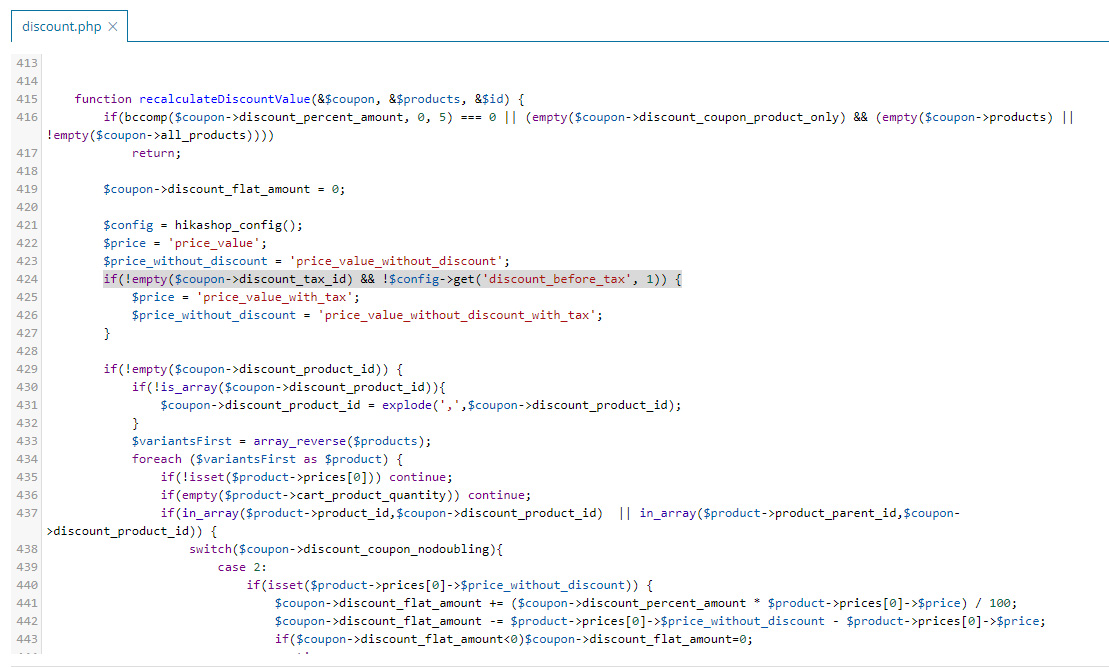

I detected an issue related to the thread I mentioned in a previous message :
www.hikashop.com/forum/taxes/888957-discount-on-vat.html
You do not know that and very few people does, but when a discount have a "percentage" value but is applied on specific products, HikaShop is converting the coupon into a flat amount coupon.
The HikaShop coupon algorithm support flat amount and full percentage ; so when the percentage is not on the full cart it has to be converted.
Due to the patch that Nicolas made in the other thread, that conversion is forced to read the prices with taxes.
I think the patch should be modified in order to be more specific and less "open".
So in the file "administrator/components/com_hikashop/classes/discount.php" you have to replace
if(!empty($coupon->discount_tax_id) || $config->get('discount_before_tax', 1)){
By
if(!empty($coupon->discount_tax_id) && !$config->get('discount_before_tax', 1)) {
In the same time, I will write a full report to Nicolas in order to integrate the patch into HikaShop packages and perform some other modifications.

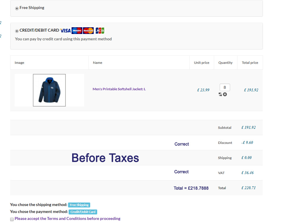

  • Posts: 41
8 years 10 months ago #274536
Hi Jerome,
Thanks for looking into the coding on a Sunday! I will make the change you suggest shortly and let you know what my results are.
Dave
  • Posts: 41
8 years 10 months ago #274542
@Panos,
For your information, the line that needs changing is 424 in "administrator/components/com_hikashop/classes/discount.php"
@Jerome,
Please see below the results that I had once I applied the change to the above reference file.

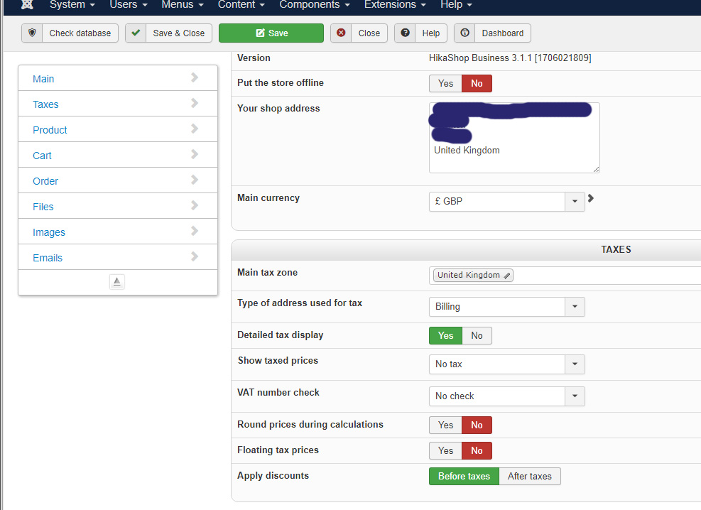

The first check was keeping the Taxes setting in the global configuration as below. As can be seen in the second image the VAT (Tax) and Total amounts is still incorrect. (Coupon settings at this point are Product Tax Category = None & Categories are in place.

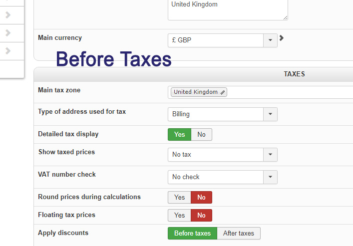

In global config, I changed Apply Discounts before Taxes (This is the logical setting) As can be then seen the Coupon in calculated correctly the VAT(Tax) is correct but the total is incorrect!
continued on next message...
Last edit: 8 years 10 months ago by Twincarb.

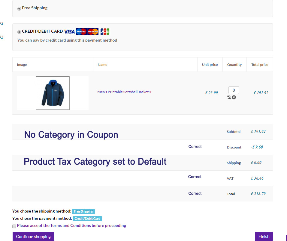

  • Posts: 41
8 years 10 months ago #274543

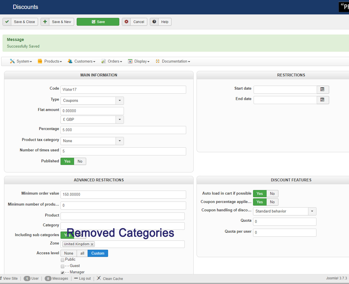

Next, I went into Coupon settings and Removed the limitation on the categories (This is far from ideal for the live system as the coupon should only be valid for certain categories.) Again the total amount is incorrect however the other details are as expected.
I then changed the "Product tax category" from None to Default tax category and kept no limit to any category. This resulted in the correct details showing in the cart.
continued in next message...

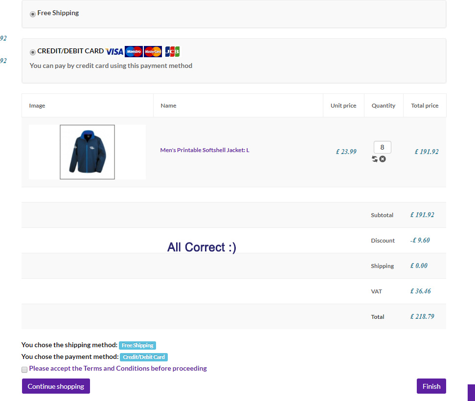

  • Posts: 41
8 years 10 months ago #274544
****Working Configuration****
Final check was to add the category restrictions back into place and the result remained the same, I have included the Taxes configuration as well so all the settings are able to be seen
@Jerome, Thank you for your efforts this weekend it would appear we have a working solution and configuration which is logical.
@Panos, I hope your able to follow the final settings that I used and are able to confirm your success as well.
Kind Regards,
Dave
