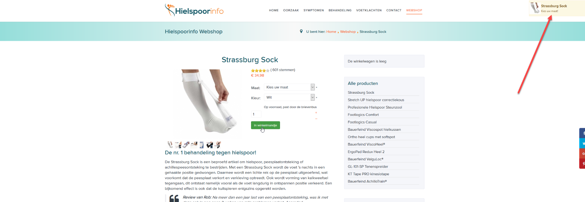

Just one thing that users might miss: I am working on a pretty wide screen now and the notifications in the upper-right corner coulkd easily be missed. Especially showing errormessages should really be more obvious I think. See attached the screenprint of an action where the user needs to select a size for the product. I really think users could miss this:
I checked the configuration for options to configure how errormessages are displayed, but I could not find any.
  • Posts: 26384
9 years 3 months ago #270576
That display is made by a plugin (HikaShop / Cartnotify) ; you need to configure it in the Joomla plugin manager in order to change the position or use the "popup" mode.

  • Posts: 135
9 years 3 months ago #270640
Ok, thanks for clarifying, pop-up mode works fine for me. Thanks for clarifying, all set to upgrade now ;)
