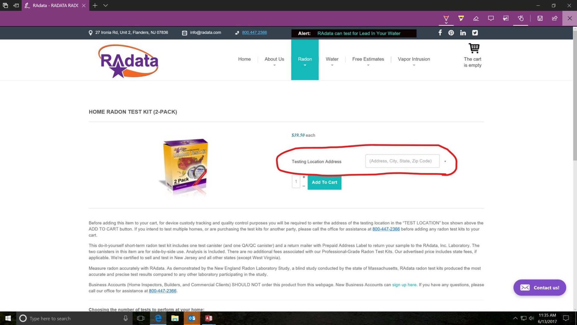

  • Posts: 64
9 years 2 months ago #271769
See the attached. Its what the client sent me.
  • Posts: 26384
9 years 2 months ago #271771
See : pasteboard.co/i6aWwVWyQ.png
I'm afraid that I have to re-quote the same message:
Ok, but that's the same message, so it doesn't help.
What exact problem do you have ?
Are you able to reproduce it ?
If yes, could you provide a link to the page with the issue and provide the instructions in order to reproduce the problem ?

  • Posts: 86106
  • Thank you received: 14207
9 years 2 months ago #271850
The display options of the custom fields have changed since HikaShop 2.6.0
So please edit the custom field via the menu Display>Custom fields, check that the display settings are configured like you want and save them once. It should display display properly.
If not, then it means that there is an old view override of the product page layouts which is based on the old code of HikaShop and which creates the problem. In that case, try renaming the folder templates/YOUR_TEMPLATE/html/com_hikashop/product/ and try again. If it works, it will mean that it indeed comes from a view override in the template.
