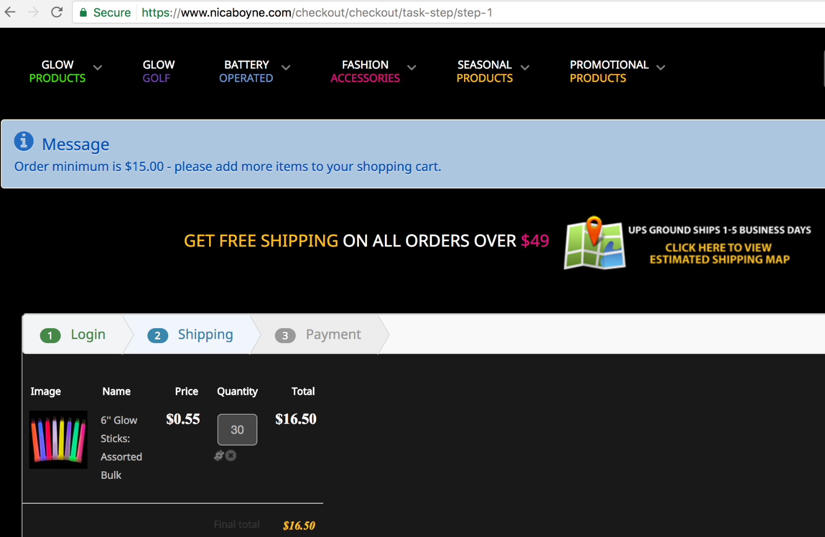

-- Joomla version -- : 3.7.2
I have an interesting issue where, when a user adds a number of items to their cart, they're prompted for a message at checkout saying there is not enough product in their cart to meet minimum order price ($15.00).
However, the cart price is well above this value, and we aren't configured to have a minimum order price anyway.
Here's the step to reproduce:
  1. Visit product URL: Glow Sticks
  2. Add 15 to cart
  3. Checkout
  4. Login and try to go to shipping method
  5. Should get error at top

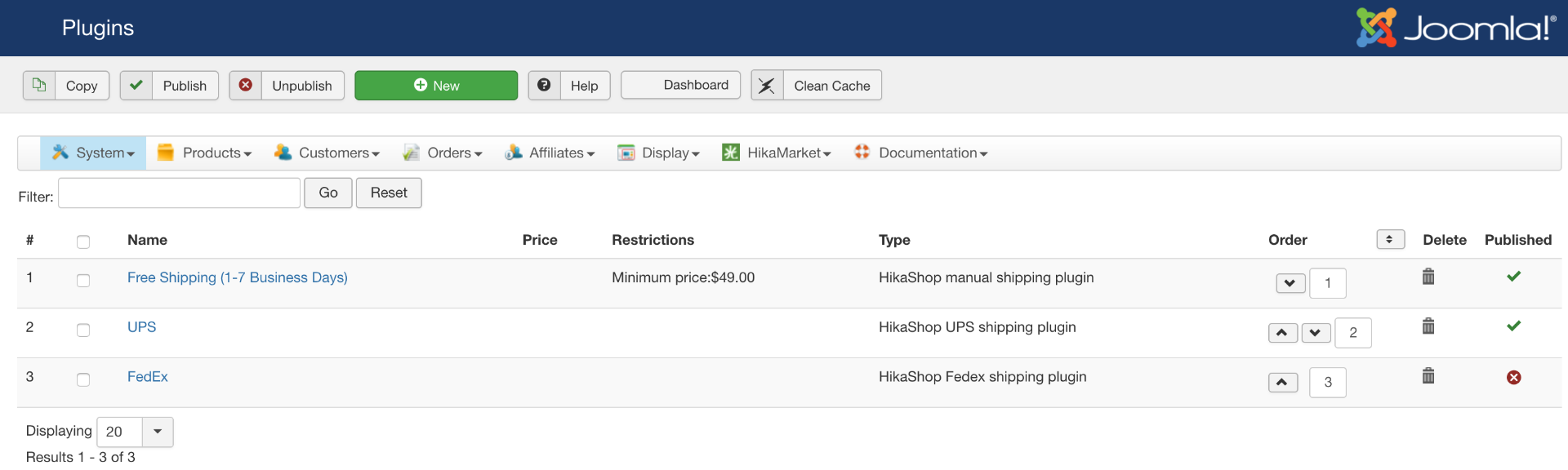

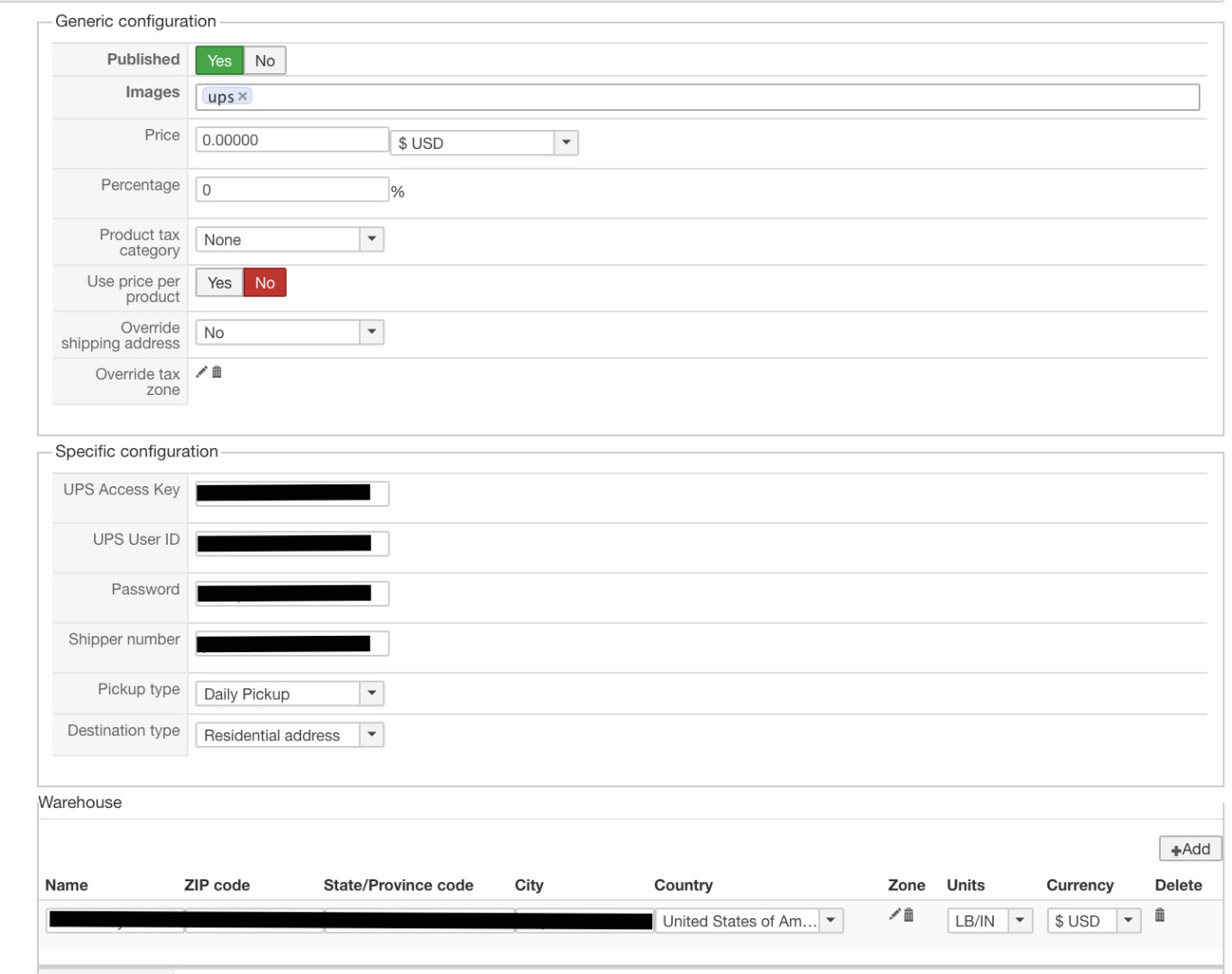

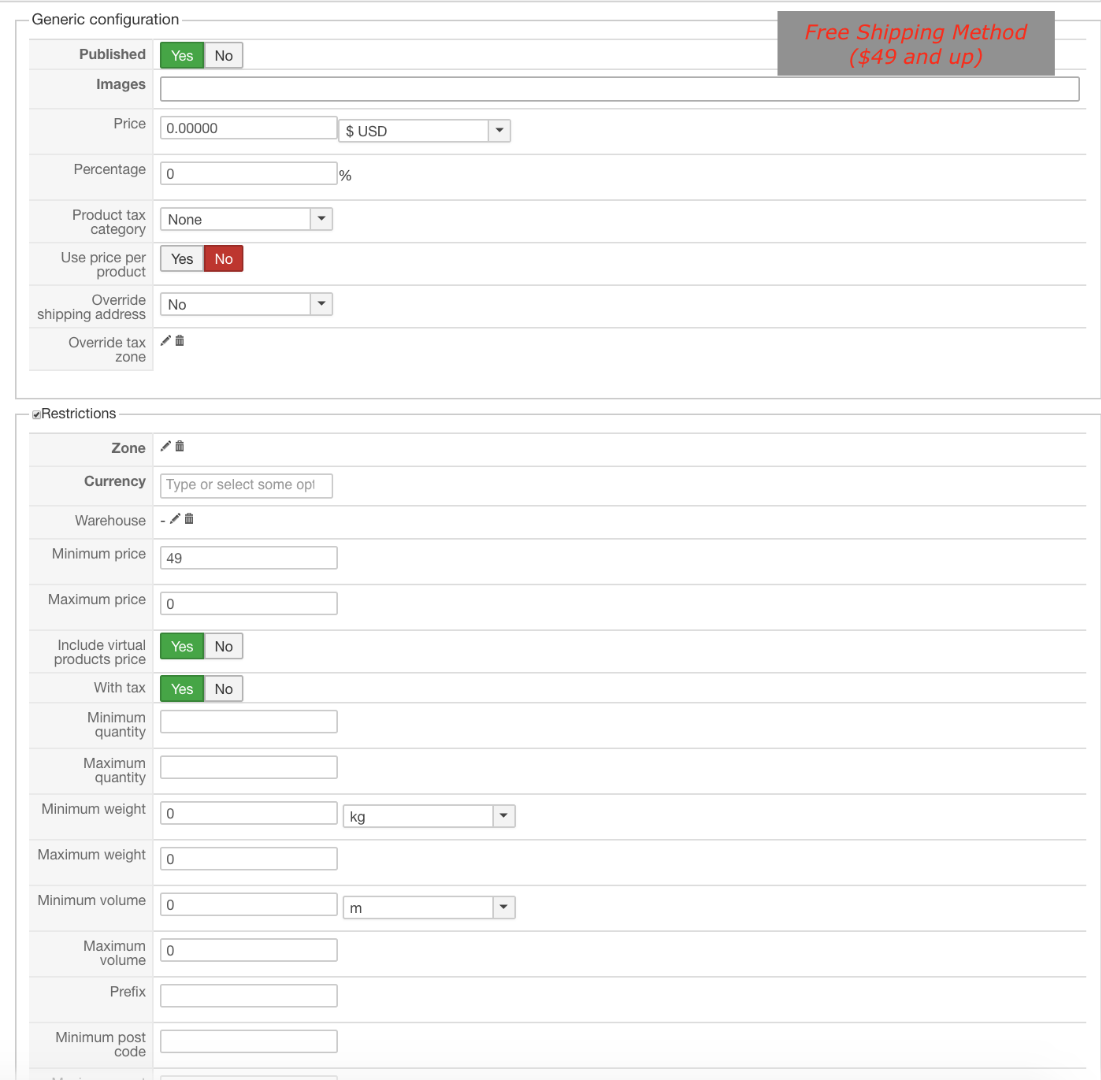

  • Posts: 32
8 years 11 months ago #273921
Thanks Nicolas,
I think I'm seeing the pattern. I tried your suggestion about "include taxes" and "include virtual products price" but the behavior is the same. Let me step back and first say that we only have two shipping methods. First, a "Free Shipping" option for orders above $49. Second, a UPS shipping method.
I now notice that orders above $49 work fine, but I'm not seeing UPS options for shipping. When I disable the Free Shipping method, I get an error tied to NO_SHIPPING_METHOD_FOUND. That suggests to me that UPS isn't returning any rates.
I think the problem may actually be the following:
  1. User adds < $49 of product to card
  2. User goes to checkout
  3. User doesn't qualify for Free Shipping method as it's less than $49 threshold
  4. No UPS rates are returned
  5. min_rate error is the default when there is no rate to compare against
Just a guess. I've attached the configuration of our shipping methods for reference in case you see anything bizarre that sticks out. I haven't changed anything here in a long time, though.
EDIT: Just insanely frustrating. Some items don't work with UPS and I can't figure out a pattern why. Checking in HIKASHOP_PRODUCT table, they're basically identical from a weight, dimension standpoint. The only difference between a product that works (ex: Glow Golf Balls) and a product that doesn't (ex: Adhesive Glow Circles) is that the former does not have any product variants.
Last edit: 8 years 11 months ago by killnine.
  • Posts: 85732
  • Thank you received: 14059
8 years 11 months ago #273922
The way I see it, the issue comes from your translation.
You must have written the $15 limit in hard in the translation but you changed the minimum price from 15 to 49 in the free shipping method.
Thus, you get the message correctly as you're below the $49 threshold but the message says $15 instead of $49 because it hasn't been updated.
Now the fact that the UPS plugin doesn't return any rates is a separate matter and it comes from how the shipping method is configured and/or how the products are configured and/or how your checkout is configured.
