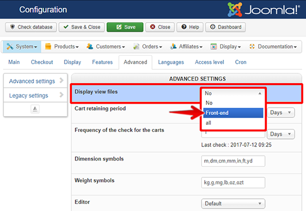

8 years 11 months ago #273793
You have to know that html & php knowledge, in order to guide you, follow these steps :
- Go to Main HikaShop Configuration (in Components => HikaShop => Configuration), and in Advanced tab, set this :
- Go to your concerned front-end page, put your mouse on your element and right click, then select inspect (or inspector tool change from navigator)
=> You will be able to see your Html element and sometimes, existing class, copy your it and look for it in your code view (Ctrl + F), that will help you to find your element to modify.
Note : This tutorial will help you.
