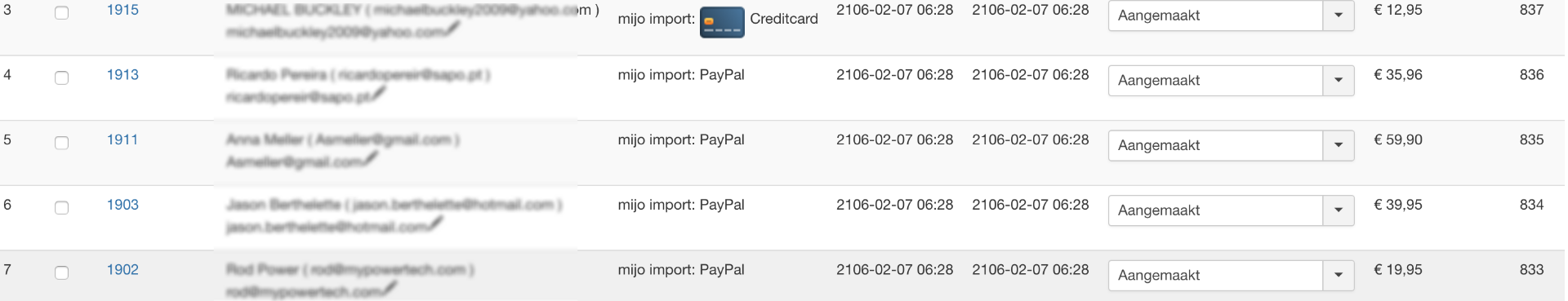

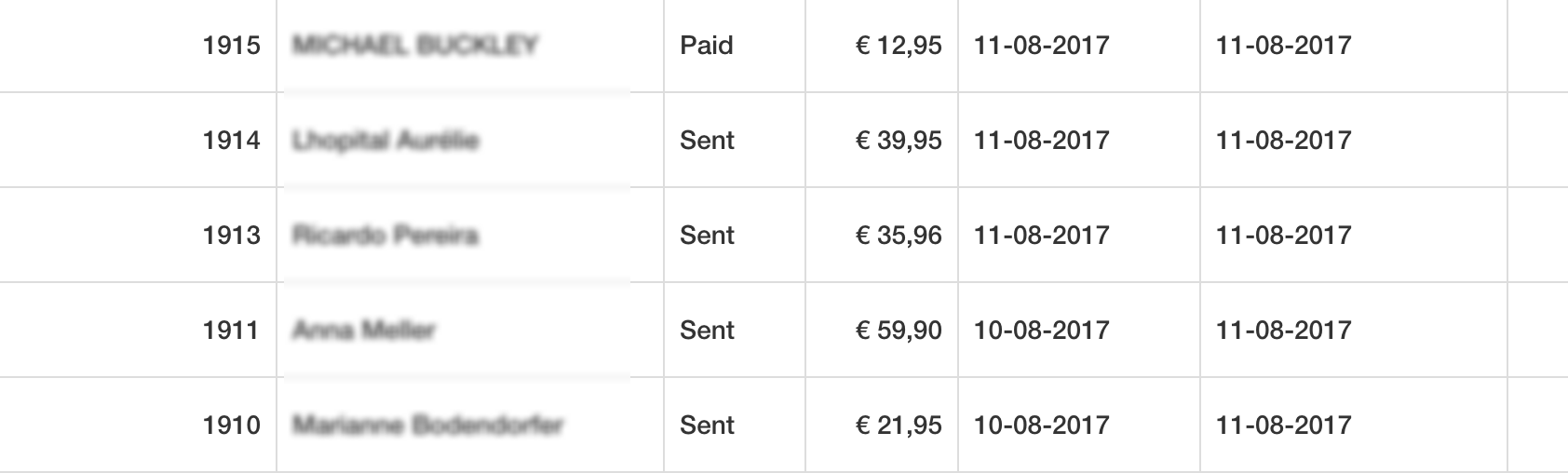

  • Posts: 198
  • Thank you received: 7
8 years 10 months ago #275854
Hi Jerome,
See screenshots from the same orders at first MijoShop and the second sho ti from HikaShop:
In HikaShop all the date's are the same....
Last edit: 8 years 10 months ago by renem.

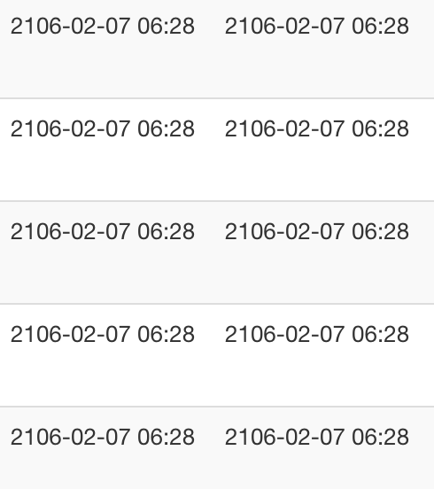

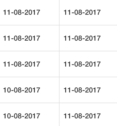

  • Posts: 198
8 years 10 months ago #275981
Hi Jerome your'e absolutely right.
I made two screenshots from the same orders:
As you can see the date's are totally different after importing from Mijoshop.
  • Posts: 26355
  • Thank you received: 4068
8 years 10 months ago #275983
So it means that Mjioshop do not use anymore "timestamp" but switch to "date" fields.
And you cannot put a date into a timestamp, the result is (as you can see) chaotic.
In the Mijoshop import file, you will find these lines
'order_created' => 'mjo.date_added',
'order_modified' => 'mjo.date_modified',
And you need to replace them by
'order_created' => 'UNIX_TIMESTAMP(mjo.date_added)',
And
'order_modified' => 'UNIX_TIMESTAMP(mjo.date_modified)',
