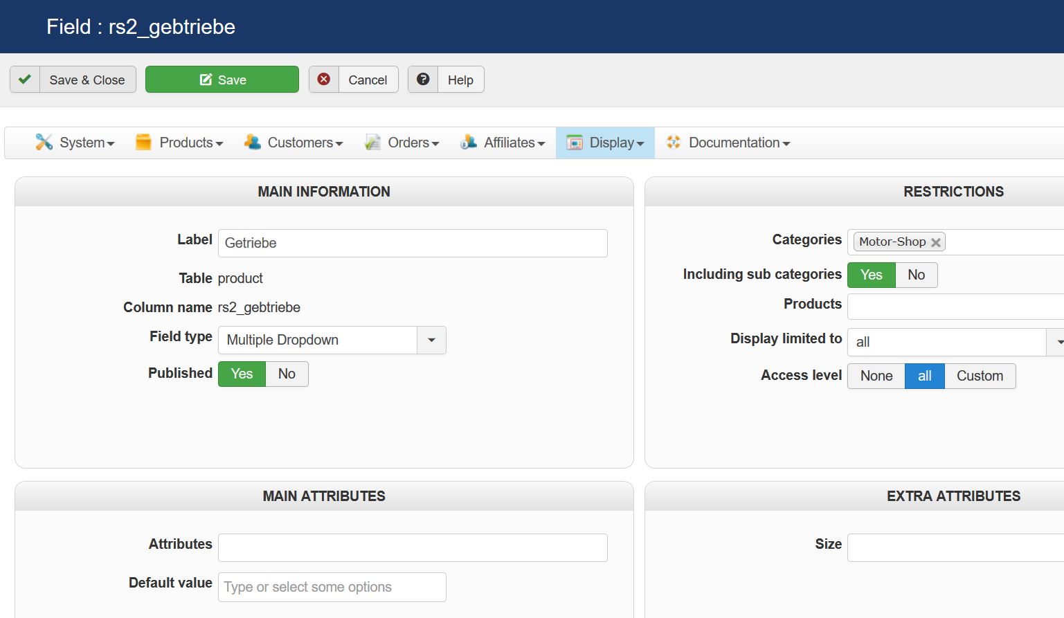

we have bicycle and motor bikes in the shop. Therefore I use the category restriction for some of the custom fields. The problem is now that the custom using the restrictions cannot be selected in the filter module.
thanks for you help
best regards
Markus

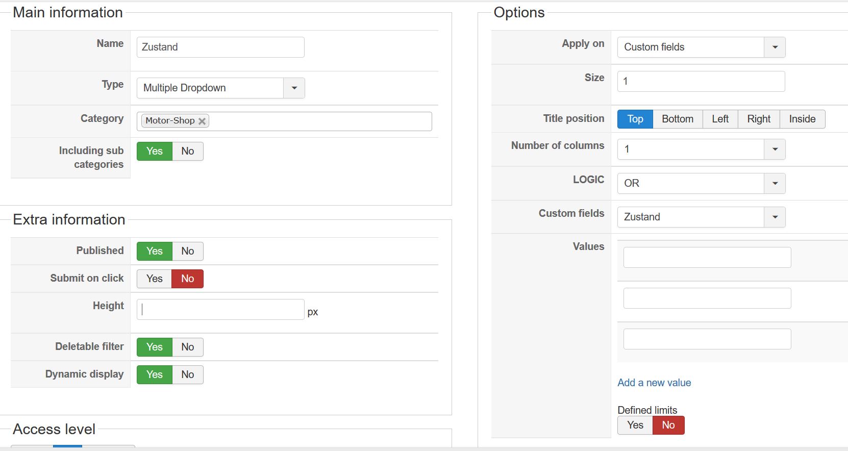

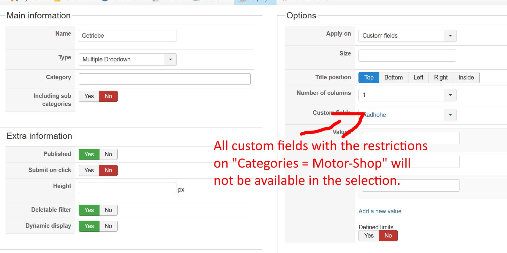

8 years 9 months ago #276637
Hi Nicolas
please find attached the details.
best regards
Markus
  • Posts: 85731
  • Thank you received: 14059
8 years 9 months ago #276708
You first need to save once that filter with that same category selected in the "category" field of the filter.
Then, the custom field selector will display both the custom fields without any category restriction and the custom fields with a category restriction corresponding to the category selected in that filter.
The following user(s) said Thank You: Markus Schnier

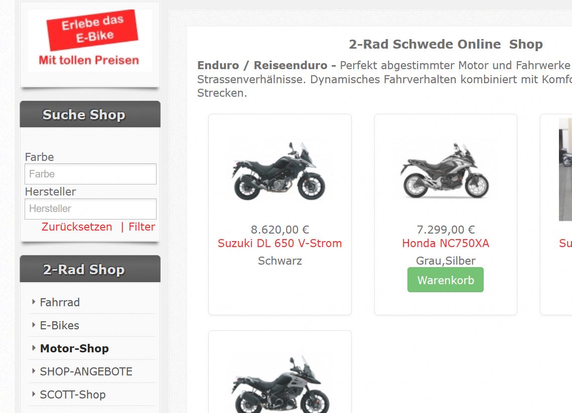

thanks that works. Now I can select the custom fileds. But the problem is now that these fields will not be visibile even if I am in the right categories.
Any Idea
thanks and best regards
Markus

  • Posts: 98
  • Thank you received: 7
8 years 9 months ago #277354
thanks. Both prerequisites were fulfilled. The problem was that I forgot to add the new filters to the field ‘Filters’ in the Search Module.
Thanks and best regards
Markus
