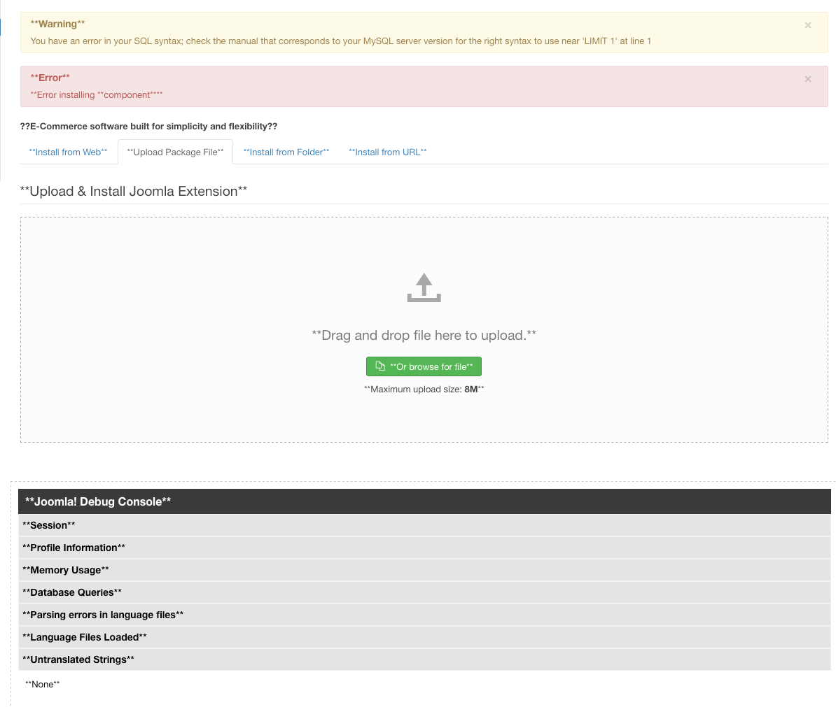

8 years 9 months ago #277682
Hello Jerome,
Trying updating HS again, no more blank admin page this time, just the following page (see picture). Debug was enabled, but that doesn’t teach me anything special. The tab DB Queries shows some duplicates (but I've seen those with other sites and components too too)

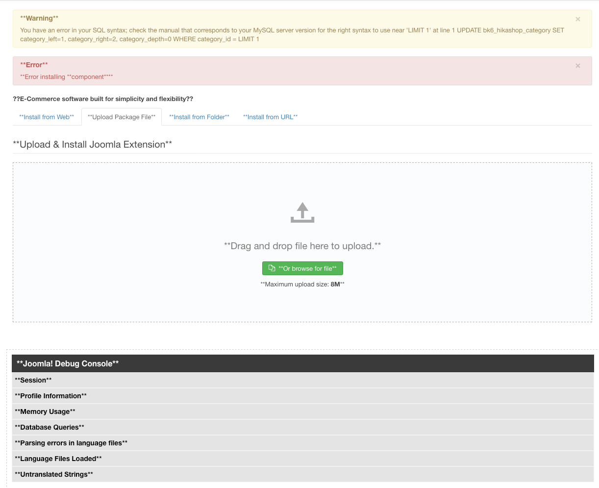

Hello again Jérôme,
This time the Warning message is a bit longer, see picture. Since there is a reference to "category" (bk6_ is my Database Table Prefix) a thought comes in my mind that maybe there is something with the categories, so I join a picture of those as well. Joined a dump of the table mentioned in ERROR-installing-component-(2).png as well (zipped).

8 years 9 months ago #277765
Okay, that's much more useful message !
You have issues with your categories and you have some corrupted data.
I'll prepare a patch for the "rebuild tree" function in order to avoid such SQL error but in your side, you have to check your table "hikashop_category" which might have a category with an ID 0 (which should not be possible unless you do not have the "automatic increment" anymore ; which is also an issue).
But seeing your category tree, I'm afraid that you have several errors to fix in your categories...
