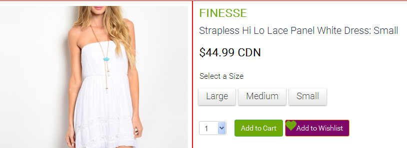

Is it possible to have the quantity dropdown display the amount of quantity available for that item?
Currently the dropdown is always showing 15. Example, if I have 3 bags, then it should only go up to 3, if I have 5 earrings then it only goes up to 5, etc...
Thanks!!

The product you're talking about and it's settings.
I am talking about all products that will have a dropdown. I would like the dropdown to show the quantity of that product or product option. For example, say the item below has 2 small, 3 medium, and 5 large, when the user clicks on a size the quantity of that size will show in the dropdown.
So if they click on small, it will show:
1
2
If they click on large, it will show:
1
2
3
4
5
Etc....
