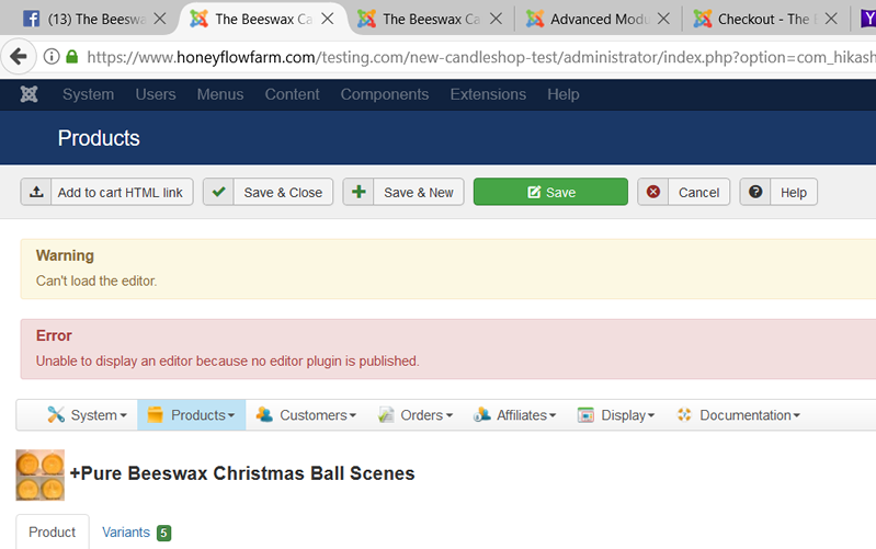

Also I get a "can't load the editor error" - what is this - image attached.

Regarding the editor error, it's probably because the editor that you had selected in the "editor" setting of the HikaShop configuration isn't installed on your new website. So go there and select another one, or install the one you were using on the other website.
