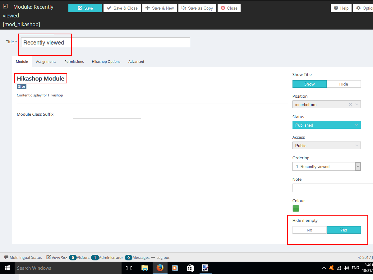

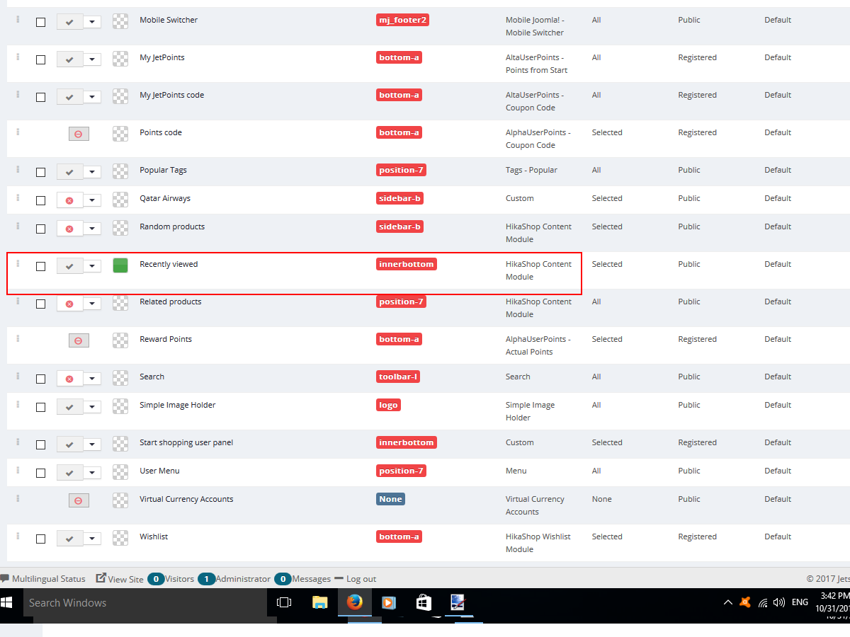

  • Posts: 128
8 years 10 months ago #281510
thank your for your answer, but I have to disagree on this matter.
I have attached two screen shots showing and proving that there is a hide if empty function within your Hikashop developed module.
So if there is such a switch, there should be a solution, cause as you see, I have selected Yes in the Hide if empty option.
Thanks again for your reply
Kind regards
Thomas
8 years 10 months ago #281525
sorry but the last 2 options (color & hide if empty) don't coming from HikaShop, see my backend localhost that don't use display plugin or specific template (only protostar).
Last edit: 8 years 10 months ago by Philip.
  • Posts: 200
  • Thank you received: 75
8 years 10 months ago #281610
@thomasf
what Philip is saying is correct, just because you see the "Hide if empty" button in a Hikashop module doesn't mean it has been developed by them. If you look more closely you will see the "Hide if empty" option for every module and it is in fact coming from a different extension you are using: Advanced Module Manager.
We also have a recent products module just like you have (and use AMM), and in our case it works fine and doesn't display anything if there are no recent products, so it looks like there is an issue with your template and as Nicolas originally wrote it's probably best to check with your template provider.
