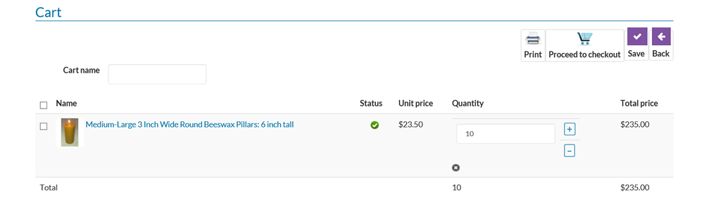

"Back" button not working correctly on cart
  • Posts: 254
8 years 10 months ago #282119
-- url of the page with the problem -- : www.beeswaxcandleshop.com/
-- Joomla version -- : 3.8.2
-- PHP version -- : 7.1.11
Thank you for your previous help on this site. This was a site I re-created to simplify and get rid of some errors.
In my shopping cart, The "Back" button goes to a wrong page asking fo a login - which I do not use on the site.
How can I make it go back to the previous page - or just remove the whole button.
  • Posts: 86109
  • Thank you received: 14209
8 years 10 months ago #282127
That's a good catch. The back button should only appear when you're logged in since it's going back to the user control panel or the listing of carts which is accessible only when you're logged in.
We'll add some code for that.
Edit the file "show" of the view "cart" via the menu Display>Views and remove that bit:
<td>
				<a href="<?php echo $link; ?>">
					<span class="icon-32-back" title="<?php echo JText::_('HIKA_BACK'); ?>"></span> <?php echo JText::_('HIKA_BACK'); ?>
				</a>
			</td>
