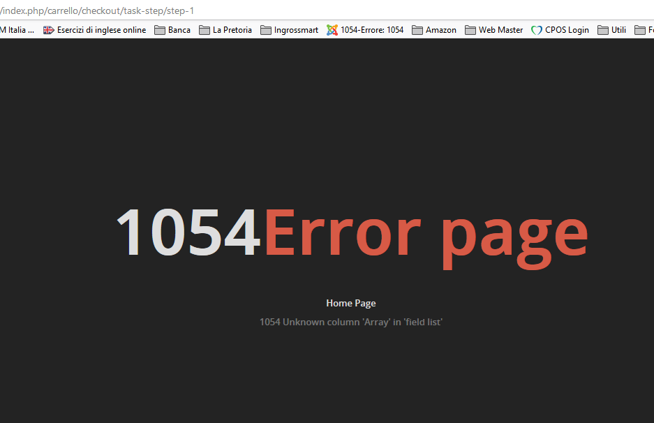

1054 Unknown column 'Array' in 'field list'
in my site have this problem in checkout.
1054Error page
Home Page

Can you activate the "debug mode" and "error reporting" settings of the Joomla configuration and try again ?
That should display an error message with more information on the issue so please provide it.
If not, then please look in the php error log of your server for the fatal error message corresponding to that issue so that we can better understand the situation.
Also, the version number you've provided doesn't exist.
So either you're using HikaShop 2.6.2 (and not the 3.6.2) and you might want to update HikaShop to the latest version to fix that issue; or you're using already the latest version of HikaShop, but you want to turn off the "checkout legacy" setting of the HikaShop configuration in order to use the new checkout system of HikaShop, which can hopefully help fix that issue.

I have activated both "debug mode" and "error reporting", but the error page after order confirmation is always the one for which I sent the screenshot. I've also turned off legacy Checkout but the result is always lost.

The issue comes from your custom field with the column name "1".
It's not possible to have a column name starting with a number. That will break as variables cannot start with a number in PHP.
You're supposed to have a normal name like "message" or "customermessage" for example, not "1".
We'll add a check to forbid such column names in the future.
Please recreate your custom field with a column name not starting with a number and it will work.
