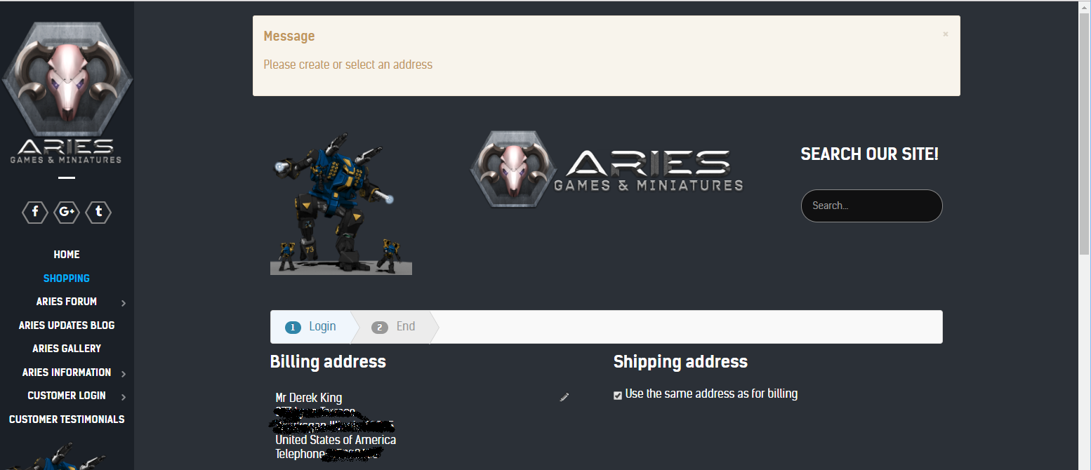

#2 - When trying to check out, it asks to select an address, even though an address is already selected (see image "Select Address" attached)

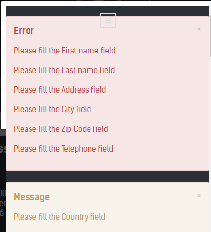

#3 - When trying to edit the address shown, I get an error saying I have to fill in the associated fields (see image "Edit Address" attached)

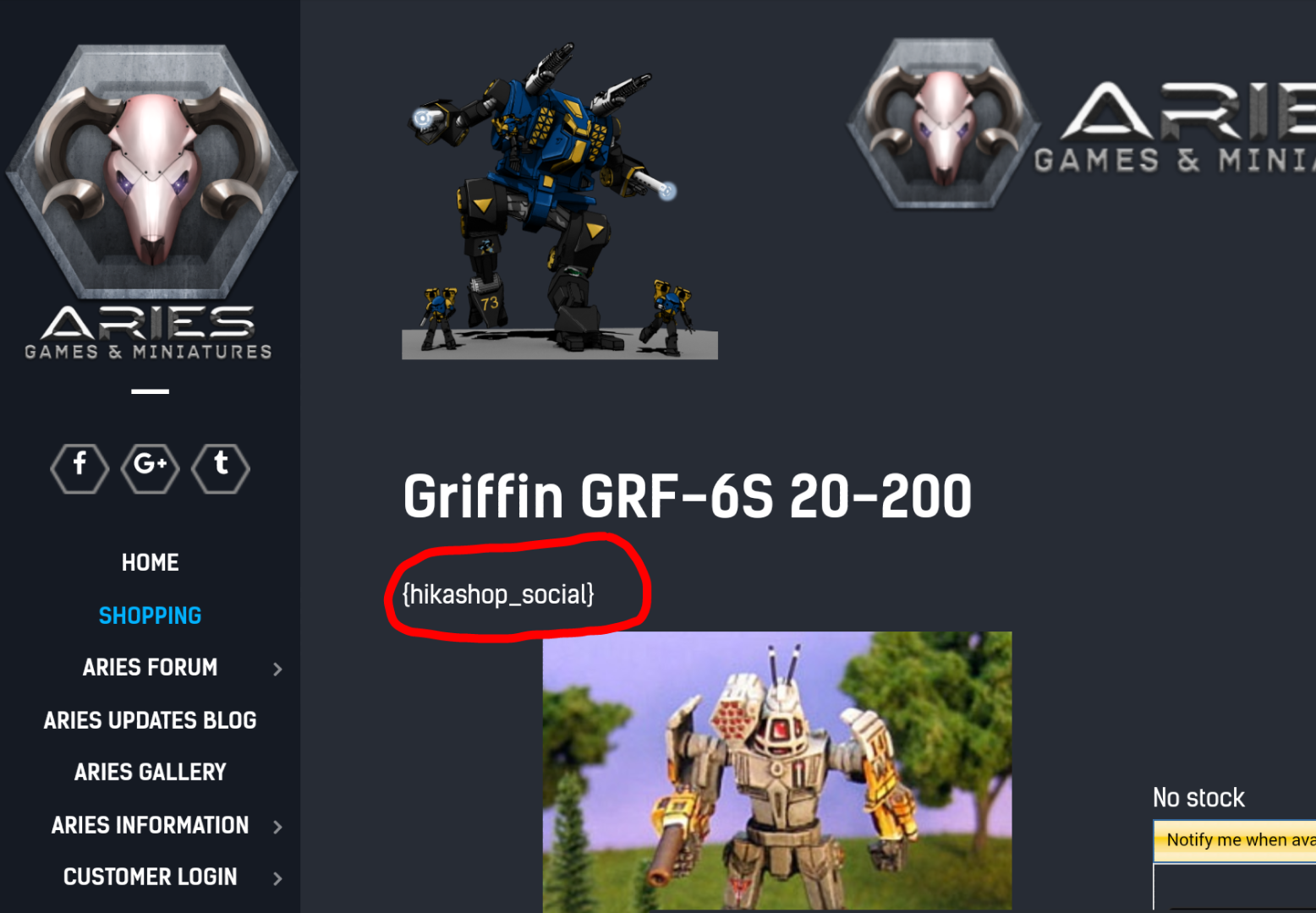

Jerome...I've also just noticed it says hikashop_social above the image in every product listing. That was never there before too. I've attached a screen shot

No error with the address, I can change the shipping method without any problem, I can finish the checkout, I don't get the {hikashop_social} tag on the product page as it is properly replaced by the social networks like buttons, etc.
