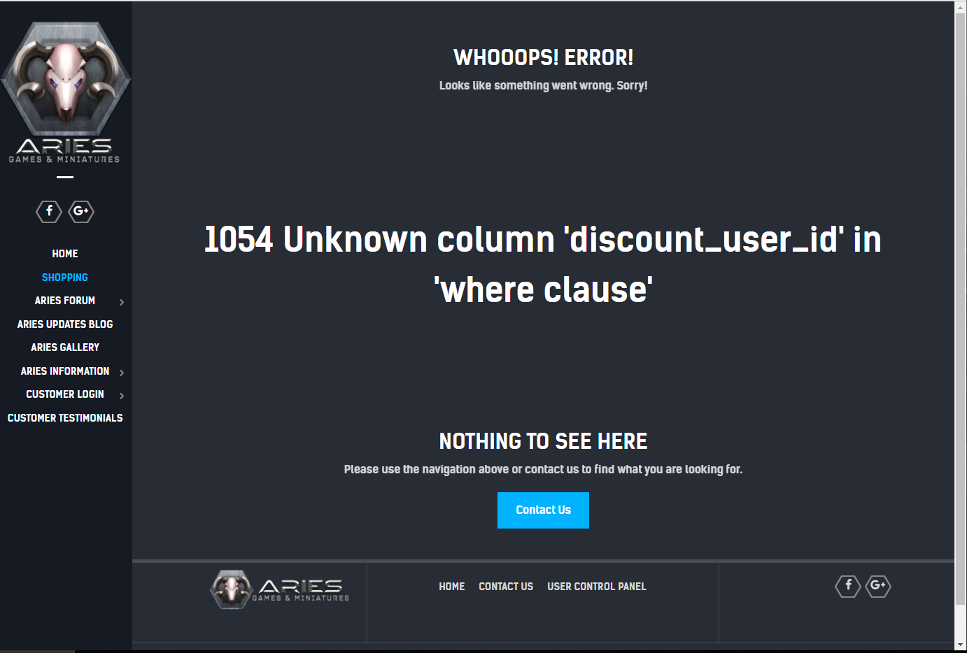

8 years 5 months ago #290920
And...it broke something after it was all pushed live. I've never seen this before...any ideas? I was able to click Shopping on the menu, then the manufacture, then the sub categories, but when I got to product, I got this error.

  • Posts: 26384
  • Thank you received: 4077
8 years 5 months ago #290954
You should perform a "check database" via the toolbar in your HikaShop configuration screen.
  • Posts: 713
  • Thank you received: 37
8 years 5 months ago #291002
Jerome wrote: Hello,
Ok...seriously, I'm pounding my head on my desk. I just did the EXACT same process today on yet ANOTHER fresh staging ground...and there are no errors. Everything is working properly. I'm on Joomla 3.8.6, and HikaShop Essentials 3.4.0.
I'm beginning to realize why some people wanted over $2,000 USD to fix...it makes me want to give up. Literally.
I'll keep screwing around and see if I can break it and report back if I run into something.

Ok...all links seem to work. Order went through fine on the live site. Database had no errors. Nothing...it updated like it never had a problem like it should have 4 months and 3 days ago based on the first post of this thread.
I'll keep an eye on it and report back if there's an issue.
Thanks for putting up with the insanity, sorry it was so frustrating.
