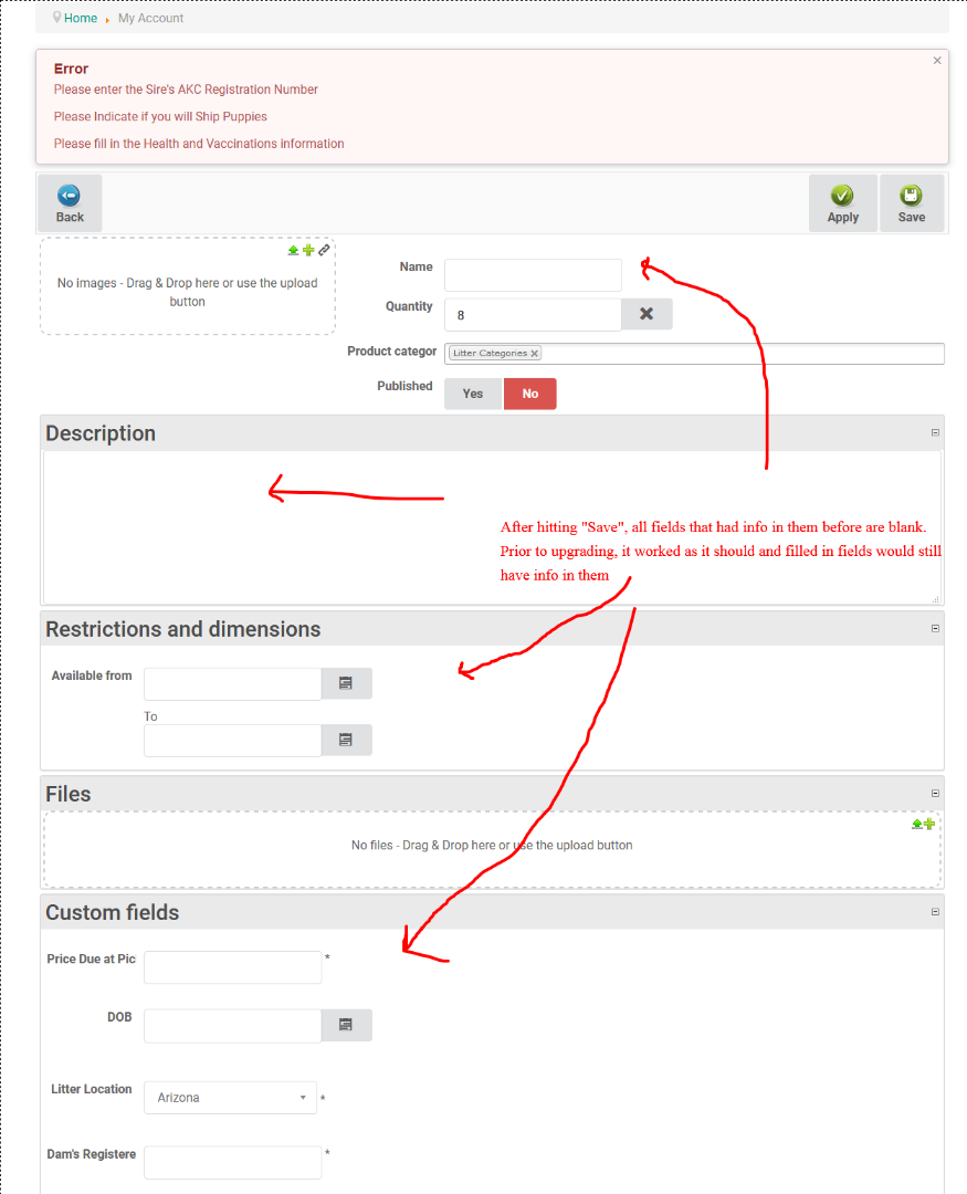

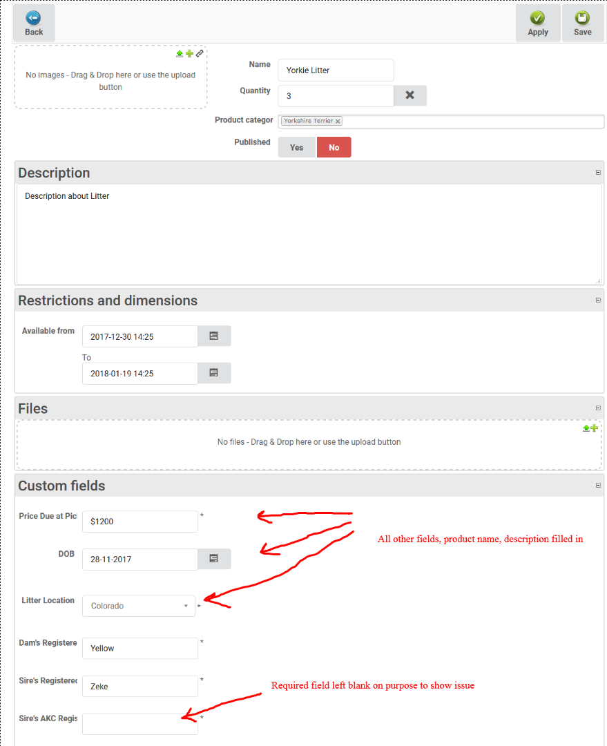

  • Posts: 58
8 years 8 months ago #284561
Sorry that you didn't follow our ask. Here are the steps
1) Vendor is logged in to the front of the website
2) Go to their account and chose "Product" folder
3) Click on "Add a Product"
4) Enter info into fields -- name, price, description, custom fields, etc
5) They mess up and forget to put information in any REQUIRED CUSTOM FIELDS and hit "SAVE"
6) Page reloads and gives them message at top to "FILL IN REQUIRED FIELDS"
This is all great....HOWEVER...all the fields that they already filled in PRIOR to hitting SAVE are now CLEARED. None of the work they did before hitting "SAVE" is saved...they have to start over...annoying.
I'm attaching two screenshots showing fields filled in and then what happens after they hit "SAVE".
Hopefully that explains our problem.
