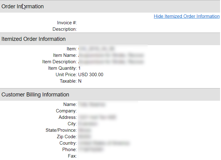

-- Error-message(debug-mod must be tuned on) -- : Invoice Number does not appear in authorize.net invoice.
How do we send the invoice number to authrorize.net?
Currently, no invoice number appears under the order information in authorize.net.
Looking at the API documentation, "invoiceNumber" can be sent under the "order" object in JSON.
I have no clue how the data is sent in the authorize.net HikaShop plugin.
I was hoping you can help me add a couple of lines of code to pass the invoice number.
See the attached screenshot for a visual of the missing information.

The invoice number is generated by HikaShop when an order is confirmed.
An order is confirmed when the payment plugin of the selected payment method of that order changes the status of the order to "confirmed".
A payment plugin will do that after it receives the confirmation from the payment gateway that the payment has been made.
So when the payment plugin places the order for the payment, the invoice number hasn't been generated yet and thus cannot be sent.
Now, in SIM, the "order id" is sent to authorize.net as "invoice number". In AIM mode, it's potentially possible to guess the order_id and send it:
www.hikashop.com/support/forum/payment-m...ber-description.html
But for the invoice number it's more complex to guess it.
I would recommend hiring a developer to do that.

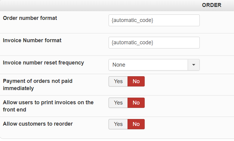

Finally, the orders in the database are mostly confirmed, but no invoice number is showing in the database for any order id. Here are the settings for "system > order".

As I said in my previous message, if you change the "invoice" statuses in the menu System>Order statuses, it can affect how the invoice is generated. So that's where you should first look if the invoice number is not generated for the orders even when confirmed.
