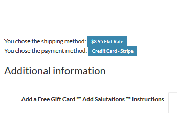

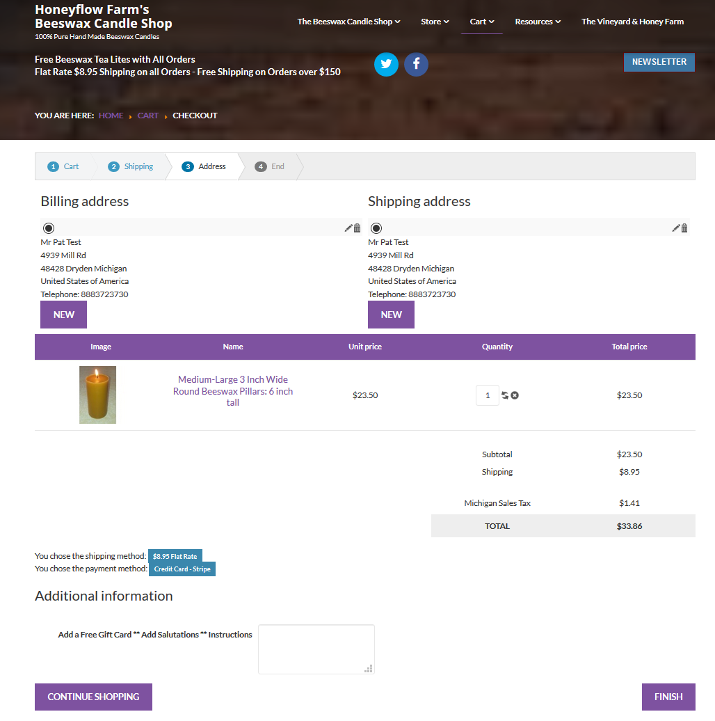

8 years 7 months ago #287664

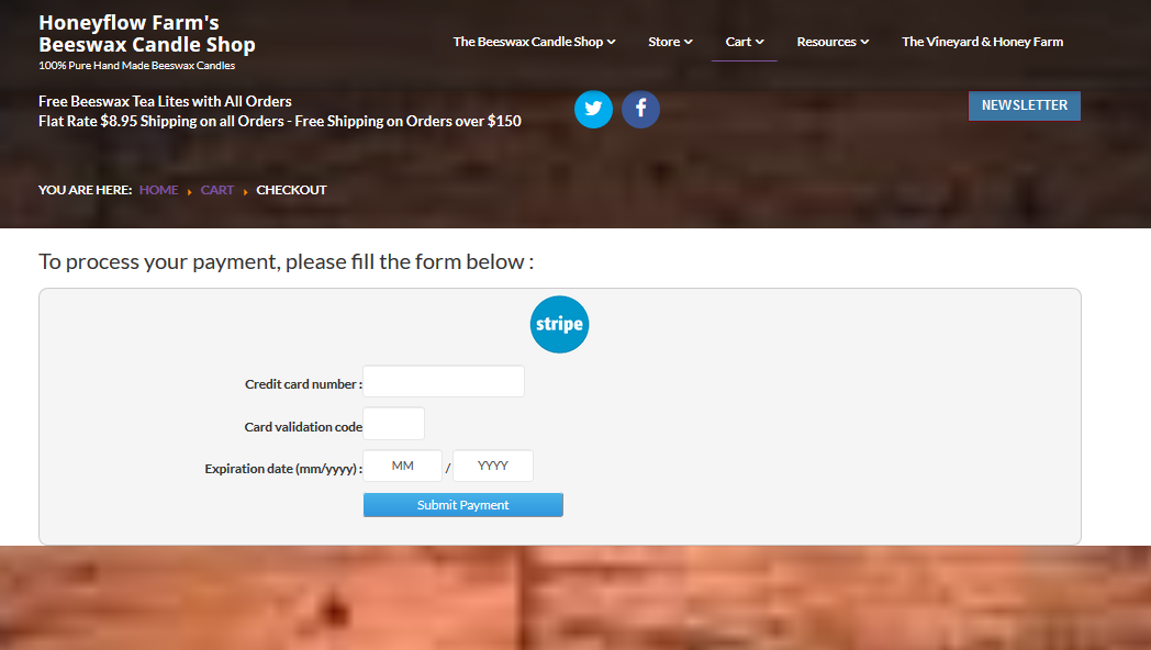

1 - An order gets submitted ok
2 - Customer selects Stripe as Payment method
3 - So far the customer has had no opportunity to enter card info. When he selects "finish" the order goes through and I receive it even without payment.
The next screen below comes up after "finishing" the order.
After customer enters info the customer receives the "Thank you for your order" screen and I get a message from Stripe saying payment has been made. Everything is working.
THE ISSUE: When the customer sees the screen below with these blue boxes on it and enters "finish" The order is completed BUT IT IS NOT (no payment yet. I think the Stripe credit card info screen should come up right before this one below..
This is similar to how the paypal plugin works. I can live with it if it cannot be easily changed but if the card data page can me moved the plugin would be better.

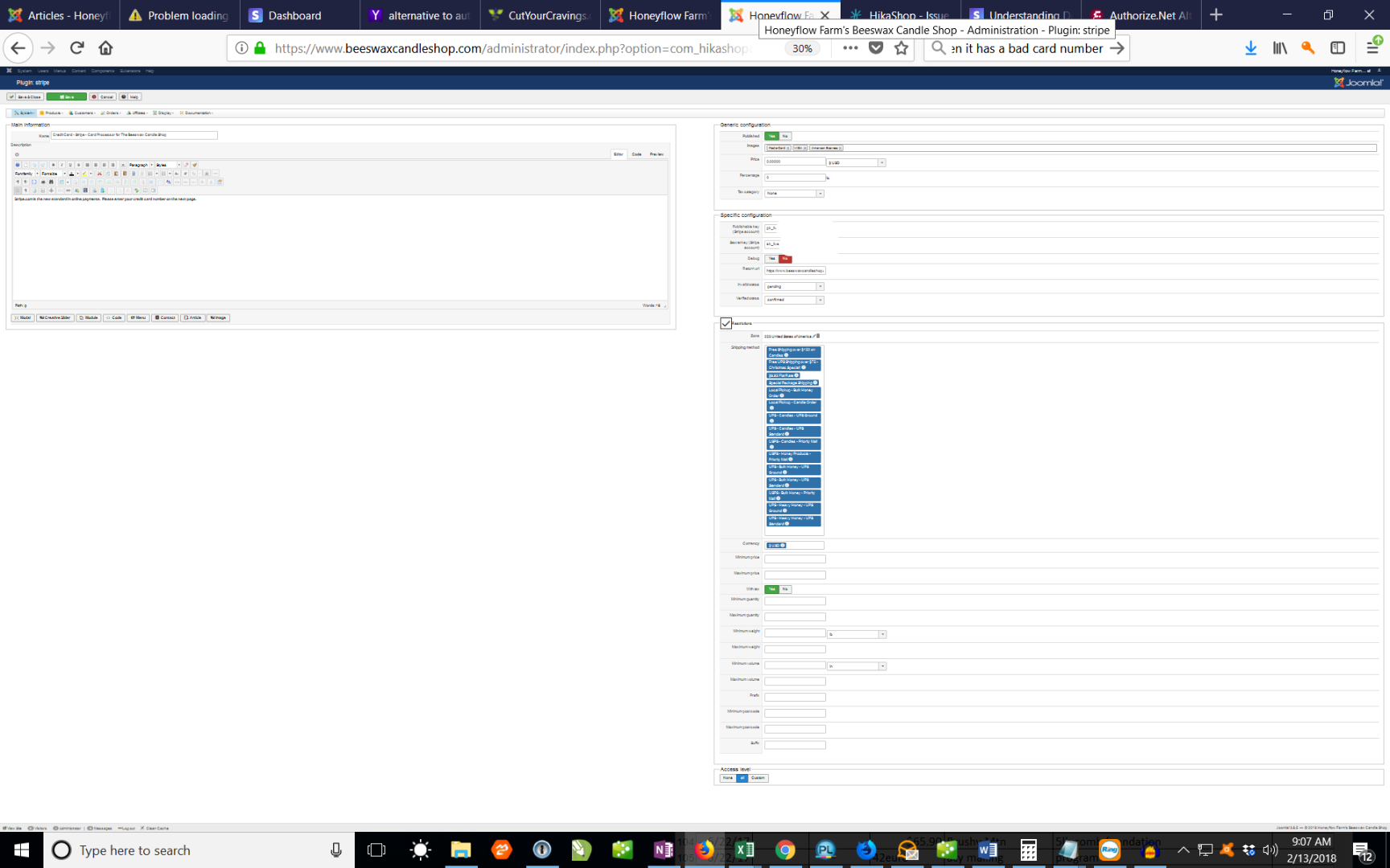

  • Posts: 254
8 years 6 months ago #287862

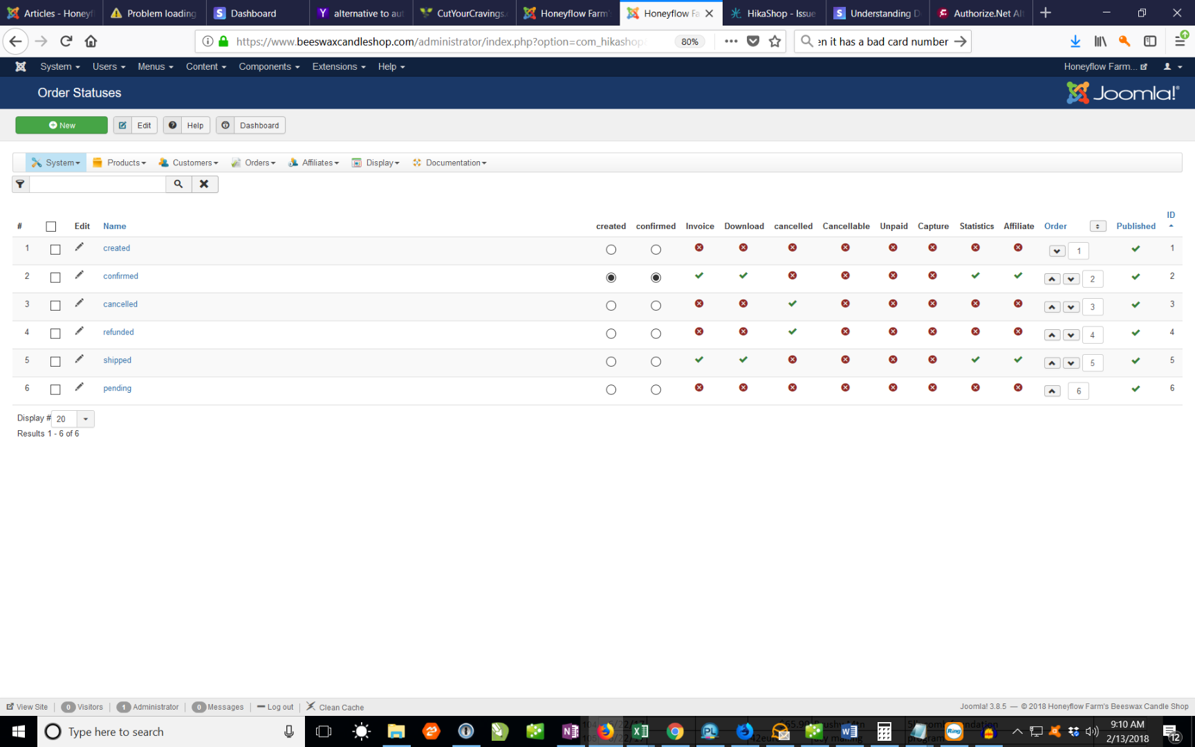

Here are the two screenshots. Go ahead and try another test order - using a card with an incorrect pin number and you will see NOTHING happen - order just disappears.
  • Posts: 86112
  • Thank you received: 14209
8 years 6 months ago #287865
You've configured the "confirmed" order status in the "created" column of the listing.
This means that the order is directly created with the confirmed status and thus the cart is directly cleared (as per the option).
You're supposed to set the "created" status in that "created" column so that it works like that:
- the user click on finish
- the order is created with the status created
- the payment is done
- the status is changed to confirmed
- the cart is cleared.
Doing it like that has two advantages:
- it's possible to cancel the order if the payment is invalid and return the customer to the checkout since the cart is not yet cleared.
- you can make the difference between an order that has been paid and one that hasn't thanks to the order status.
If you use payment methods like authorize.net in AIM mode, where the credit card is asked during the checkout, then you don't necessarily need that since the order is created just after the payment.
But with Stripe or most payment plugins, the order is created before the payment is made and thus that mechanism of order statuses is necessary.
The following user(s) said Thank You: bigfoot

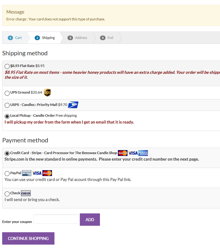

  • Posts: 254
8 years 6 months ago #288051
Before I check with Stripe support I wanted to show you the message since it looks like a typical joomla message.
Is this a joomla message?
  • Posts: 26384
  • Thank you received: 4077
8 years 6 months ago #288052
Here a part of the plugin source code :
		catch(Exception $e)
			$this->modifyOrder($order_id, $this->payment_params->invalid_status, true, true);
			$this->app->redirect($cancel_url, 'Error charge : '.$e->getMessage());
When the Stripe lib generate an exception, the message is retrieve and send to the Joomla error system.
But the source of the message is related to the Stripe payment gateway and the plugin just got the information via the lib to display it.
It's just the messenger !
