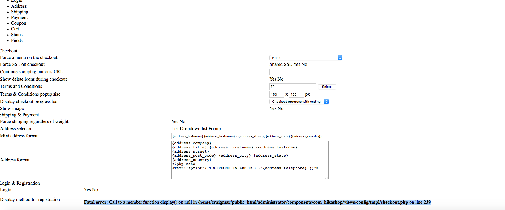

-- Joomla version -- : 3.8.5
-- PHP version -- : 5.6.33
-- Error-message(debug-mod must be tuned on) -- : Under Configuration in the admin panel i get the following error:
Fatal error: Call to a member function display() on null in /home/craigmar/public_html/administrator/components/com_hikashop/views/config/tmpl/checkout.php on line 239
In the administrator area of the website, if i try open the configuration file on Hikashop i get the following error :
Fatal error: Call to a member function display() on null in /home/craigmar/public_html/administrator/components/com_hikashop/views/config/tmpl/checkout.php on line 239.
It seems like the CSS is not loading because of this error, all other page are fine.
