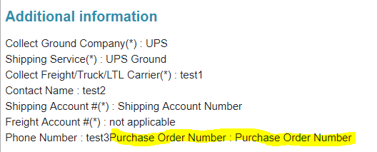

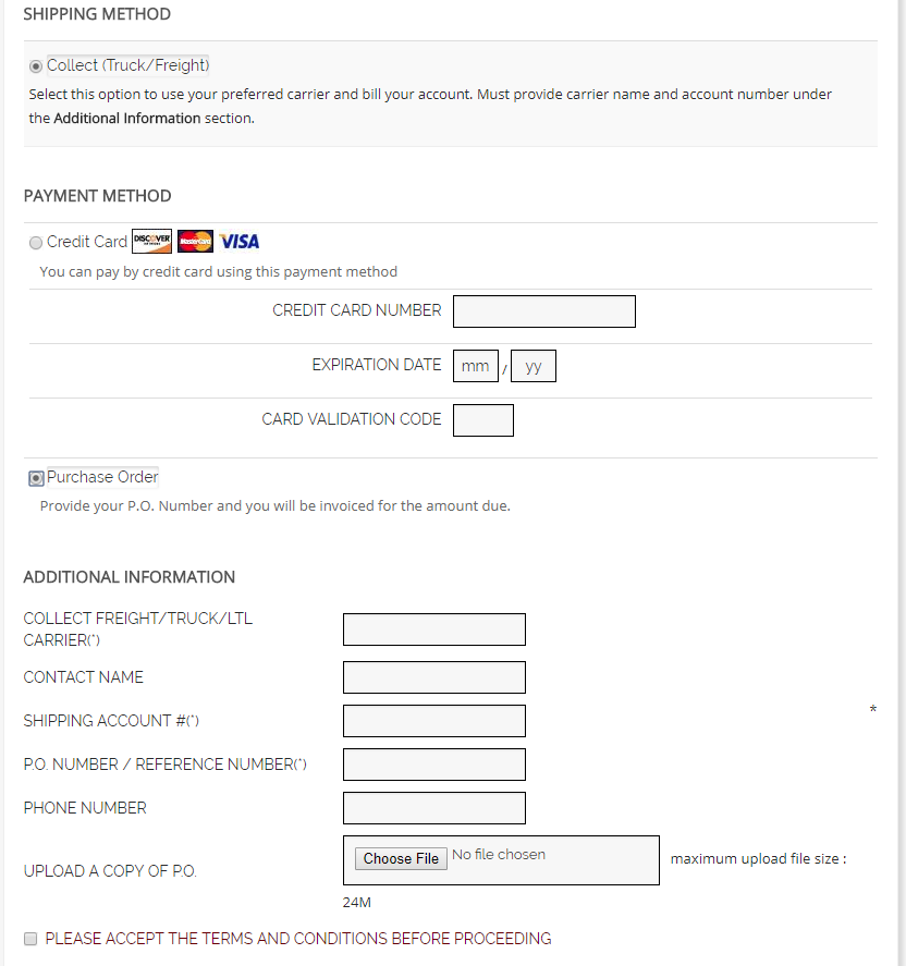

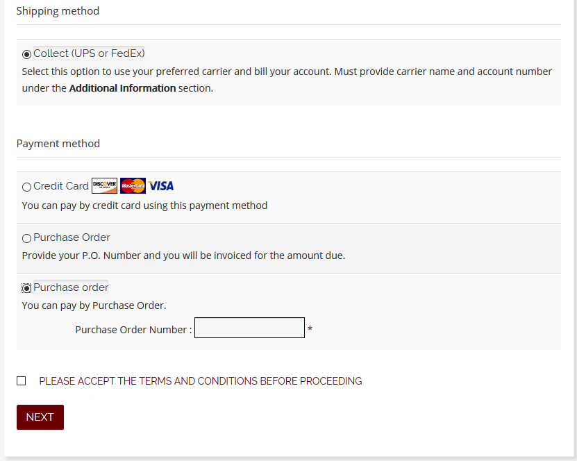

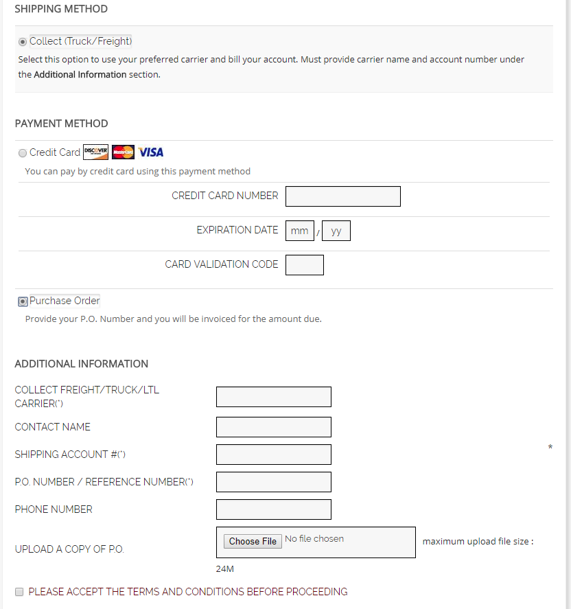

Our webstore was developed with HikaShop [1409241754] several years ago. It had to be customized at that time to meet our requirements. I am trying to upgrade the website to current, and I have lost functionality. I can provide the url for the test environment via PM if needed.
  • ]All of the "Additional information" that can be found in the checkout process (on our current site) has disappeared (on the test site).

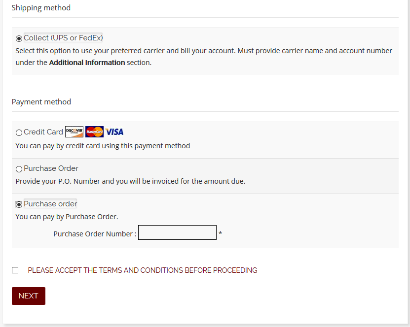

  • I have discovered that there is a purchase order plugin now, and I have added that in. This would remove the Purchase Order Number field in the Additional information area, but I still need the upload option.

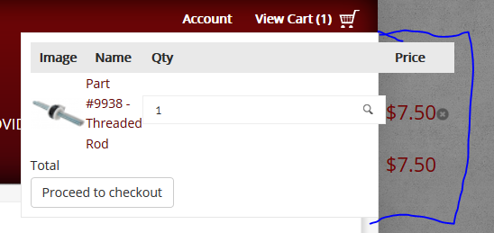

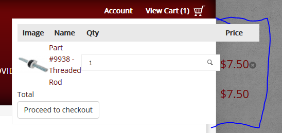

  • "Add to cart" functionality has been lost. Previewing the cart and updating the number when items are added to cart.
  • Turning off Legacy Add to Cart did now allow the cart count to increment. However, I was able to get the count number to increment by leaving Legacy Add to Cart "On" and disabling the "Use AJAX" for add to cart
  • [/ul
    Rambling aside, I would like to use as much default logic as possible, to prevent these issues in the future. I assume it would be best to be able to have all legacy stuff set to "off".
    What I really must have:
  1. Incremented cart counter when add to cart is clicked, not a user forced page reload
  2. File upload for Purchase Orders in the checkout process
  3. Some custom text fields for extra shipping information int he checkout process

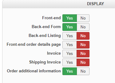

1. The additional information is displayed by the custom field system. Edit your custom order fields via the menu Display>Custom fields and make sure that the new display settings of your custom fields (these settings were added in HikaShop 3.0.0) are configured like you want (checkout display setting activated).
2. Turn off the "add to cart legacy" setting in order to use the new add to cart system. If the cart module is not being refreshed after that. Then either you're not using the default cart module of HikaShop, or you want to rename the file templates/YOUR_TEMPLATE/html/com_hikashop/product/cart.php in order to deactivate the customization made to the cart module.

Per comment 1: This resolved the issue. I had to go in each variable and switch "Order additional information" to Yes.
Per Comment 2: I turned off "add to cart legacy" setting, and the cart module was not being refreshed. I do not know if we are using the default cart module, so I renamed the cart.php to cart_old.php. The cart module is still not refreshing, I do not see a new cart.php created and now when I click on the cart, it looks...broken, see screenshot.

2. You're still using the legacy add to cart buttons as far as I can see.
So if you still have that option turned off, it means that either you have some caching on your pages, or you have some view overrides in templates/YOUR_TEMPLATE/html/com_hikashop/product/ with old code. You'll have to rename the files one by one until you identify the one which prevents the new add to cart buttons for displaying.
Regarding the cart module, on your screenshot, it looks like a CSS issue. We would need a link to the test website where you have the issue so that we could have a look at the situation to tell you why the CSS is messed up. It's probably linked to some CSS in your template.

8 years 6 months ago #288643
There is an issue with what is returned by the server when the AJAX call is sent by HikaShop to the server:
monosnap.com/file/kGG6cEu4b3peKxcsrzs0UaNFfExd3n
Your template is adding javascript to the returned data when it shouldn't
Because of that it messes with the new add to cart system.
I'm afraid you'll have to contact your template provider and check with them because we don't know how they do that or how they customized everything so we can say what should be done.

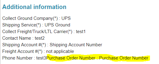

One last thing related to the Additional Information. How do I add the Purchase Order Number from the HikaShop Purchase Order Payment Method to the Order Notification Email? Originally, the Purchase Order Number was an additional information field, and it was added to print in the email. I would like to maintain that, even though I want to switch payment method to use the HikaShop Purchase Order. I am having a hard time figuring out how to add this new variable to the email.
Components > HikaShop > System > Emails > Order Notification
There are three "versions": HTML, Text and Preload. Inside the HTML I found:
<!--{IF:ORDER_SUMMARY}-->
<h1 style="color:#1c8faf !important;font-size:16px;font-weight:bold;border-bottom:1px solid #ddd;padding-top:10px;padding-bottom:10px;">
{TXT:ADDITIONAL_INFORMATION}
</h1>
Which seems promising, but I don't know where or how to modify the ADDITIONAL_INFORMATION or if that is really the correct thing to modify, since the new variable is part of the Purchase Order Payment Method.

8 years 6 months ago #288724
Add the code:
	public function onAfterOrderProductsListingDisplay(&$order, $type) {
		if(empty($order->order_id)) return;
		$database = JFactory::getDBO();
		$query='SELECT history_data FROM '.hikashop_table('history').' WHERE history_order_id='.(int)$order->order_id.' AND history_data != \'\' ORDER BY history_created ASC';
		$database->setQuery($query);
		echo $database->loadResult();
in the file plugins/hikashoppayment/purchaseorder/purchaseorder.php
That will add the text from the history data that you can see in the backend to the email notifications.
Let us know how it goes so that we can include that for the next version of HikaShop.
  • Posts: 7
8 years 6 months ago #288818
Nocolas,
-That code worked, but I would need a new line before it. It has smashed onto the end of the other Additional Information output (see picture).

1 - So you should echo a "<br/>".

1 - This worked.
                echo "<br/>";

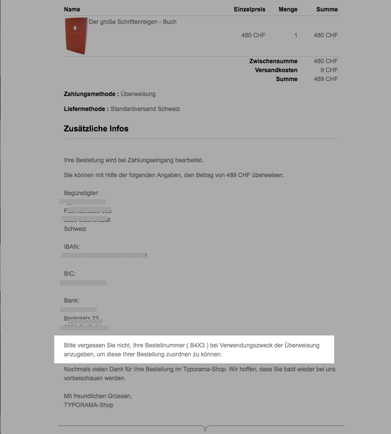

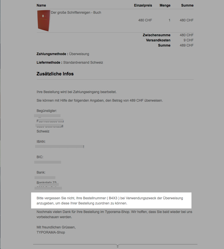

  • Posts: 12
8 years 6 months ago #288957
Hey there,
i don’t know if i’m right here but i’ve a question in this direction.
is it possible to style the colour of a part of payment-information?
In my case i want to highlight the parameters which let me find the correct
order to the purchase via bank-account.
maybe you understand my question better when you look on my screenshot.
I want to have only the highlighted part in a red colour for example.
Better both – in email and on the confirm-site after checkout.
Where can i find the code to customize it?
Thanks a lot for your help and sorry for my bad english…
