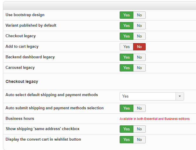

  • Posts: 22
8 years 6 months ago #288750
Here are my settings and it STILL is not working... I need some serious help here man. I'm loosing money becasue of this problem.
Please try it for yourself on my site: www.ucanfixit.ca/index.php/browsemanuals...272147-repair-manual
Last edit: 8 years 6 months ago by ucanfixitca.

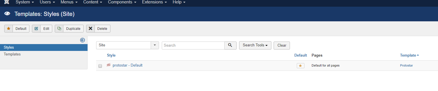

  • Posts: 22
8 years 6 months ago #289157
This is it though man... I don't have any other templates installed! See below:
