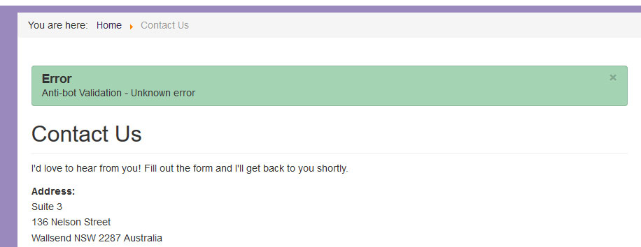

After the Hikashop update the form ReCaptcha on the contact page show error 'Anti-bot Validation - Unknown error'. If I deactivate Hikashop ReCaptcha v2 the contact form ReCaptcha works as it should.
For the moment I have had to disable the Hikashop ReCaptcha v2 so the contact form can work.

I have attached an image of the error message that shows when the Hikashop ReCaptcha v2 is activated. I can provide you with a login so you can login and activate to test.

Please edit the ReCaptcha plugin setting (in Joomla plugin manager) and just deactivate the "use in contact form".

I set the 'use in contact form' to 'NO' and it is now working. I was checking the other Re-Captcha where there was not options for any settings. It must have changed with the last update.
