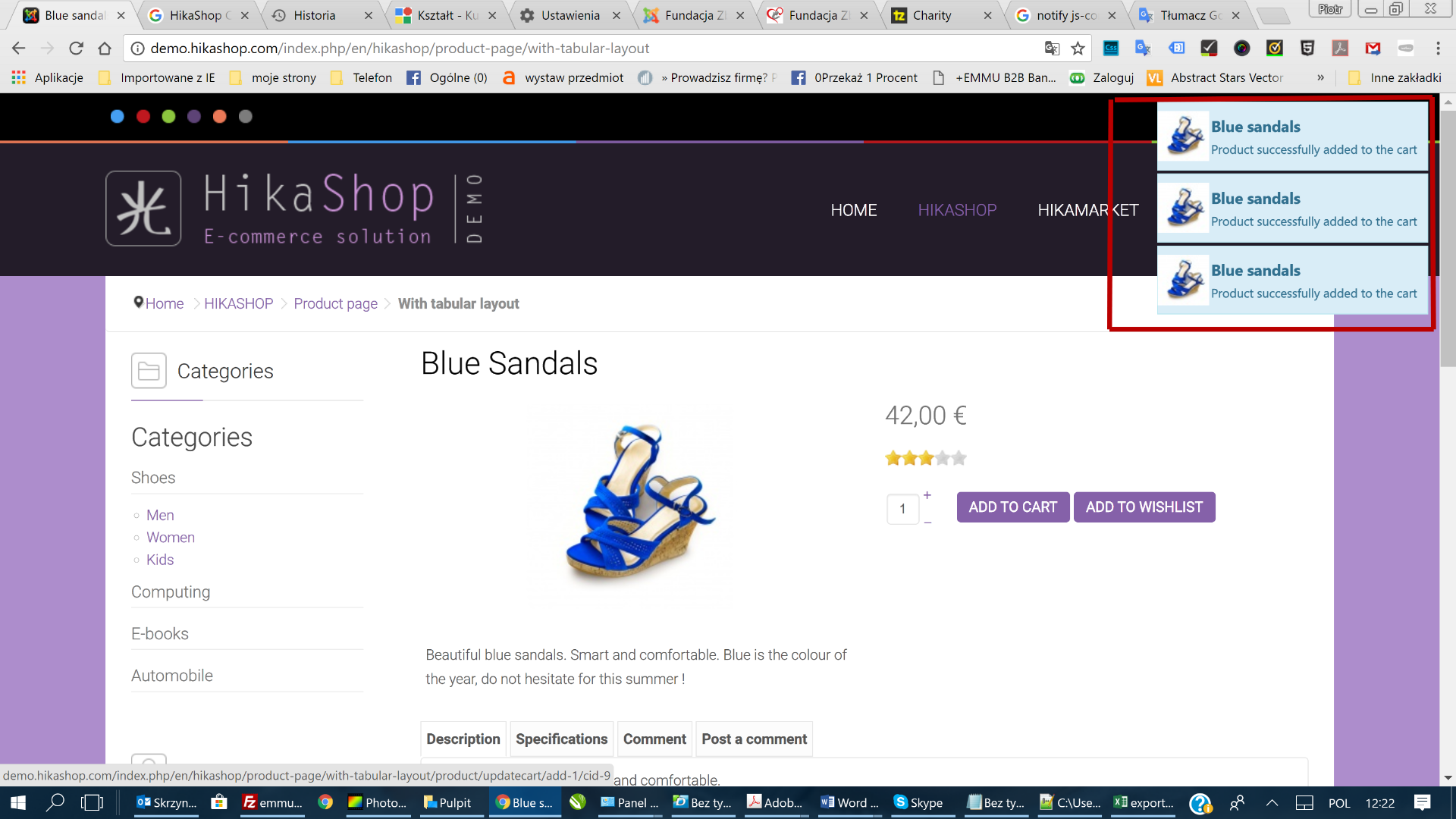

I warmly welcome.
When adding to the cart I would like to have a pop-up window like in the picture.
I do not know how to set it.
Regards.

8 years 6 months ago #289384
In the Joomla backend -> Extensions -> Plugins look for the "HikaShop Add to Cart notification Plugin".
Make sure it's enabled and configured to your liking.

  • Posts: 26384
  • Thank you received: 4077
8 years 5 months ago #289392
The thing is, you're use the "legacy" add to cart system.
The plugin is only working when you're using the new add to cart system (added in HikaShop 3.0).
www.hikashop.com/support/documentation/5...html#advanced_legacy
www.hikashop.com/home/blog/357-hikashop-3-0-beta.html

  • Posts: 86112
  • Thank you received: 14209
8 years 5 months ago #289459
You want to have the "add to cart legacy" setting activated. Then, the plugin should display the popup notifications like on our demo website.
If you have an issue with the add to cart buttons not working that way, then there must be some issue with your template and the way it customizes the view displaying the add to cart.
In that case, switch temporarily to the default template of Joomla and see if that helps. If so, then you'll have to rename some of the files in templates/YOUR_TEMPLATE/html/com_hikashop/product/ to make it work. You can rename them one by one to find out which one(s) are creating the problem.

  • Posts: 8
8 years 5 months ago #289569
As you wrote, I changed the settings to Joomla standard templates and the pop-up window does not work. You wrote that this is due to the fact that hikashop was updated from an older version that did not support the function. And so it is.
How to do to solve this problem or uninstalling the current version of hikashop and reinstalling it will fix the problem?
100% this file "quantity.php" causes problems. my level of php knowledge is weak, I do not know where the error is. Please help me attach the entire php code of the file.
code removed. Please be sure that the support team have access to the HikaShop source code

  • Posts: 8
8 years 5 months ago #289600
Hello.
The popup window works on standard Joomla templates. It helped uninstalling the plugin and reinstalling Hikashop. But it still does not work on the Tz_charity template which is the default for my website.
I discovered the reason is the quantity.php file included in my template. I do not know how to fix it because my knowledge of php is poor.
zbieramyrazem.org/sklep/product/174-chwila-rado%C5%9Bci.html#
in the attachment file I changed only the distinction to .txt
Piotr
  • Posts: 86112
8 years 5 months ago #289607
That's a really old quantity.php file from the 2.6.0
I would recommend to just rename that file in your template to remove the override on it so that you use the default view of HikaShop.
Otherwise, I'm afraid you'll have to contact your template provider so that they can update their template view override to the new version of it from the HikaShop 3.x series.
