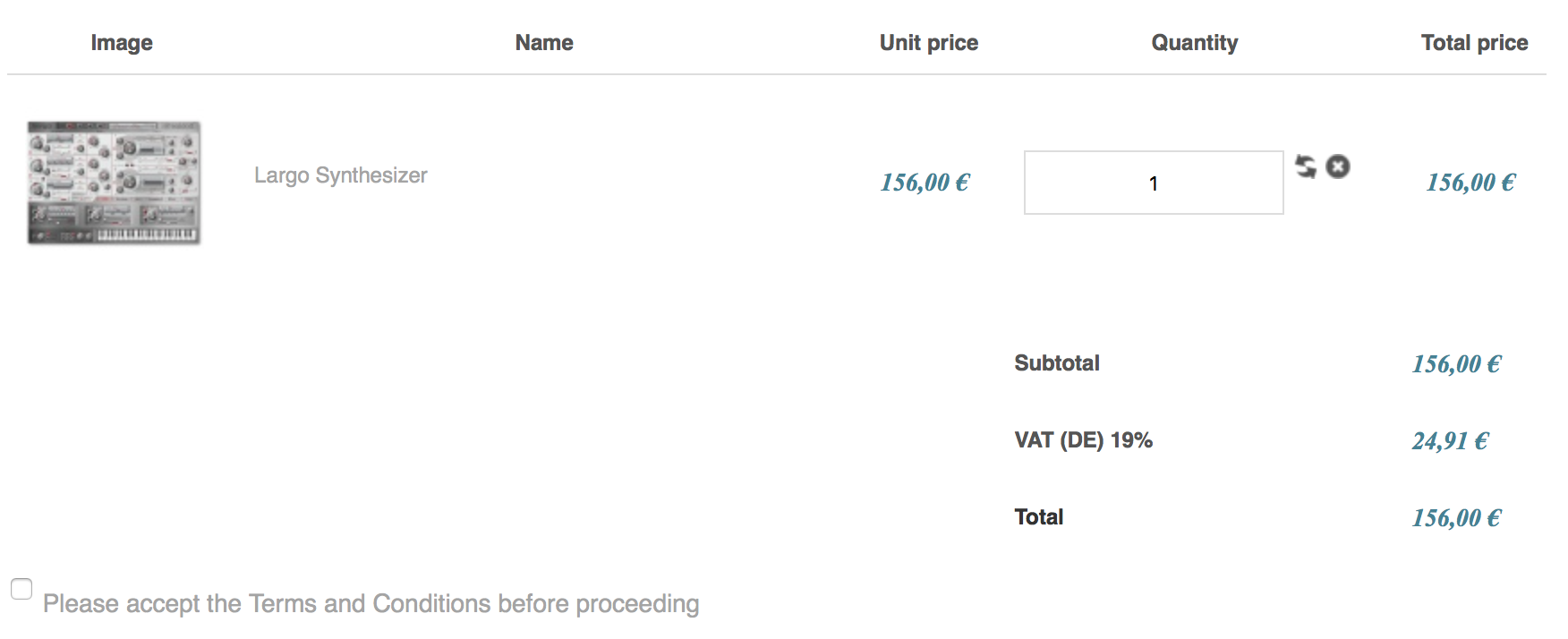

-- Joomla version -- : 3.8.3
-- PHP version -- : 5.5.38
There is a problem with coupon calculation.
Apply discounts is set to before taxes.
The coupon is calculated good but on the total sum the discounted amount is still taxed.
If I switch from coupon to discount, it seems to be working well but going back to coupon it is the same problem!
On the pic below the tax is DE 19%.
Coupon value 10%.
Last edit: 8 years 4 months ago by besar.

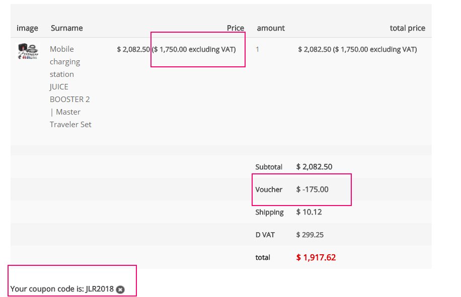

8 years 2 months ago #294887
I have the same problem wit 3.4.1
Looks discount calculates taxes correct, but coupon doesn't.

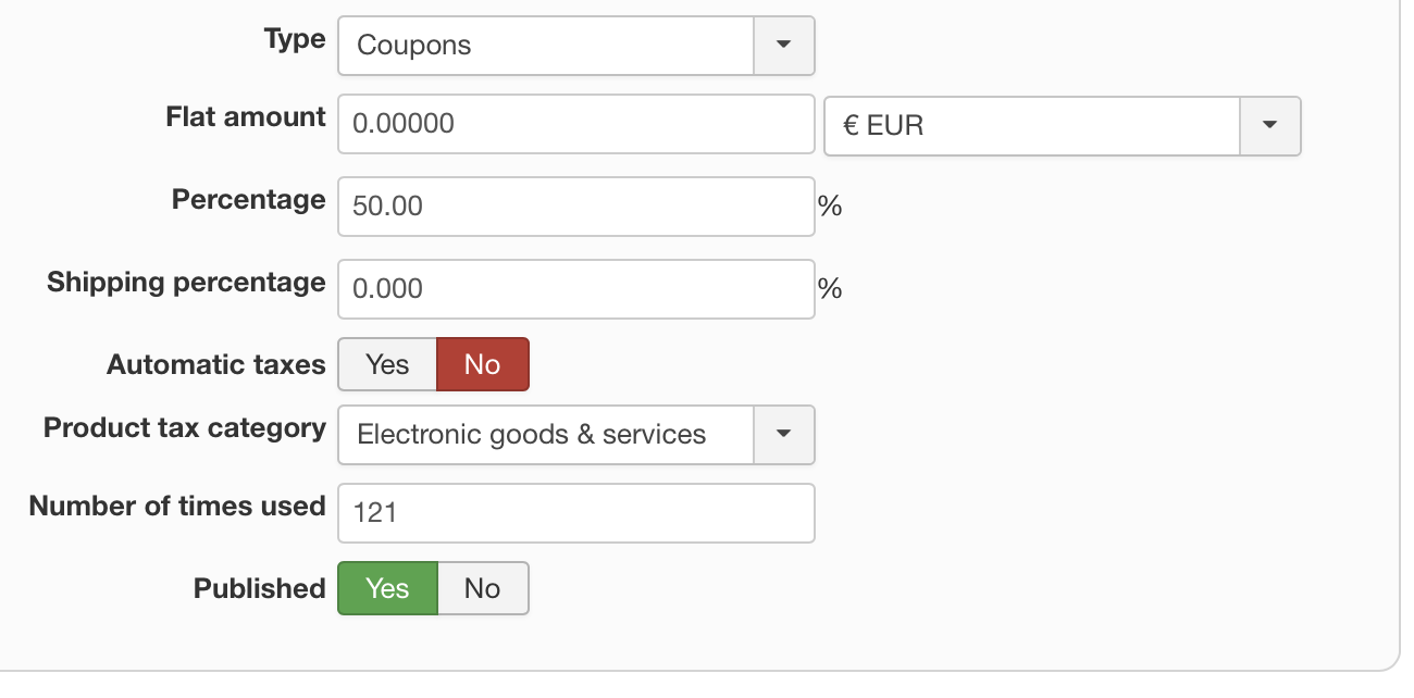

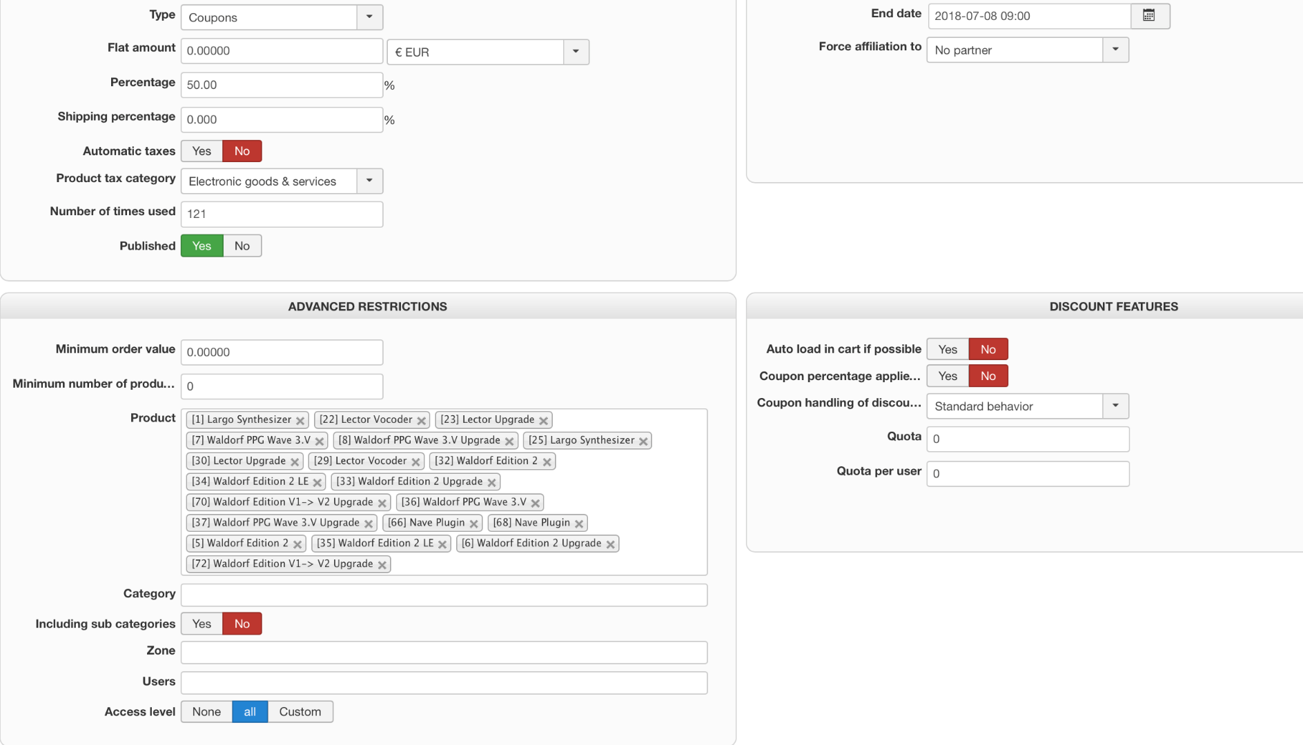

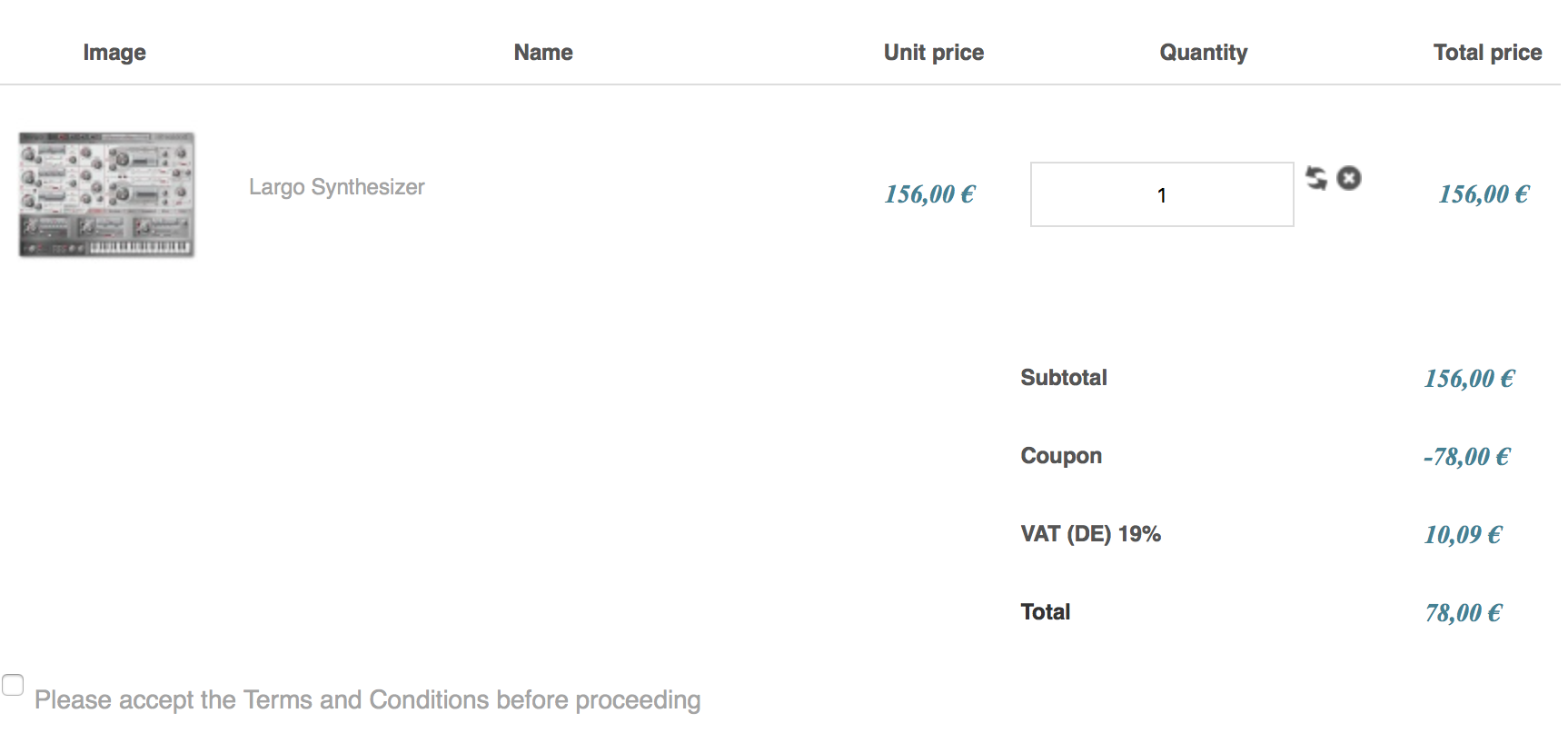

I attached 4 screen shots to show the problem.
Hope you can help, because I just corrected over 100 invoices...
Roger
  • Posts: 86112
  • Thank you received: 14209
8 years 2 months ago #294919
I see that you selected the "Electronic goods and services" tax category in your coupon. Did you configure tax rules for that tax category ?
Also, you might want to try switching the "apply coupon" setting of the HikaShop configuration. Based on that setting, HikaShop will either used the taxed or the untaxed amount for the percentage value calculation.

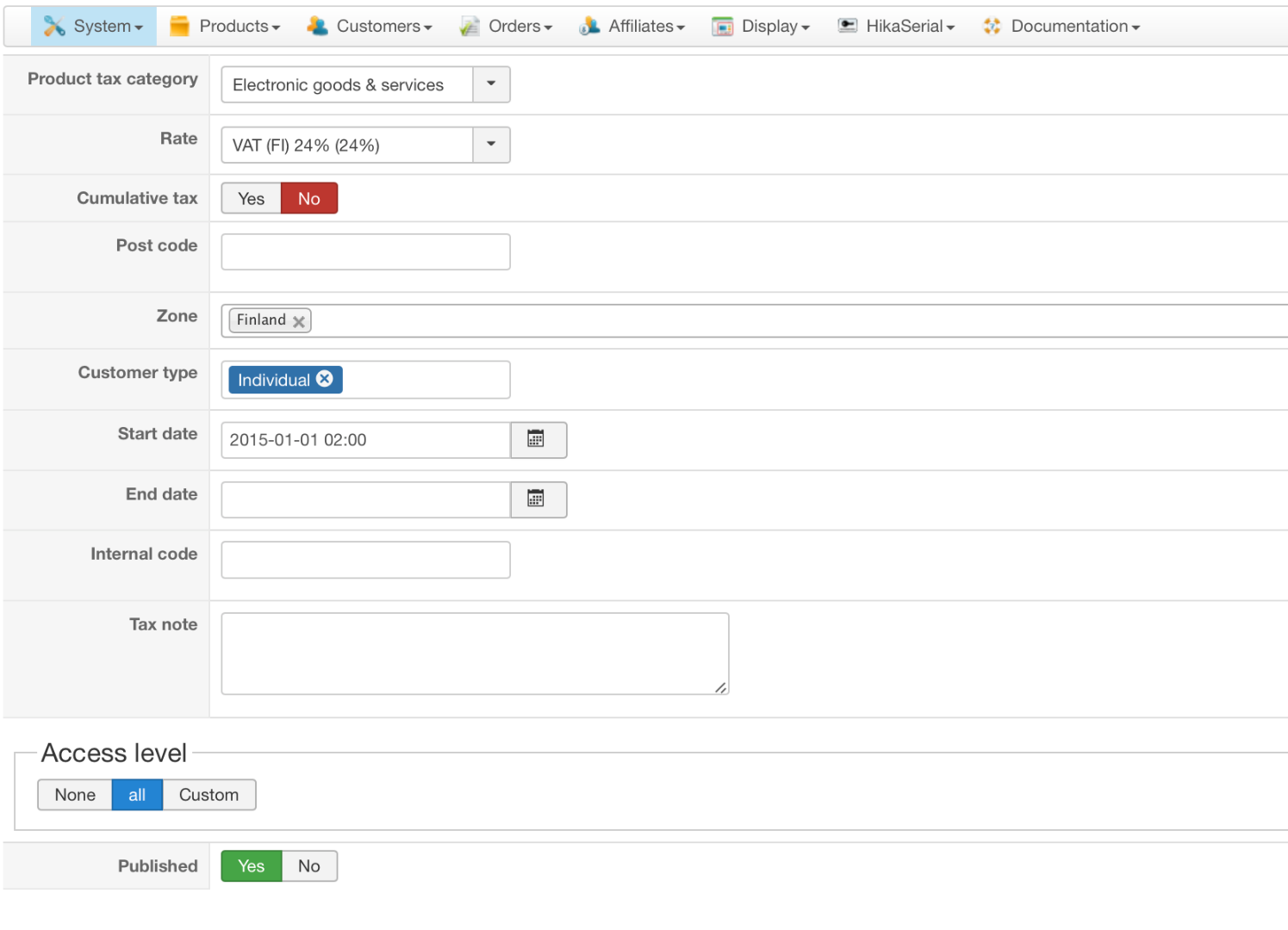

  • Posts: 86112
8 years 1 month ago #295644

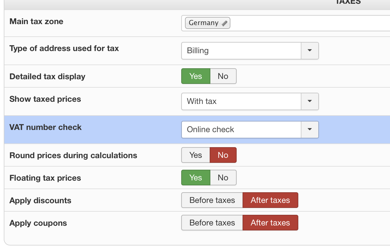

Go in the menu System>Taxes, edit your tax rule and provide a screenshot of the settings there.
  • Posts: 159
8 years 1 month ago #295673
OK, I use the taxes for 'Electronic goods and services'. There are plenty. Here is one:
  • Posts: 86112
8 years 1 month ago #295760
Could you try activating the "automatic taxes" setting of the coupon and if that doesn't help, also change the "apply coupon" (or "apply discount" if you are still on HikaShop 3.4.1) ?

The issue is with the "floating tax prices" option which causes some issue with the tax calculations for coupons.
I've added a patch on our end for that.
Download again the install package on our website and install it on yours to get the patch and it should then display a correct tax amount even with a coupon added.
Note that I see that you're using the old checkout system of HikaShop 2.x. I would recommend switching to the new checkout system which is much better. You can do that by turning off the "checkout legacy" setting of the HikaShop configuration.

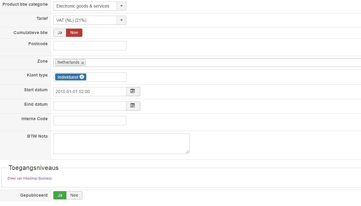

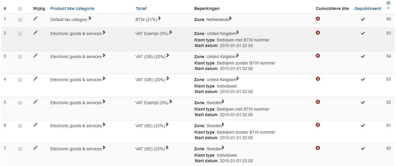

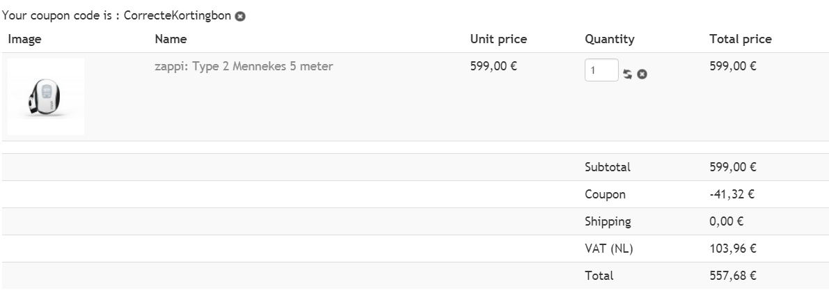

  • Posts: 7
7 years 11 months ago #298389

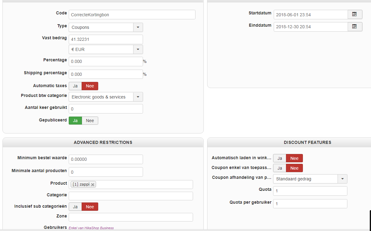

The coupon code is : CorrecteKortingbon
The link to the product is: www.zappi.info/en/shop/products/product/1-zappi
Once you have selected the product and then activate the coupon code in the checkout, you see that the amount is only decreased by 41,32 and not 50 euro. Also there is no decrease of the VAT.
See attached screenshots as you've asked for.
