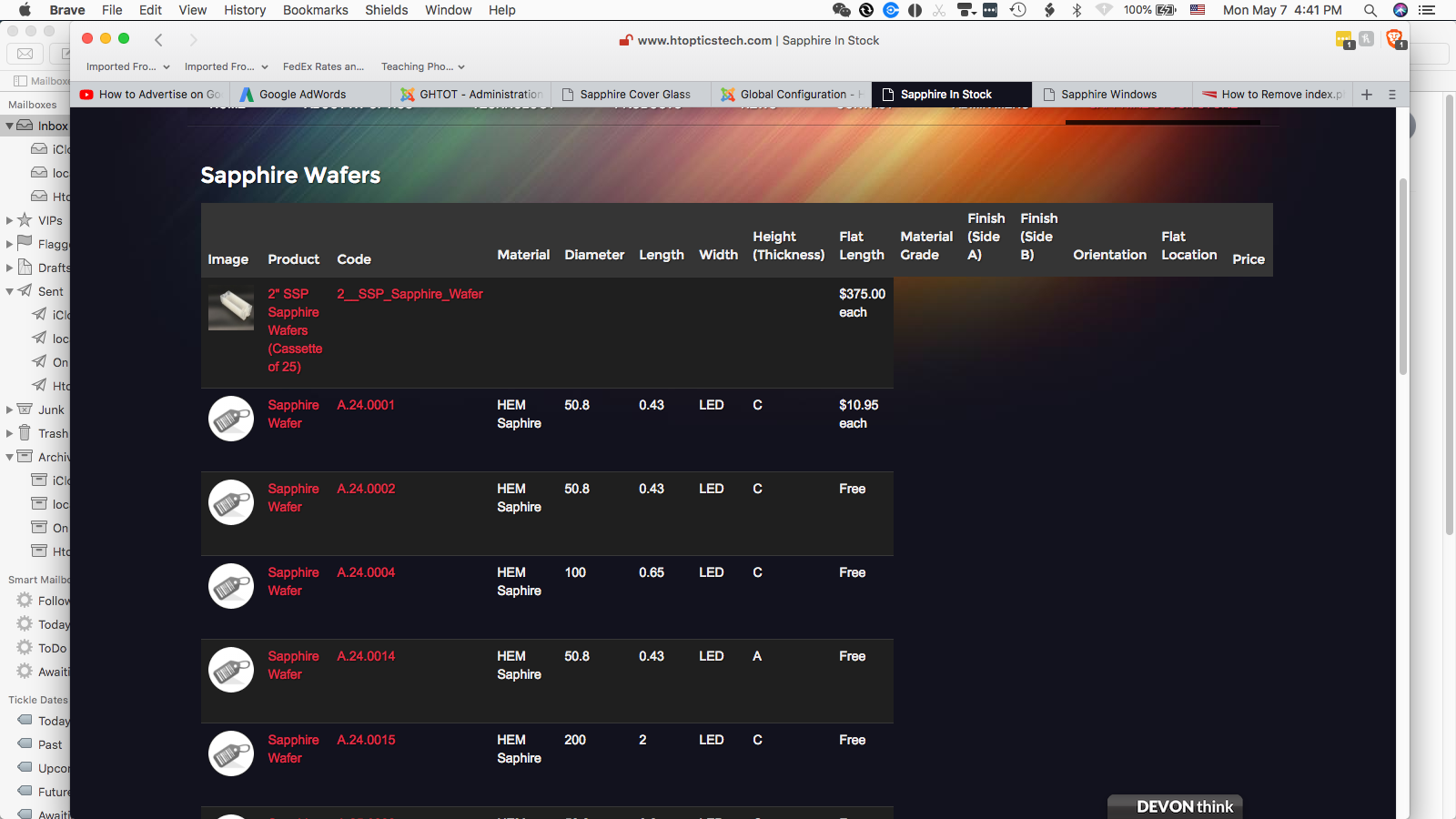

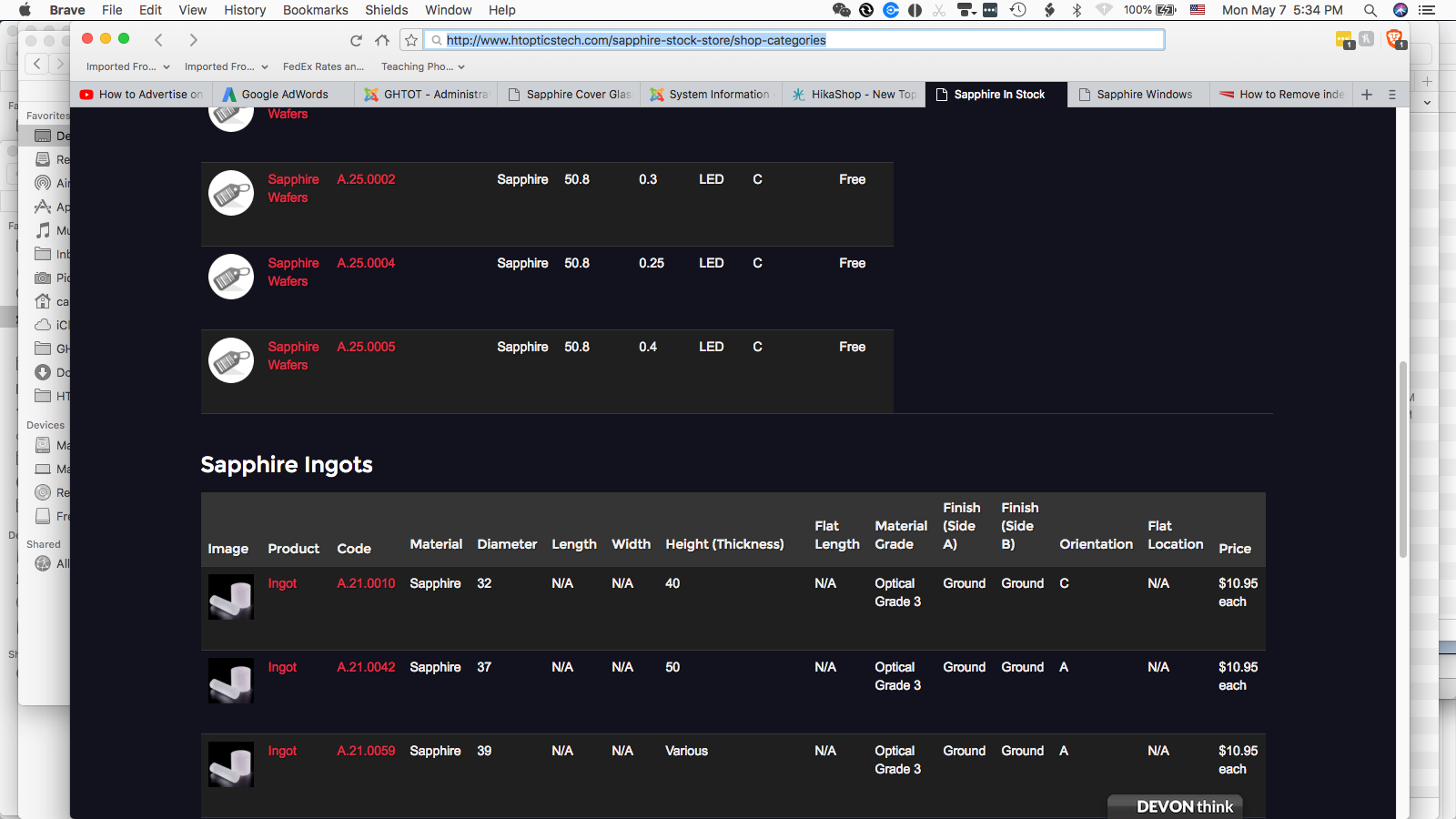

When I display some products the product data is showing in the wrong columns. It almost seems like when a product does not have data for a specific column then the columns are collapsed so they are not aligned with the column headings.
See attached pictures
I have verified that the data is in the right fields

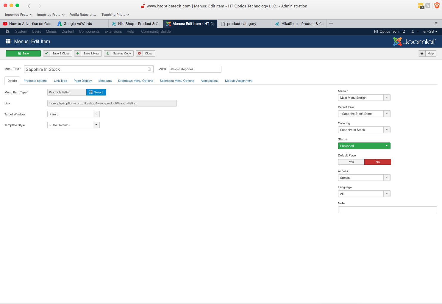

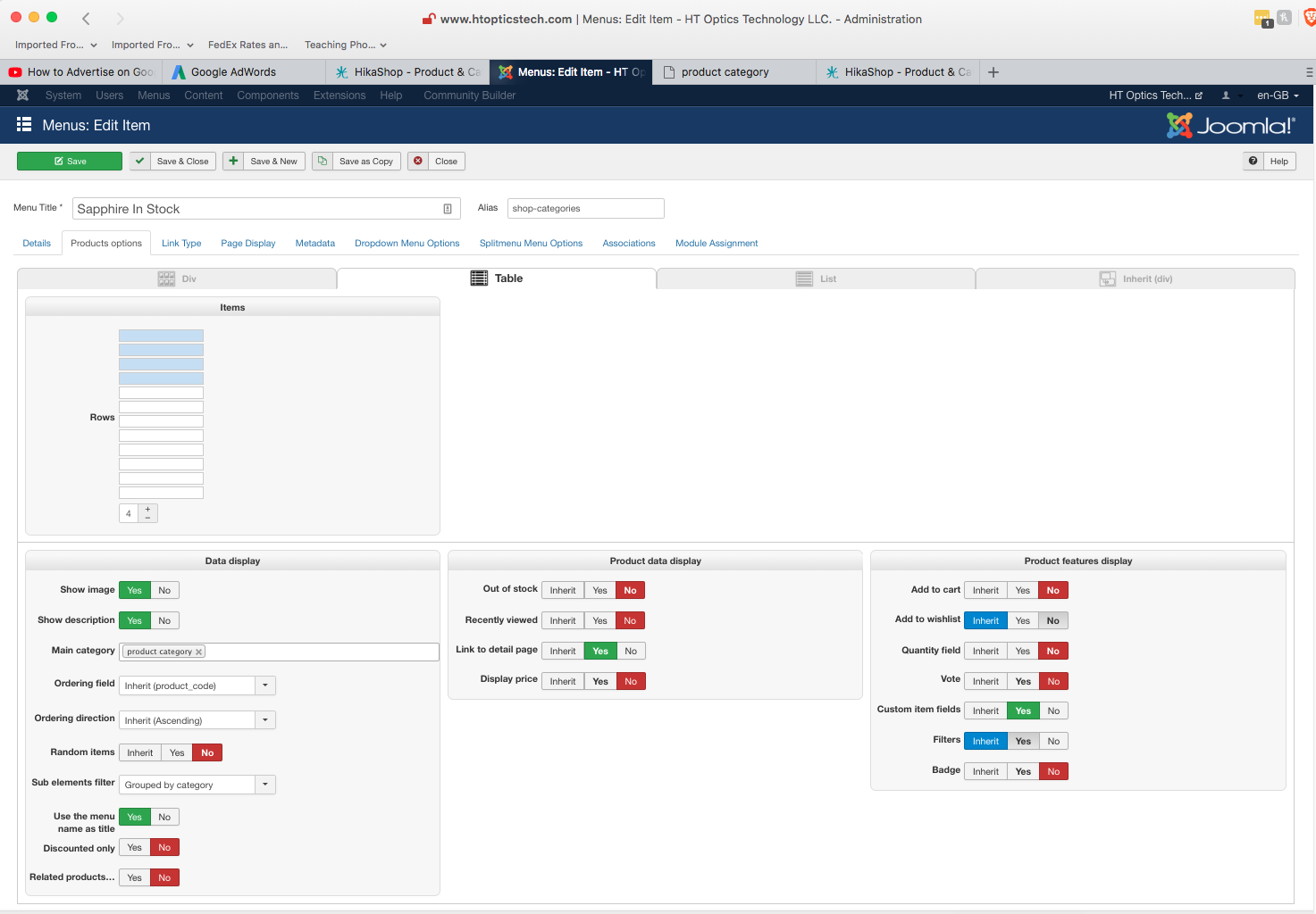

Can you show us screenshots of how you configured your product listing content menu so that we can eventually reproduce it on our end ?
Thank you.
  • Posts: 4
8 years 4 months ago #292402
Please see attached.
