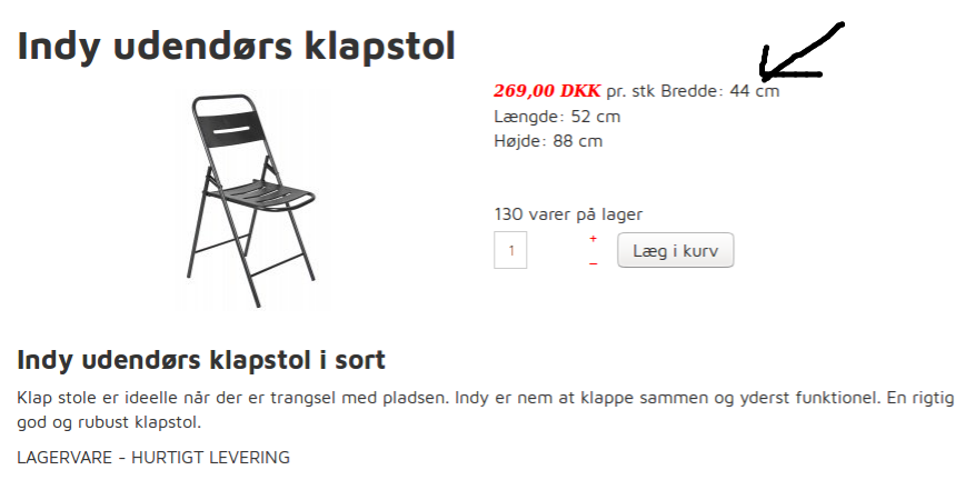

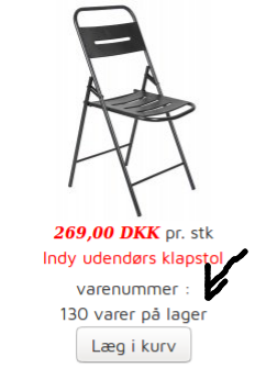

I get this view but no code
Then i want to add the product_code_SKU to the product, but cant find the file that i have to edit?
Hop you can lead me in the direction?

You have the line:
<?php if ($this->config->get('show_code')) { ?>
Which means that the product code will only appear if you turn on the "display product code" setting of the HikaShop configuration.
You could replace that line to:
<?php if (true) { ?>
to have it appear regardless of that setting.

  • Posts: 145
8 years 4 months ago #292570
IT is SOLVED
Used the product_block_img
Best regards
Brian
