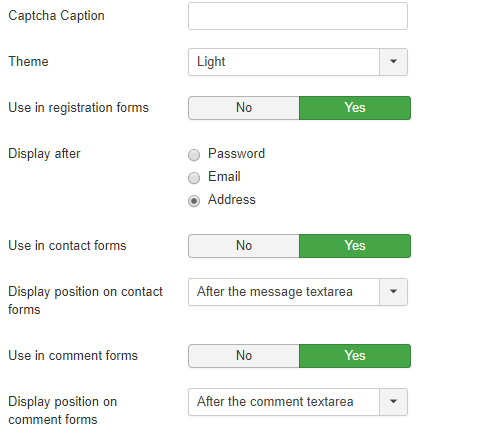

I have installed the Hikashop "recaptcha_on_registration" plugin but it doesn't show when I use a menu item to show the Hikashop registration form.
In the plugin settings, I have enabled all the relevant options.

Can you provide a screenshot of the settings of the plugin ?

I send you a capture of the plugin settings:

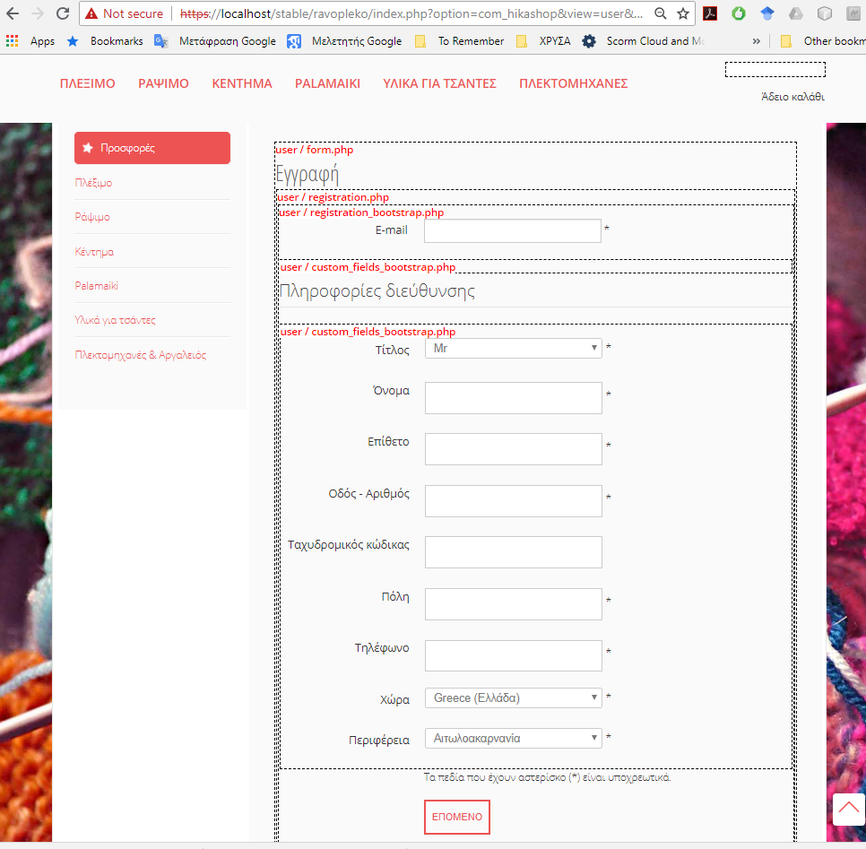

The plugin is working fine in cart checkout. It doesn't work when I use a menu item for hikashop registration form.
See following screenshot:
I'm sorry but I run it on localhost, so I can't provide a direct link!
The same happens with default Joomla template.
Thank you,
Yannis

Then please try to turn off the "use bootstrap design" setting of the HikaShop configuration.
Also, I would recommend updating to the latest version of HikaShop. That will probably help.

Hello, I turned off the bootstrap design but wasn't fixed.
Probably it's a bug because captcha displays properly on checkout page.
Can you please look at this?
Thank you
