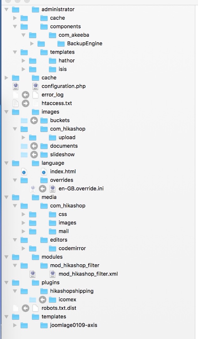

Well, I downloaded the misbehaving development site and then compared its files to a freshly installed joomla site with matching installations of hikashop, template, Akeeba tools and JCE editor.
Attached is the comparison, which at first glance doesn't seem to differ in any areas which might cause an issue like this. Mostly artwork, template and normal customization. I don't know how our custom shipping plugin would interfere with forms like the login, but disabling it made no difference.
All my other customizations were thought Hikashop interfaces except CSS which I handled through the template's style interface.
I even compared the .htaccess files, but there were no differences, and emptied every cache I could.
I'm still stumped.
