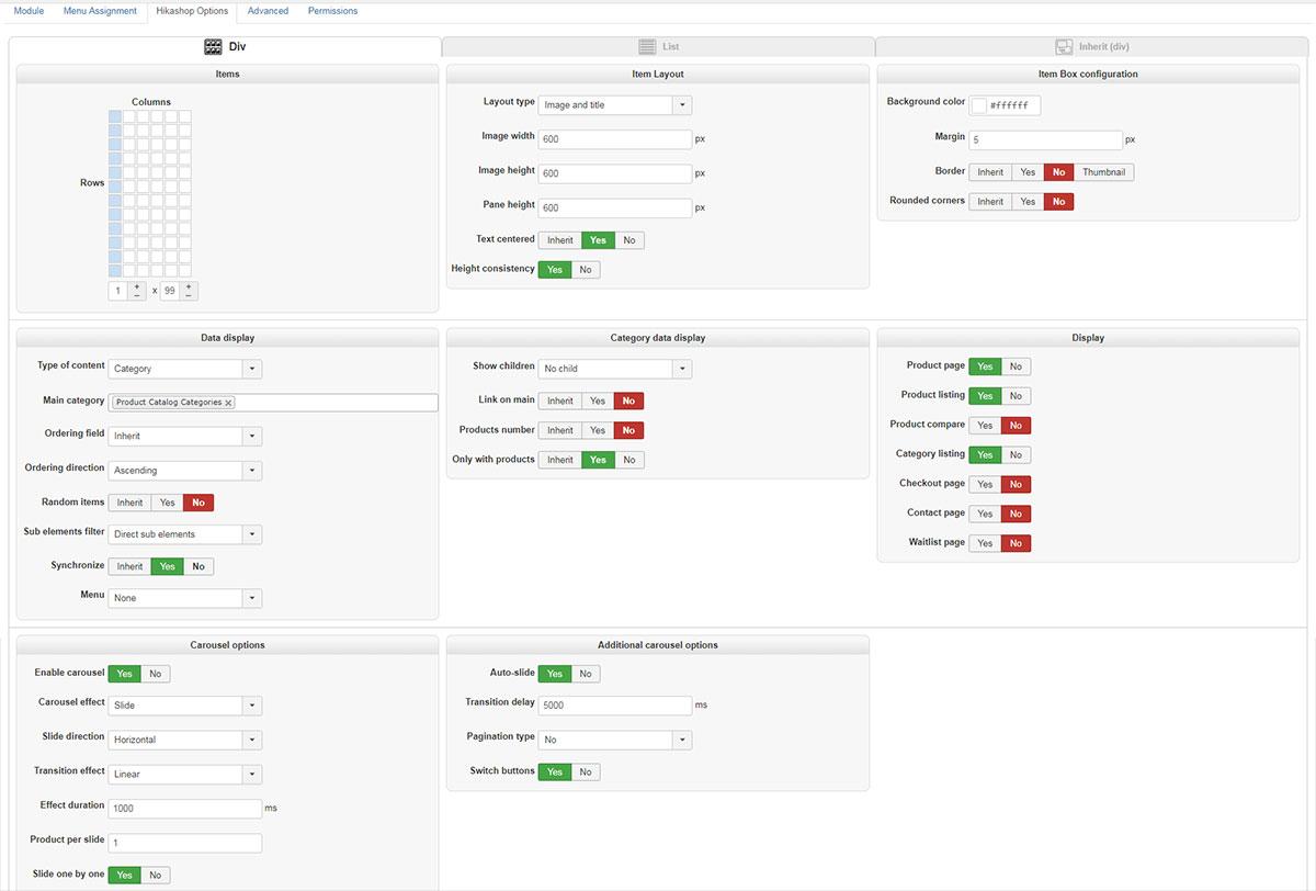

I am trying to configure a HikaShop Content Module to perform the following functions:
1) Display categories in a slider (1 category per slide)
2) Clicking on a category slide displays all products under that category
I have achieved function #1
I am having two problems with function #2
First problem: When I click on a category slide, then all its subcategories are displayed in the slider (also displayed 1 category per slide)
Second problem: When I click on a category (a category that has no sub categories) in the slider, instead of displaying all products in that category, nothing is displayed at all.
The first problem is not critical.
Obviously, the second problem is critical. I have tried to determine if I have problems in configuration, but I have had no luck there. Screenshot of module configuration attached.
Any help is greatly appreciated!

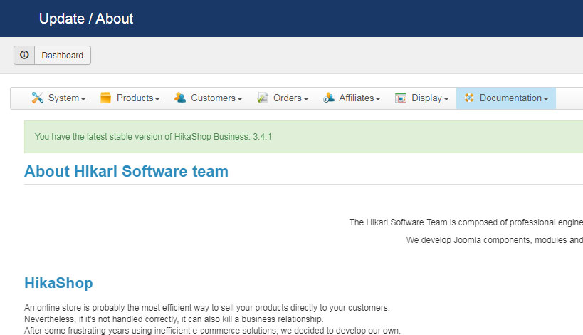

7 years 11 months ago #294954
In the admin panel, the Hika "About/Update" page indicated that 3.4.1 was the latest version.
But I re-downloaded HikaShop Business (v3.5.0) and installed it, this did not resolve the behavior.
Last edit: 7 years 11 months ago by Bold.

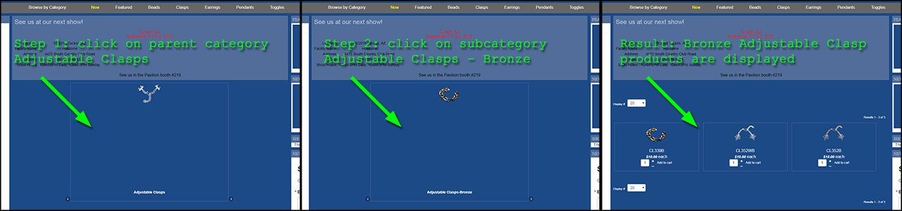

  • Posts: 5
7 years 11 months ago #294996
From the accordion menu on the left, if you click on
Adjustable Clasps > Adjustable Clasps - Bronze
Then a list of Bronze Adjustable Clasps is displayed in the component
(with a URL of mywebsite.com/hikashop-menu-for-module-184/category/305-ajustable-clasps-bronze)
From the Hika slider on the test page, if you click on
Then nothing is displayed in the module
(with a URL of mywebsite.com/hikashop-menu-for-module-219/category/305-ajustable-clasps-bronze)
The desired behavior is NOT to have the products displayed in the slider
The desired behavior is to have a list of Bronze Adjustable Clasps displayed in the component (or module), like this:
Are you saying that this behavior is not possible?
  • Posts: 85727
  • Thank you received: 14056
7 years 11 months ago #295044
It is. You should select the menu item with the alias "hikashop-menu-for-module-184" in your slider module's "menu" setting under its "hikashop options" tab via the Joomla modules manager.
That way, when you click on a category in the module, you'll get the same page as if you go through the sidebar.
  • Posts: 5
7 years 11 months ago #295090
Perfect! Thank you all for your help!
