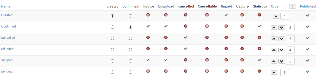

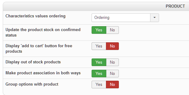

7 years 9 months ago #297710
I tested what you suggested but something is not working for me.
I have "Update the product stock on confirmed status = YES". The stock was NOT updated because the status did not change to confirmed but the orders were paid for. The orders that are paid for are still showing the status as "Created".
Please kindly tell me how to get it to work this way and what I need to change, etc...
I would like the stock to be updated ONLY after payment is made, because customers don't always pay. Otherwise I will have to update the stock manually each time they don't pay.
I don't have any custom statuses.
Please see attached settings.
Thank you.

  • Posts: 85727
  • Thank you received: 14056
7 years 9 months ago #297726
Then the problem has nothing to do with the order statuses or the settings in the configuration.
This indicates that the payment plugin you're using is not receiving the payment notification from the payment gateway you're using.
That's a common issue with many payment methods. We've made a specific documentation you can follow regarding that issue for PayPal here: www.hikashop.com/support/documentation/i...or.html#notification
Note that most of the points there also applies to other payment methods.

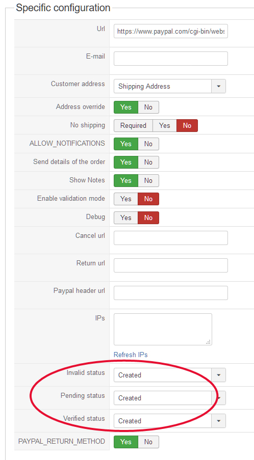

7 years 8 months ago #298214
Attached are the configuration of Paypal.
Do I need to change any of the items circled on the attached to make it work? Does my settings look ok?
I just want to make sure before I contact Paypal.
Thanks!
  • Posts: 26355
  • Thank you received: 4068
7 years 8 months ago #298222
You might want to use the default settings for these.
So an order will become "cancel" when an invalid notification comes.
So an order will become "pending" when a pending notification comes.
So an order will become "confirmed" when a verified notification comes.
