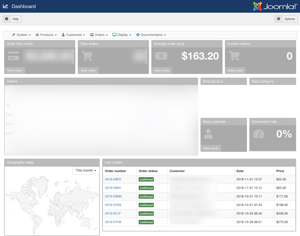

The below image should show two (2) current orders as today is 1 Nov but it is showing '0'.
I am having this issue with several Hikashop installs.
This site does not show any current orders and the other site order status does not seem to be consistent with the actual orders (but I cannot verify it because each time I look, the current orders are also '0').

  • Posts: 86112
  • Thank you received: 14209
7 years 10 months ago #299960
No, it doesn't require the cron.
Note also that if you don't have the "created" status enabled under the "statistics" column, the dashboard will base its calculations on the creation date of the invoice. So if you don't have the "confirmed" status enabled for the "invoice" column, it could explain your situation as you wouldn't have any invoice creation date for the orders even though they are confirmed.
So please check on that.
I personally check the situation on my end and as soon as I had an order confirmed, it was counted in that "current orders" count.
And this is with the default statuses that are present when HikaShop is installed.

  • Posts: 293
  • Thank you received: 9
7 years 10 months ago #299967
More Info:
Notice on the screenshot a few posts back, that there are NO STATS at all?
No, Best Product, Best Customer, Best category?
Again, this is using the DEFAULTs in Hikashop.
But as soon as I turned on Created as one of the selected Statistics, that is now generating the rest of the statistics.
So it seems that there may be some default items that are not quite right.
