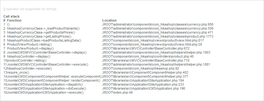

attached is a screenshot of the full call stack, hopefully it can provide some additional insight into the problem.
If we print the variant_ids they appear normal to us, for example: 220,221,222,223
However, if we print $products[$k]->variant_ids[] it appears the first element is null/empty and we think this is the cause of the error, because it falls through the check on line 954 since it is set, only null, and so on line 956 you assume it is an array while it is not, thus causing the error.
