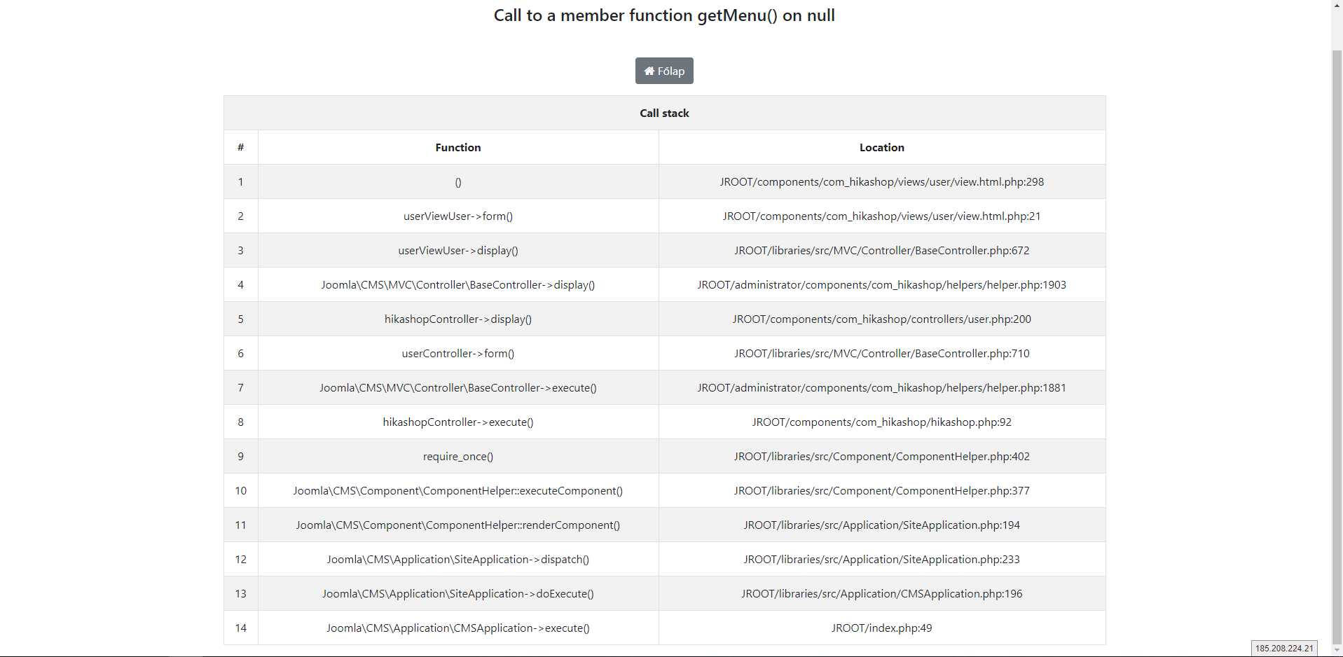

-- Error-message(debug-mod must be tuned on) -- : Call to a member function getMenu() on null
HI there!

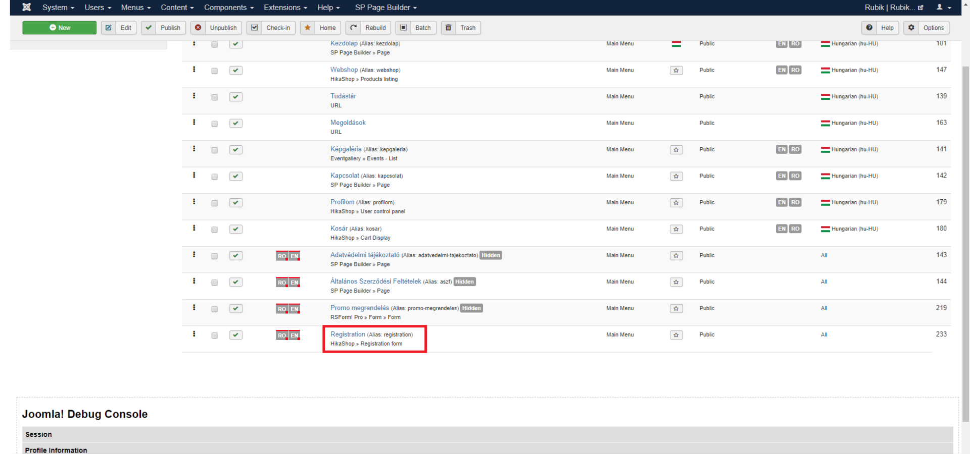

We got some serious problem with registration form: If we choose a Hikashop Registration form menu type, then the following problem occured.
It's also a problem when we do a clean install. None of the Registration form Menu item working at all.

We activate the first time too, but i ptr sc for u. We try the update and clean install, but the problem is same.

Thank you. We've added a patch for that error. Please download again the install package on our website and install it on yours and that will add the patch and remove the problem.
