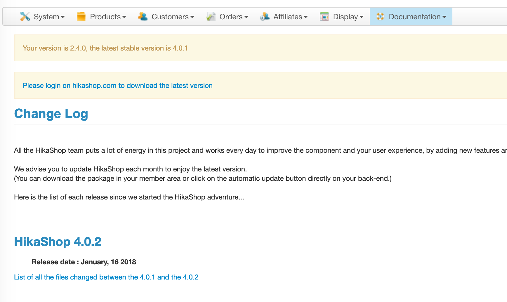

I have just taken over a website with Hikashop installed. It's on an old version number, but it doesn't say what version of Hikashop it's using, ie starter, essential or business...
I have attached a screenshot so that you might be able to help me tell.

  • Posts: 86112
  • Thank you received: 14210
7 years 7 months ago #303564
Turn on temporarily the "show footer" setting of the HikaShop configuration and you'll see the edition name at the bottom of each page displayed by HikaShop.
Note that with HikaShop 3.x and forward, the first setting of the HikaShop configuration is actually the edition and version of HikaShop you have so once you update, you'll be able to easily know which version you have at any time.

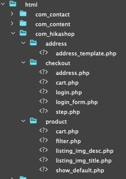

  • Posts: 82
  • Thank you received: 6
7 years 5 months ago #304721
Thanks for your reply - I appreciate the help you are giving me on this.
I don't have that file in my html. I have added a screenshot of the com_hikashop directory so you can see what's there. There is no category folder.
Duncan

  • Posts: 86112
7 years 5 months ago #304722
Then I'm not sure what is the problem.

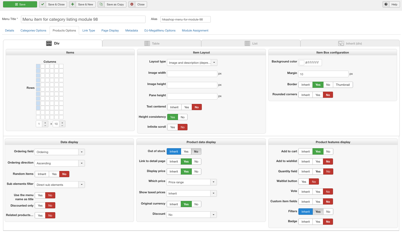

  • Posts: 82
7 years 5 months ago #304846
Screenshot of menu item/product options attached.
Duncan
DunxMax
The more we learn the less we know.
Last edit: 7 years 5 months ago by dunxmax.
  • Posts: 86112
7 years 5 months ago #304851
The settings look good and it's not an override, so I don't know what it could be.
Please provide a backend access, a FTP access and a link to this thread via our contact form so that we can have a look at the situation directly on your website.

7 years 5 months ago #305291
I was just doing final testing before I apply the update to my live site, but discovered an issue, and just need a bit of advice on how to solve. I'm sure it's not too big a problem.
On each page I have a cart module.
I can see that when I add a product to the cart I get an small box that flashes up to say the product is added to the cart, but what's not happening at the same time is that my cart module is not being updated. The module only updates when I refresh the browser, ie it's not doing updating automatically.
I tested the live site with the old version of Hikashop and the module does update automatically.
Is there a setting somewhere I need to change to make sure the cart is updated when a product is added.
Test site is here: ukm10.siteground.biz/~conforma/shop-test/
As always very grateful for any help.
D
DunxMax
  • Posts: 86112
7 years 5 months ago #305303
You're missing the javascript code of the cart module which handles the refresh of itself. I suppose that you have a view override of the cart module from an old version of HikaShop.
Check if you have the file templates/YOUR_TEMPLATE/html/com_hikashop/product/cart.php via FTP and if you do, rename it. It should then work properly. You can always redo the view override on the new version of that view file via the menu Display>Views in order to add your customizations to the cart module.
  • Posts: 82
7 years 5 months ago #305616
Finally got round to looking at this. You are right. I renamed the cart.php and the cart now updates.
Thanks very much.

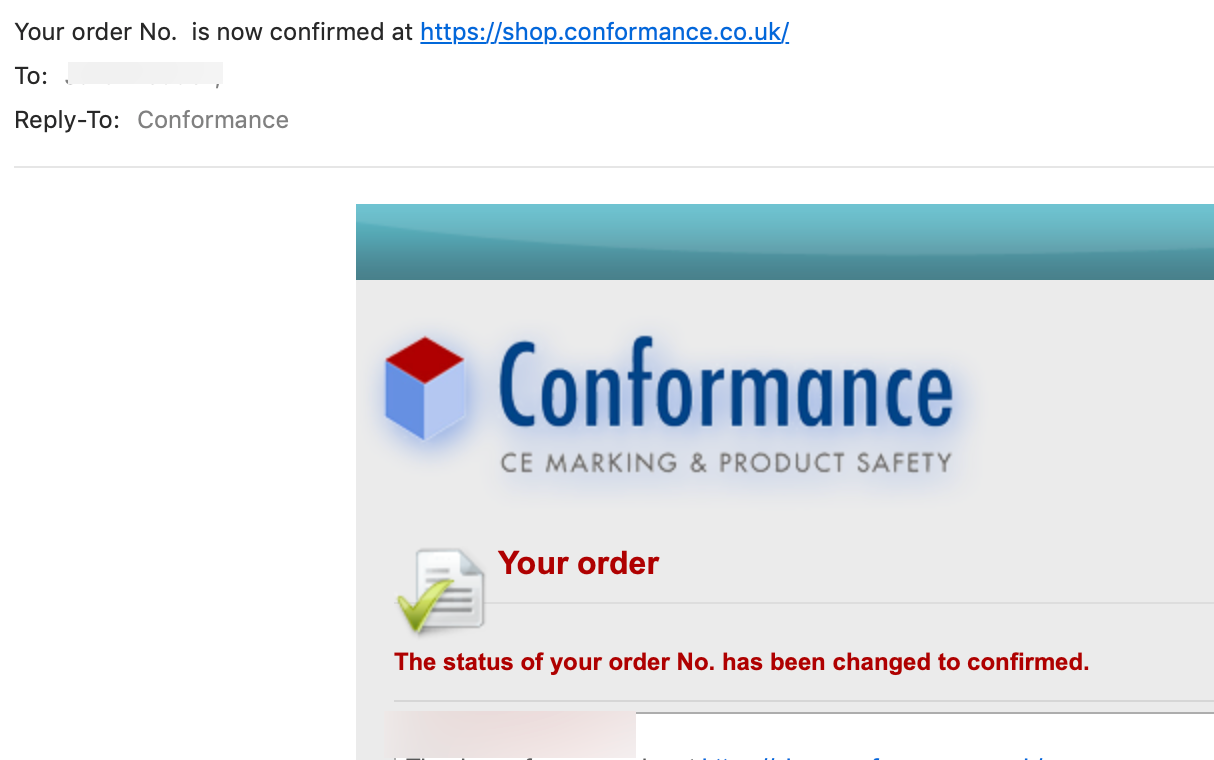

  • Posts: 82
7 years 4 months ago #306062
I have now upgraded hikashop on the live version of the site. A problem has been spotted.
The problem is with emails.
The order number is not appearing in the places where it should appear. This was working before the upgrade.
I took a look in the languages and found the various lines, which set the email content.
For example for "subject" it looks like this: ORDER_STATUS_NOTIFICATION_SUBJECT="Your order No. %s is now %s at %s"
I'm not sure how %s is determined, but the %s for order number is not being returned.
I am sending a screenshot to show you the resulting email.
Any help always appreciated.
Duncan
PS apologies if you have more than one screenshot, I tried to send an edited version of the screenshot and delete the first one, but the "remove file " functionality for attachments doesn't work very well.
DunxMax
Last edit: 7 years 4 months ago by dunxmax.
  • Posts: 86112
7 years 4 months ago #306104
The %s in the translation
ORDER_STATUS_CHANGED_TO="The status of your order No. %s has been changed to %s."
of your screenshot is generated in the preload of the order status notification email. You can see it in the menu System>Emails at the bottom when you edit that email:
monosnap.com/file/4c4aNxcF2O0R8ZpSxHr1xU6s1ubnhf
However, I don't see how the order number would be missing there and all the rest of the information present. At least not with the code of the preload of recent versions of HikaShop. So either you have modified the preload in some weird way or you have a really old preload override (you can check whether you have an override or not on the listing of the emails) which has a bug preventing it from displaying the order number properly.
