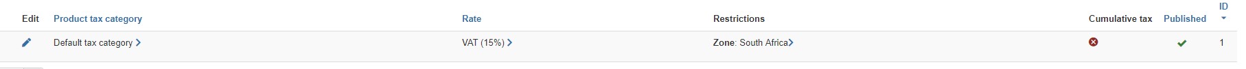

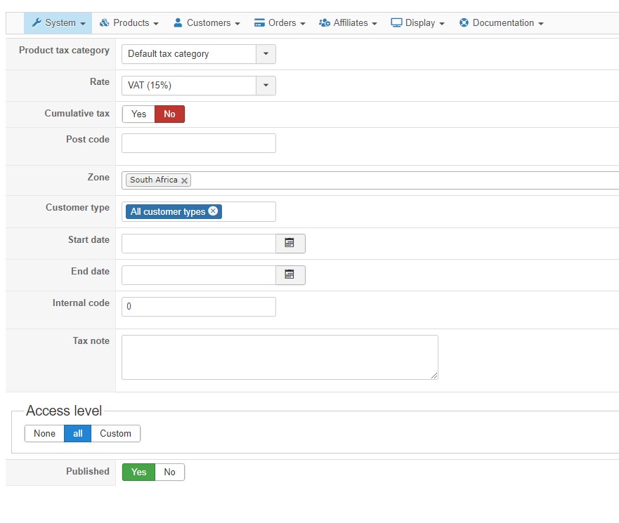

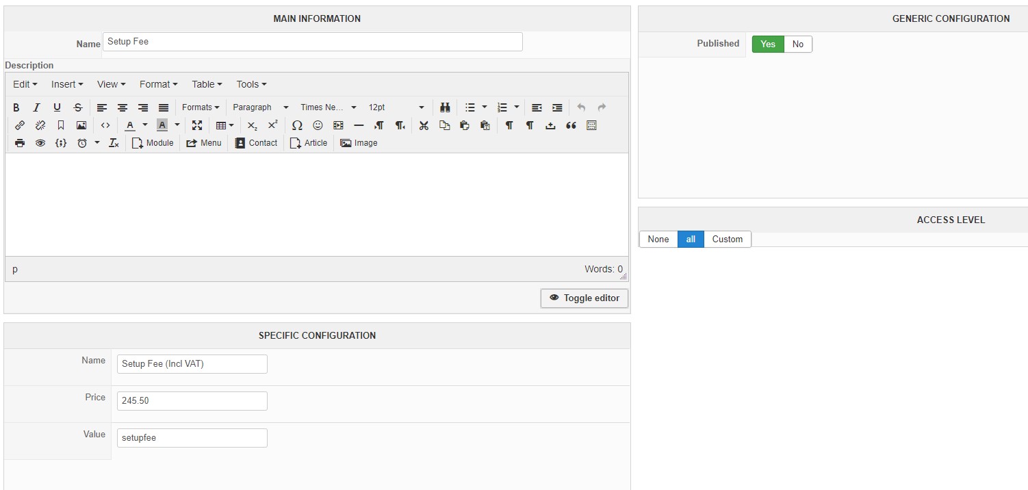

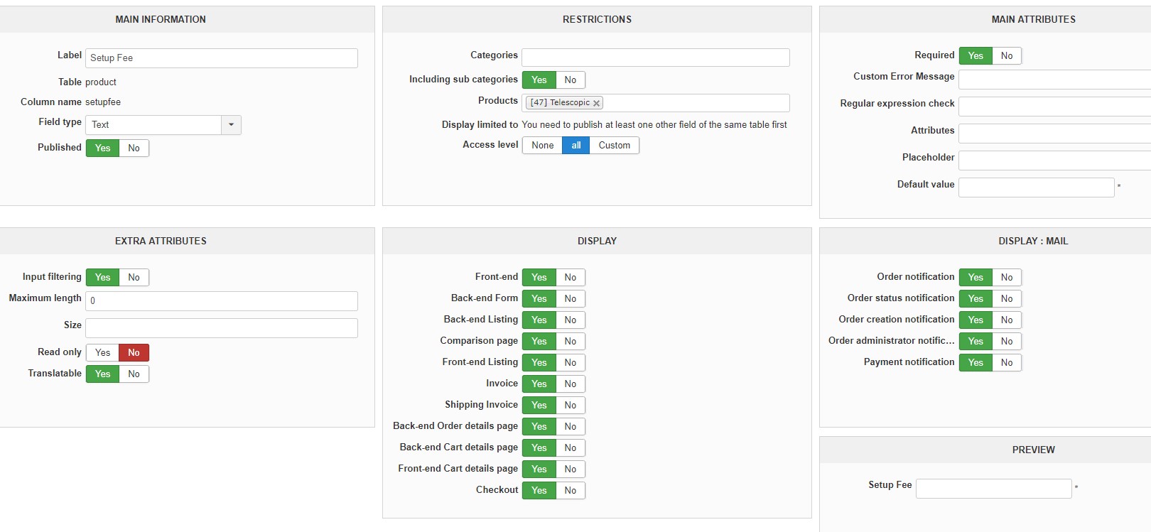

7 years 6 months ago #304022
Please provide a screenshot of the custom field settings, a screenshot of the settings of the plugin and a screenshot of the settings in the taxes area of the HikaShop configuration so that we can get a better understanding of the situation.
  • Posts: 15
7 years 6 months ago #304034
Hi Nicolas
Here are the screenshots. Thanks

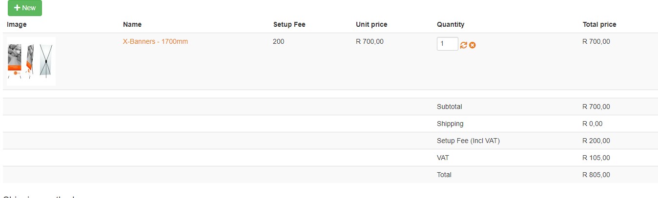

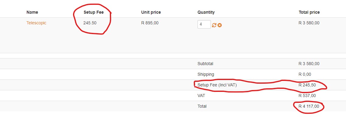

  • Posts: 15
7 years 6 months ago #304157
Hi Nicolas
Thank you for your assistance with this. I have added it to the same product you used and I once again have the same problem. See attached.
Also, in your example it is not adding the Vat on that line item to the Vat total?
  • Posts: 86112
  • Thank you received: 14210
7 years 6 months ago #304168
The global cart fee allows you to add a fee but there is no option in it to modify the VAT to take into account that fee.
If you want to do that, you would have to modify the code of the plugin to support it.
As I'm not able to reproduce the problem and you are, it means that we're doing something different when testing.
Please provide PRECISE step by step instructions to reproduce the problem and please try with the same user account you provided us so that we're sure we're in the same conditions.
